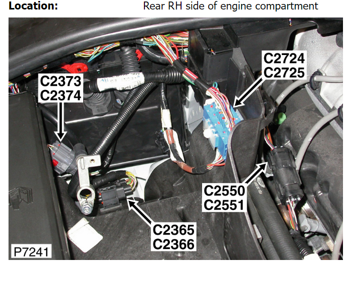

The only things that are common for both rear O2 sensor heating are the ECM, connector C2374, and fuse 11E in the engine compartment fuse box. It is a 15A fuse. I would check that and see if it is blown. It is possible one of the original O2s you replaced had a heating element that went bad and shorted, blowing the fuse. If that is fine and has 12V on it when the engine is first started cold then I would check the wiring starting with C2374 which is shown below
