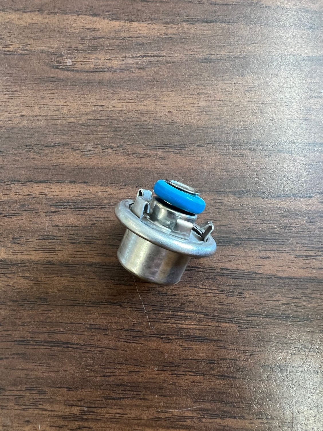

I have fixed this problem on my 2006 LR3. My LR3 was also leaking fuel on a cold start. The problem was the o-ring was leaking. I removed the part from the fuel rail by prying the 4 tabs with a small flathead screw driver. A picture of the part as removed is below. Then I got the blue o-ring sized. It was Parker part number 2-203. I could only get a black o-ring, but used it anyways successfully. First I installed the new o-ring onto the fuel accumulator and re-installed into the fuel rail. This didn't work, it leaked worse then before. Then I added a 2nd smaller OD o-ring under the proper sized o-ring. This pushed the proper o-ring up against the flaired end of the accumulator. This time when I re-installed it, no leaks. Be sure all 4 tabs are well hooked on the fuel rail. Again, I just used a small flathead screwdriver on the tabs. You can rotate the accumulator when installed in the fuel rail to make sure all 4 tabs are properly hooked.
The only cost is a new o-ring. Once you have the o-ring and the engine cover off, this repair takes under 15 minutes. Unfortunately I didn't take a picture of the double o-ring scheme before I installed it.

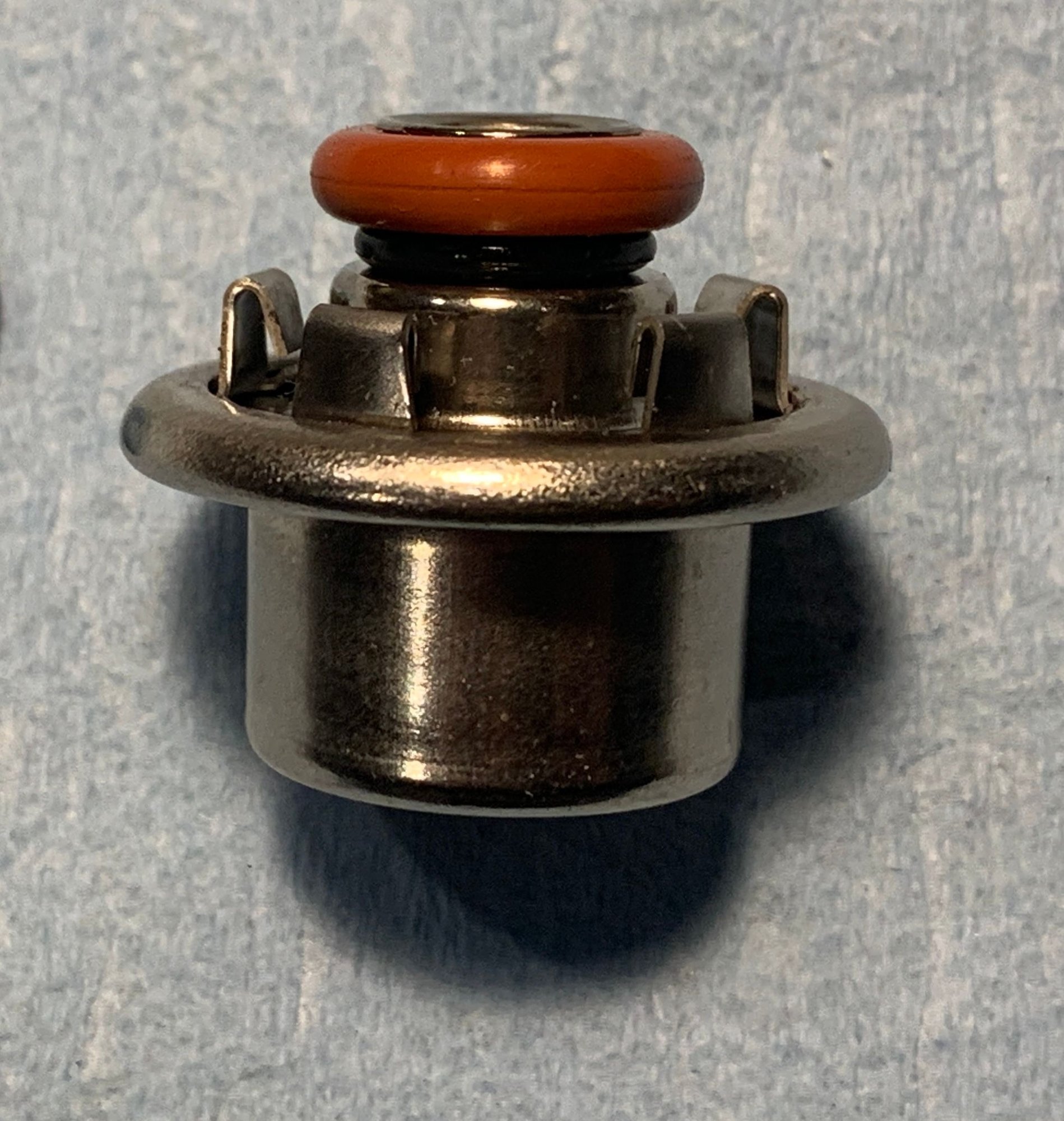

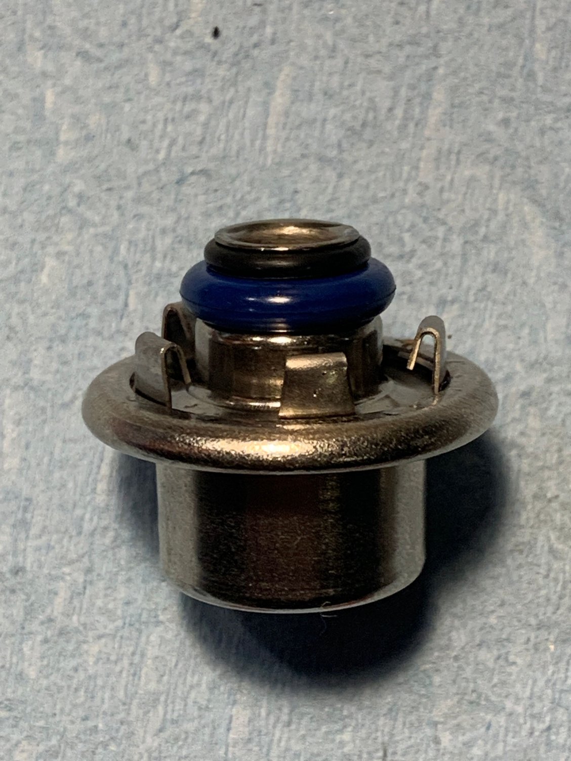

Can you tell me what you mean exactly with the "flared end" of the damper [accumulator]? Which arrangement did you settle on? (Orange or Blue?)
Upper Flare
Lower Flare

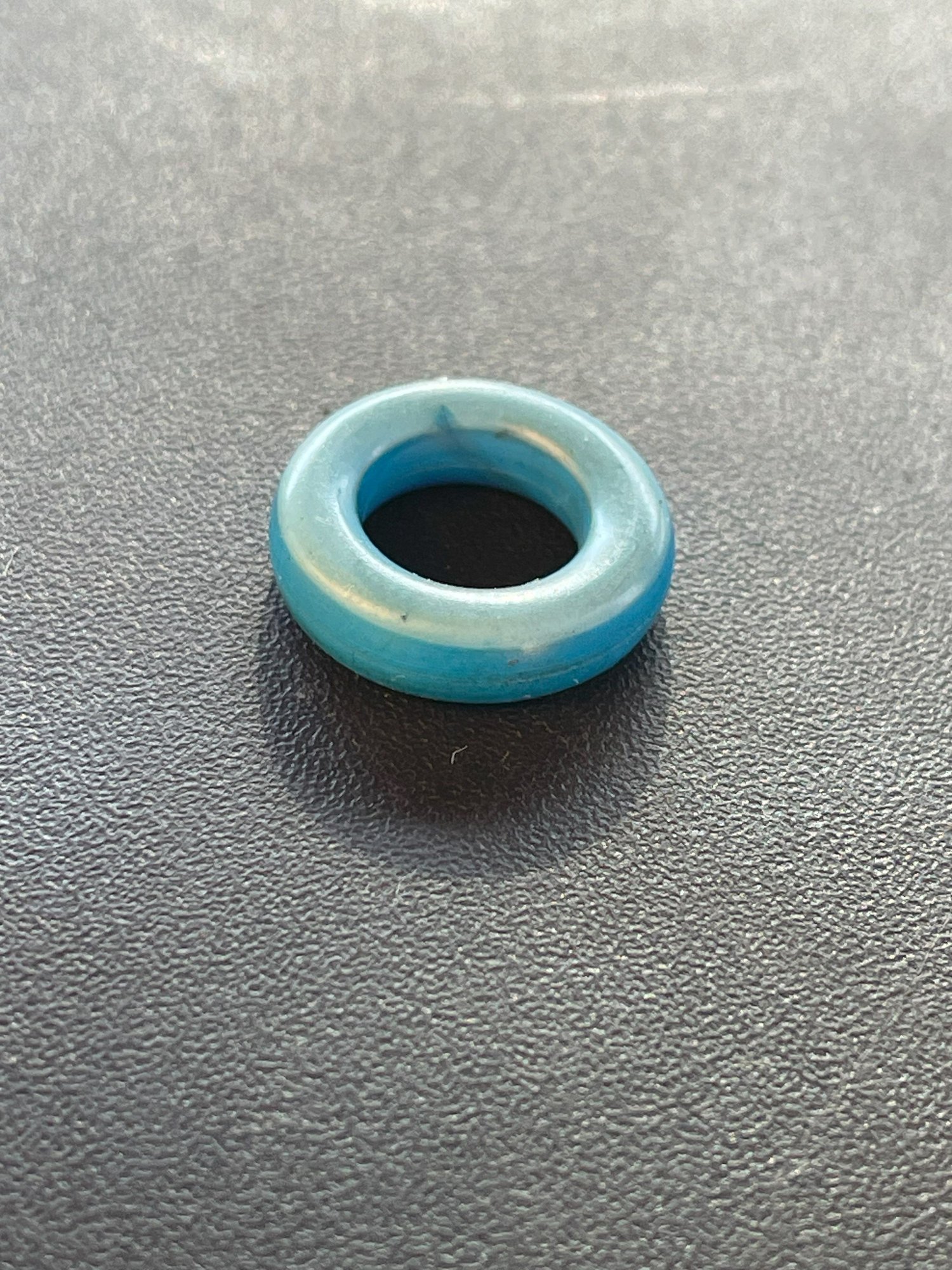

So, this might be an already very old thread, but wanted to add a couple of comments to this problem. On cold starts (Colorado cold!) the pressure fuel accumulator/dampener of our LR3 does leak. The leakage will progressively be less and less till it stops as the engine warms up. I did the fix suggested here, it did reduce the problem, but does not eliminate it permanently. The stack is, looking at the accumulator in the orientation as is goes into the fuel rail, Parker V1163-75 dash number 203 top and Parker V1163-75 dash number 011 under. (Parker grades V1263-75, more common should also work especially if the temperatures in your area don't go very low).
This being said, what would be the really permanent solution to this problem? The original BLUE o-rings used by Land Rover are not very compatible with our ethanol oxygenated gasoline. (See image attached). The Ford pressure dampener Part number 2W93-9F775-AA, injector planet) seems to come with a single (maybe Viton) o-ring. Is the ultimate solution to machine a dampener from SS and plug the port as described in the Jags forum?
Ideas will be most welcome!!
