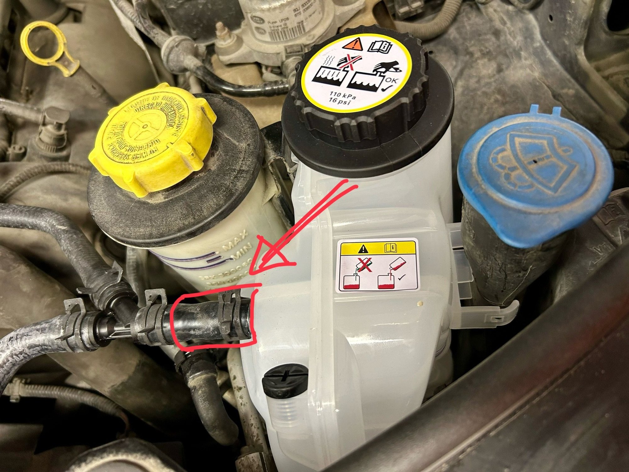

If the question was for me, the Gates part did not fail. The clamps were too small to apply properly over the hose to lock it in place.
The old hose was LR original. I have highlighted the fracture area in the picture below. The fractures in the rubber were visible to the naked eye. Note that the picture is of the new hose and bottle.
I don’t have a picture of the EGR and radiator ends. On the radiator end it was more like a crack or split on the underside (not visible normally) of the hose.

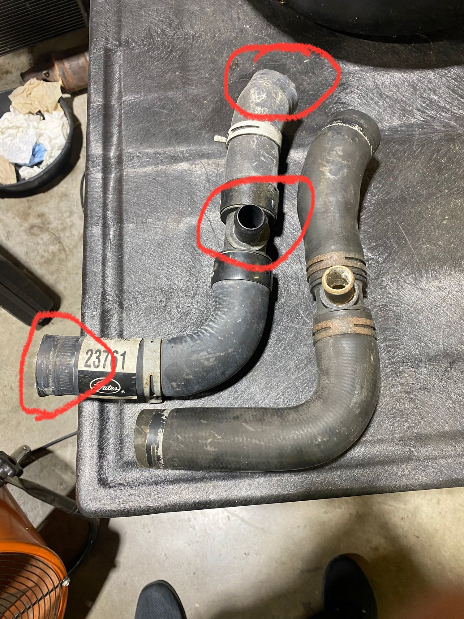

I had to trim length off of each end of the Gates upper radiator hose. It is too long and gets squished against the front valve cover. The heater hose tee is about 2mm larger in diameter making it hard to fit. The Gates lower radiator hose is ok. The upper sucks! Rein’s 2008 BMW 335i molded plastic elbow in the radiator hose had a pin hole in the plastic. It should have failed a basic quality pressure test at the factory. I found out about the leak after replacing and re-filling.
