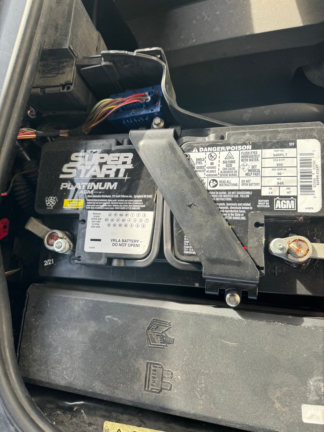

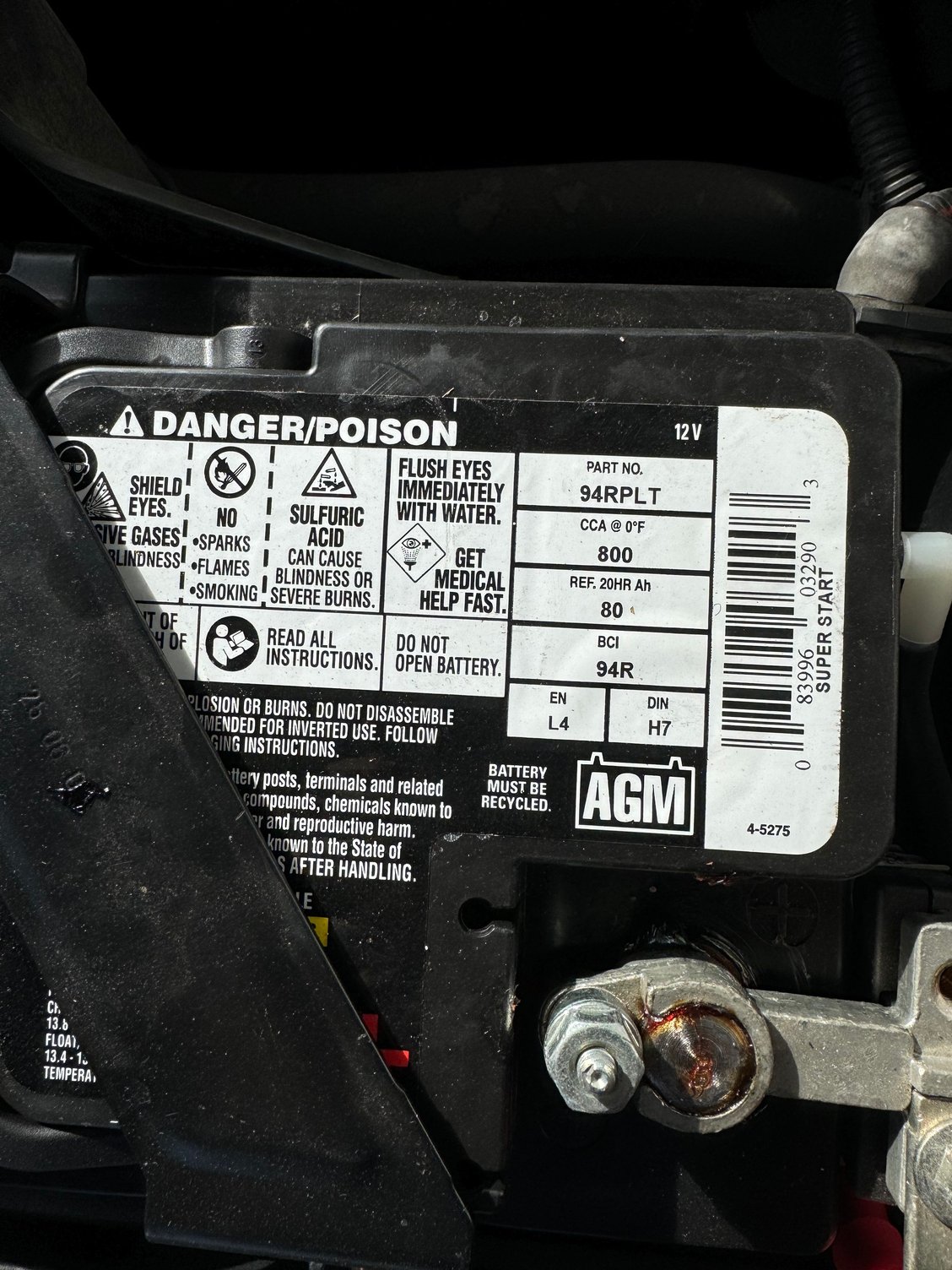

Originally Posted by Blackngold77
Feels like a dying battery getting drained by the cold.
What's the CCA rating on the battery? You want at least 800
I tested my battery with my multi meter it’s reading a little above 12 with the engine off and accessories off. With the engine on it’s around 14.6. I’ll have to check CCA rating.
Its rated at 800
It was around 30 degrees here this morning. Again had to turn the key off and on the ignition at least 5 times to get my vehicle started.
I’d say around the 4th key turn over, I could hear the engine sputter. Then on the 5th try it started right up.

What the heck is that crap on the battery contacts? Also we need better number, a little above 12 is not exact enough. Because a battery at standby - which is well after a vehicle is running - should be 12.4 to 12.6. Its amazing what a little less can do to cause issues. Also worried about sputter... that concerns me, can you clarify? Sputter to me means the engine did fire off but somehow stalled.
Maybe your next test to do when it is not starting when cold is a jump from another battery or vehicle to see what happens. A jumper pack would be nice to have.
