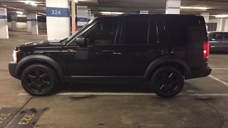

Hey DavC I did these myself. I used 4 cans of plastidip and sprayed them with the wheels on the truck. You just need to clean the rims real good, water soap, alcohol. Cover your disc brakes with garbage bags by pulling the bag through your spokes. I would also cover the tires. I didn't and sprayed heavy coats of plastidip around the rims edge and tires and wasn't able to peel off the excess like they show in the videos. Also the secret is light coats and don't forget to rotate the tires after 3 coats. I sprayed each wheel about 5 times.

That turned out great! Looks awesome! I was thinking of doing the same thing, but also try to add a ring of red around the lip of the rim to contrast the black of the LR3. I don't have a contrasting car color like you.

Thanks! Thinking about getting to work on mine this weekend. I've been planning it for a while, just haven't quite got around to it.

I am extremely happy with the results. Thanks for the input MX468! The armor-all on the tires saved loads of time. It peeled off extremely easy. (video
) I also made sure to lay it on thick around the tire sidewall (just to make sure).
I will say I spent way too much time on prep work-- just because I'm OCD and I would have hated myself if I had to start over because of a silly mistake. Unfortunately, I became extremely impatient on the 4th or 5th coat, which caused SLIGHT overspray and drip on one of the driver side spokes. I asked a buddy if he noticed anything and of course only I noticed-- but still. STAY PATIENT, it will turn out fine. Just don't rush.
I sprayed it this morning with Armor-all Extreme Wheel & Tire Shine and cleaned off any brake dust that may have dried on overnight with the dip. I still have a can left that I will use for touch ups. I noticed around my 6 spokes, the lip is very sharp and due to the plastidip drying and shrinking overnight, I need to touch up the corners. Again, only I noticed (haha) thanks again LRForum!!
