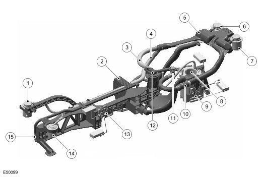

There roll sensors in the fuel tank that shuts of the fuel

Don't have schematics but as shown in the manual
A tank carrier assembly is attached inside the tank and is used to locate the internal tank components. The carrier
provides location for the fuel pump module, the front level sensor, the Roll Over Valves (ROV's), the front jet pump and
the Fuel Level Vent Valve (FLVV).
The two rear ROVs are mounted directly onto the LVS with a rubber grommet and secured with clips.
The two front ROVs are located in the front of the tank and are attached to the main beam of the carrier by a moulded
clip. Both ROVs are connected to the LVS with a plastic corrugated tube.
The four ROVs vent directly into the LVS. Any liquid fuel is separated from the vapor in the LVS and drains back into the
Item Part Number Description
1 - Front right hand Roll Over Valve (ROV)
2 - Carrier assembly
3 - Fuel Level Vent Valve (FLVV) breather corrugated tube
4 - Front ROV corrugated tube
5 - Liquid Vapor Separator (LVS)
6 - Rear right hand ROV
7 - Rear left hand ROV
8 - Fuel pump module
9 - Rear fuel level sensor
10 - Tank breather tube
11 - Connector
12 - Fuel Level Vent Valve (FLVV)
13 - Front fuel level sensor
14 - Front left hand ROV
15 - Front jet pump
Hope this helps

Thanks, I will look further into that but so far all info points to these not being an issue since these pretty much just prevent fuel from escaping into the vapor system, they dont close up the fuel supply apparently.
