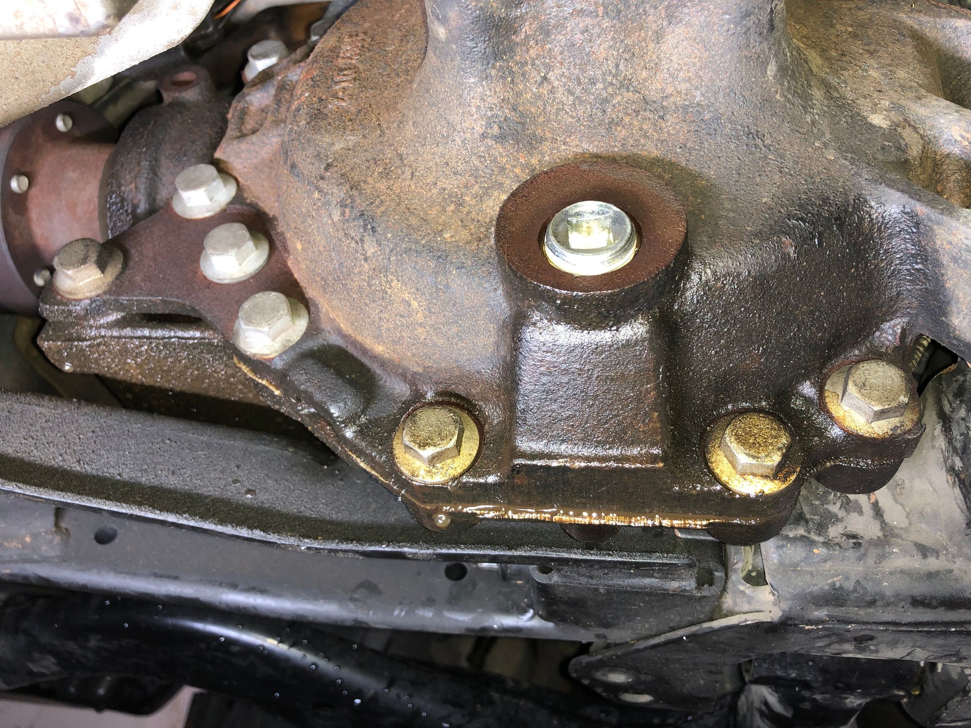

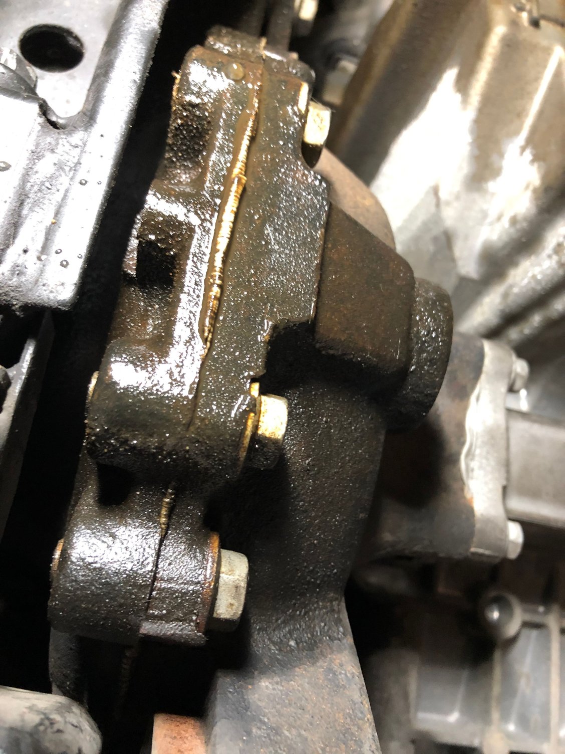

See photos below. I cleaned off everything after changing fluid, so accumulation is only from the past two weeks. Most noticeable around seal of the diff cover. Didn't notice anything at the pinion/flange. Minor accumulation at LH/driver inner CV joint and at axle tube/passenger side. Had to consider a leak trickling down from somewhere else, but engine and everything else looks dry. Obviously, with a functioning breather, it shouldn't be under pressure. I would still think that a flimsy breather tube would be the weakest link here in terms of pressure if it were to build up. Now it's just a question of leave as-is and monitor fluid level, have diff shop attempt to rebuild w/ seal/bearing kit (assuming 6-8 hrs of shop time total), or look into new or used unit.
Note: I've been driving around with skid plate off past week to monitor leaks on garage floor/cardboard. It's definitely slowed to only a drop or two per day. Should have taken photos before recent rain, so that's some of what you're seeing.

I would look for a hole or something like a crack in that boot. On the diff filler you could put some Teflon tape on the thread and re-tighten it. No oil should come out if only the required amount was put in

As for the front diff, most of what I have read is: if you keep oil in them they will continue to run, just run loudly. at some point you will hate the noise and get it fixed. Not saying it won't lock, just saying it is not likely. Remember these diffs (front and back) were first built by Dana the US truck axle/diff company, so you can expect them to whine for a long time before they die.

Thanks for the feedback guys. I think I've got a good plan of action now. On the diff, had it last replaced in Austin after the noise became unbearable. If they filled to the fill hole, that could explain the leaks. I've got the proper amount of oil in now and no leaks at the plugs, so hoping some of what I'm seeing may have been residual from before I flushed everything.
