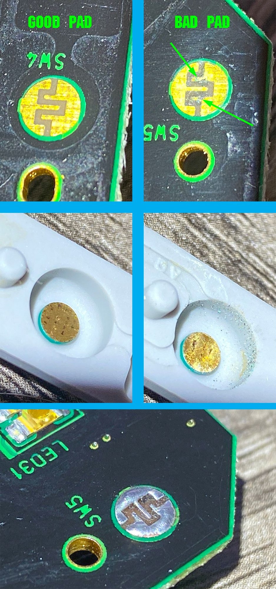

From: Green Bay, WI
This is what I found in my "sealed" switches, corrosion. Had to flow some solder on the bad pad which seems to be hold up well. Your switch contact pad may be corrosion welded onto the PCB pad.

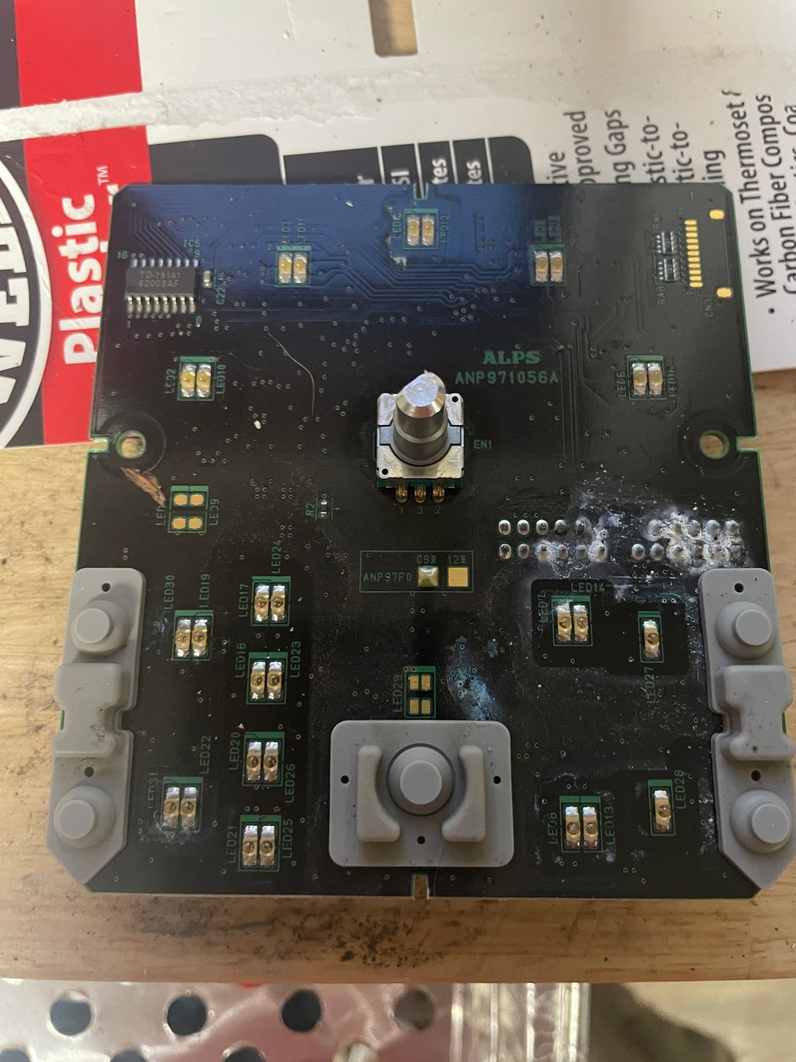

Old Sep 4, 2024 | 08:20 AM
Gnomadf's Avatar
Joined: Jul 2018
Posts: 363
Likes: 90
From: Tip of the Mitt
This was what I found when I opened it up. That much corrosion could definitely cause some wierd issues! I cleaned it with QD electronics cleaner and a toothbrush, and it looks good now. I'm considering touching up the solder on the pins but I don't see any rings around the pins, might leave them be and see how it works and can revisit that if it seems prodent.
My button pads looked OK but a touch of solder like you did might be prudent.

so, good gnus and bad gnus.
After cleaning the switch panel, the rover defaults to normal height.
However, once one invokes off -road height it won't return to normal and wont go to access, a check of the live values in the Gap tool reveal the lower switch is not making contact while the upper one is (thanks for the tip on checking that!) aaaaand I have 4 soldering irons, a soldering gun and a neat little torch for when I really need to get the heat going for ham radio antenna work, but I can't find a single one of the damn things. Even found my solder fer cats sake. Thats a first world problem right there, and I'll figure that out.
At least the HDC button doesn't stick and the other levers move smoothly. There was a ton of crap in there, 16 years worth of coffee and soda and who knows what else.
