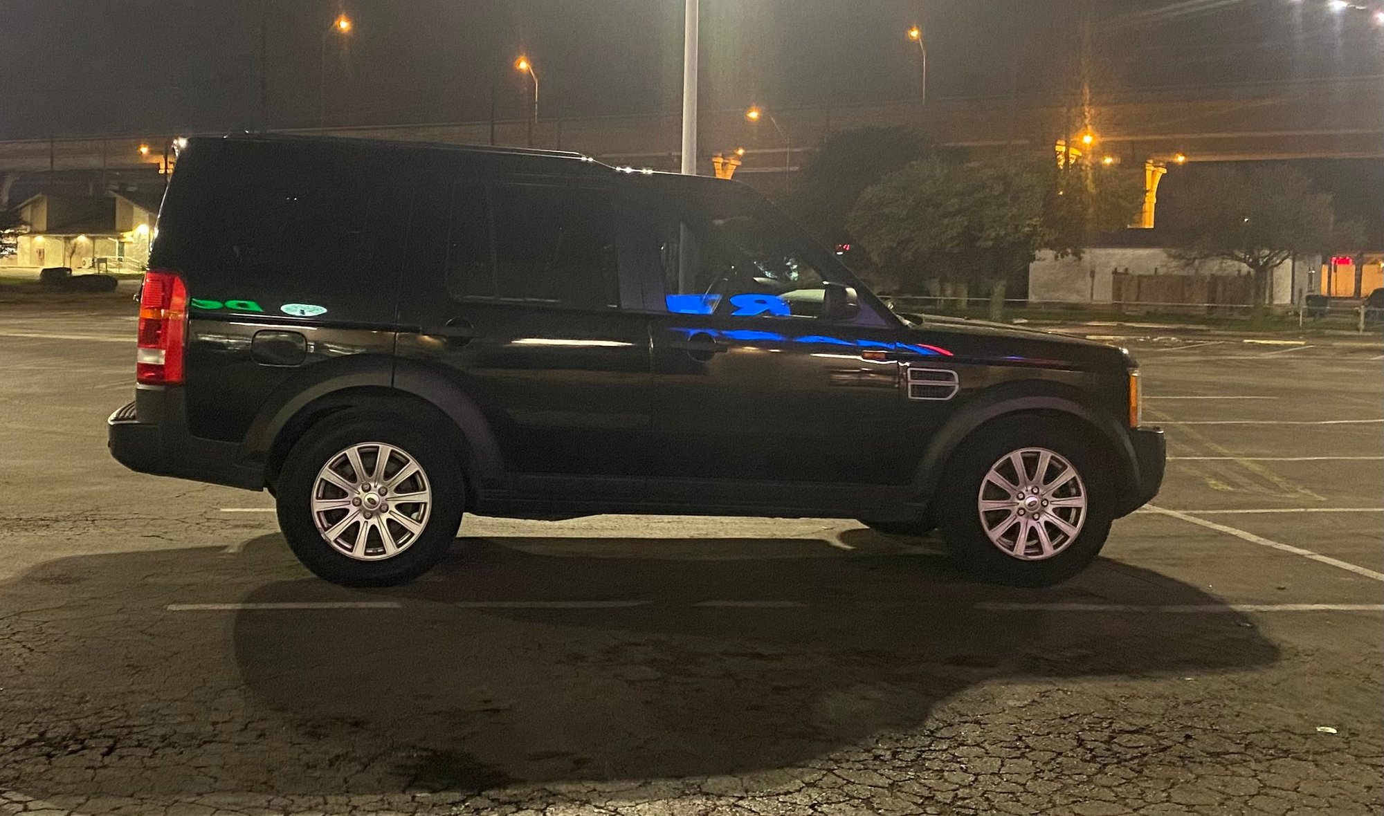

I just replaced the air compressor on my 2008 LR3 and I’m still gettin a suspension fault reading after driving about 20 miles (drives fine but light comes on). My front right is sagging when it is off and parked… just the right though, not both sides. My mechanic says I need to replace both struts.. if only one side is sagging, wouldn’t that mean only one side is failing and therefor both wouldn’t need to be replaced? could it be something other than the struts causing one side to sag
