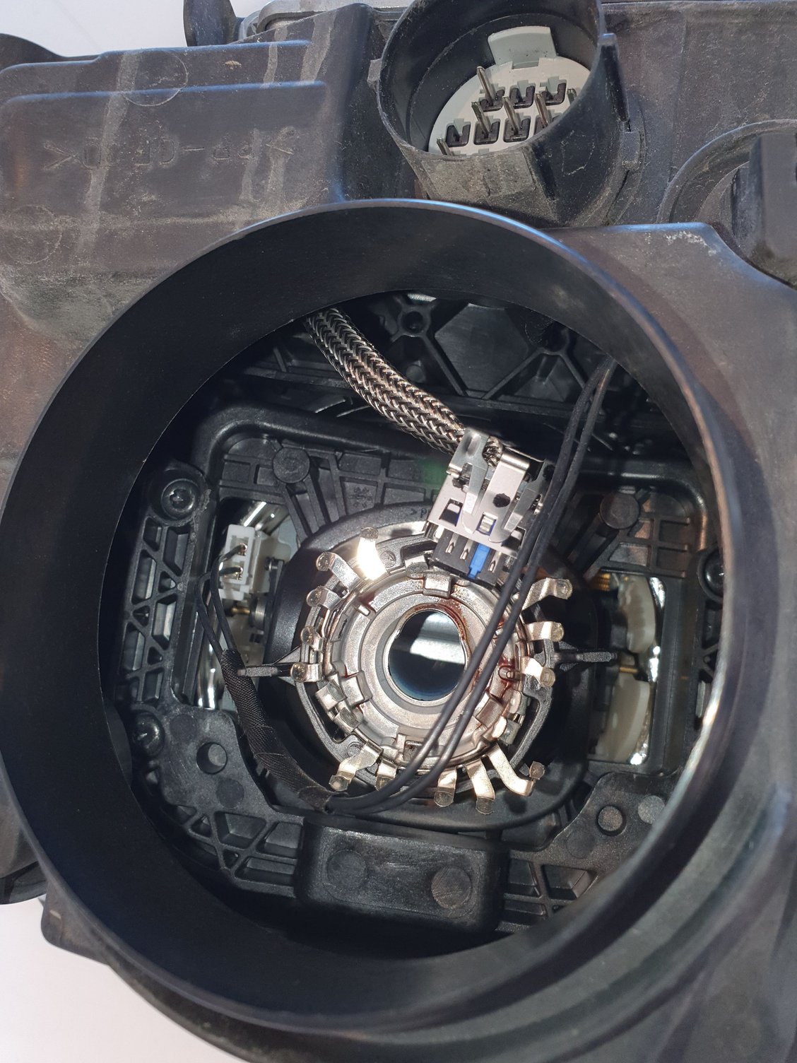

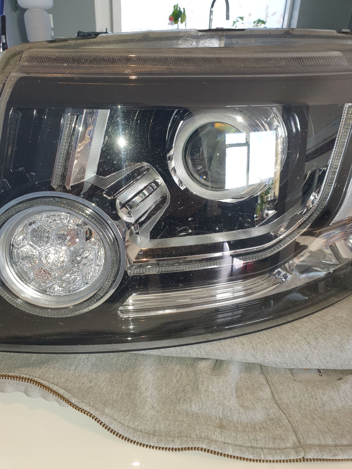

good afternoon. I am new here and wanted to check if anyone here is able to help me. i have been going trough the treads and not found what i am looking for. the issue i have is that I bought my first LR3 (LR4 facelift) last year and as I was taking it to the car inspection place today I was not able to get a full inspection because of the headlights they are RHD. I have been going through all videos about how to change the setting (over to LHD) and noticed that they are for another lights and look nothing like my lights. cant seem to find any info how to change it.
sorry if there is a thread already with the same info.
BTW I live in Iceland
pics of lights

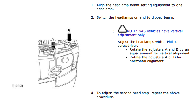

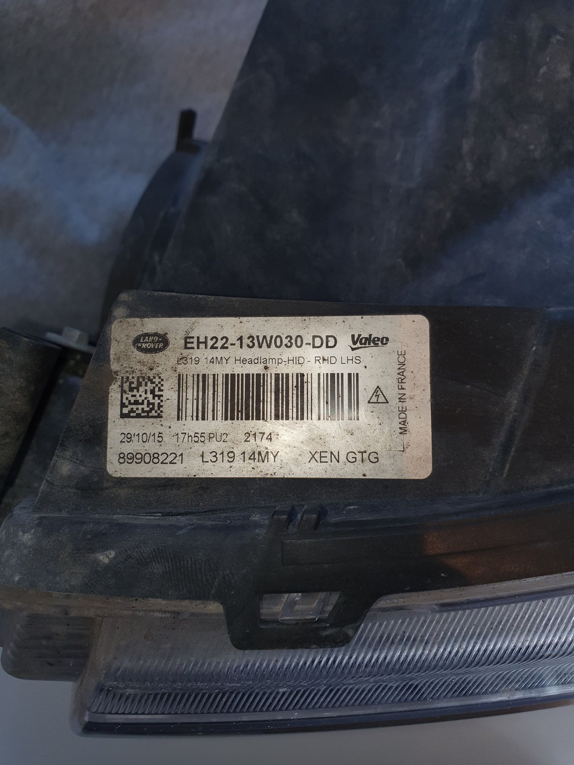

Here is the D4 service manual page 3553. Best I can do for the D4
However, this may not work either. Seems the label says RHD LHS (Right Hand Drive; Left Hand Side), so these things may not be adjustable on the non NAS cars.
Jeff

Did you happen to figure this out? I'm kinda having the same issues only reverse. I have a 2011 LR4 LHD in the states and I'm bringing it back to the UK. I have the Xenon headlights and the interior of the low beam looks the same as your photo. No lever, just a gear that looks electronic that adjusts the dip down until it's flat. Apparently on the models with Auto-highbeam you can change the country settings but not sure if this changes the dip because I don't have that feature. Not sure if the IID tool could adjust but that would be cheaper than new headlights I would think. If I had the newer Discovery 4 Conversion done I would swap with you but that would be too simple. Let me know what you find out!
