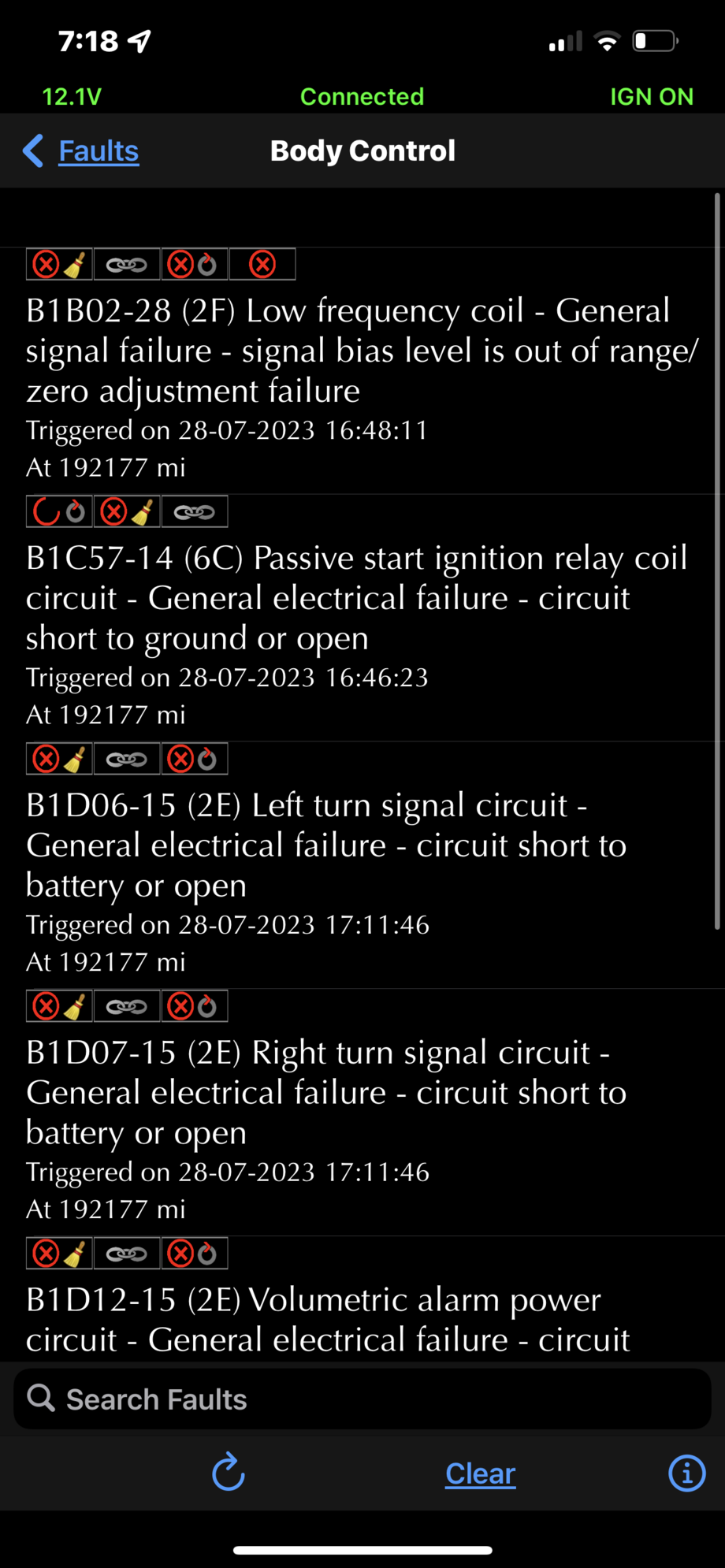

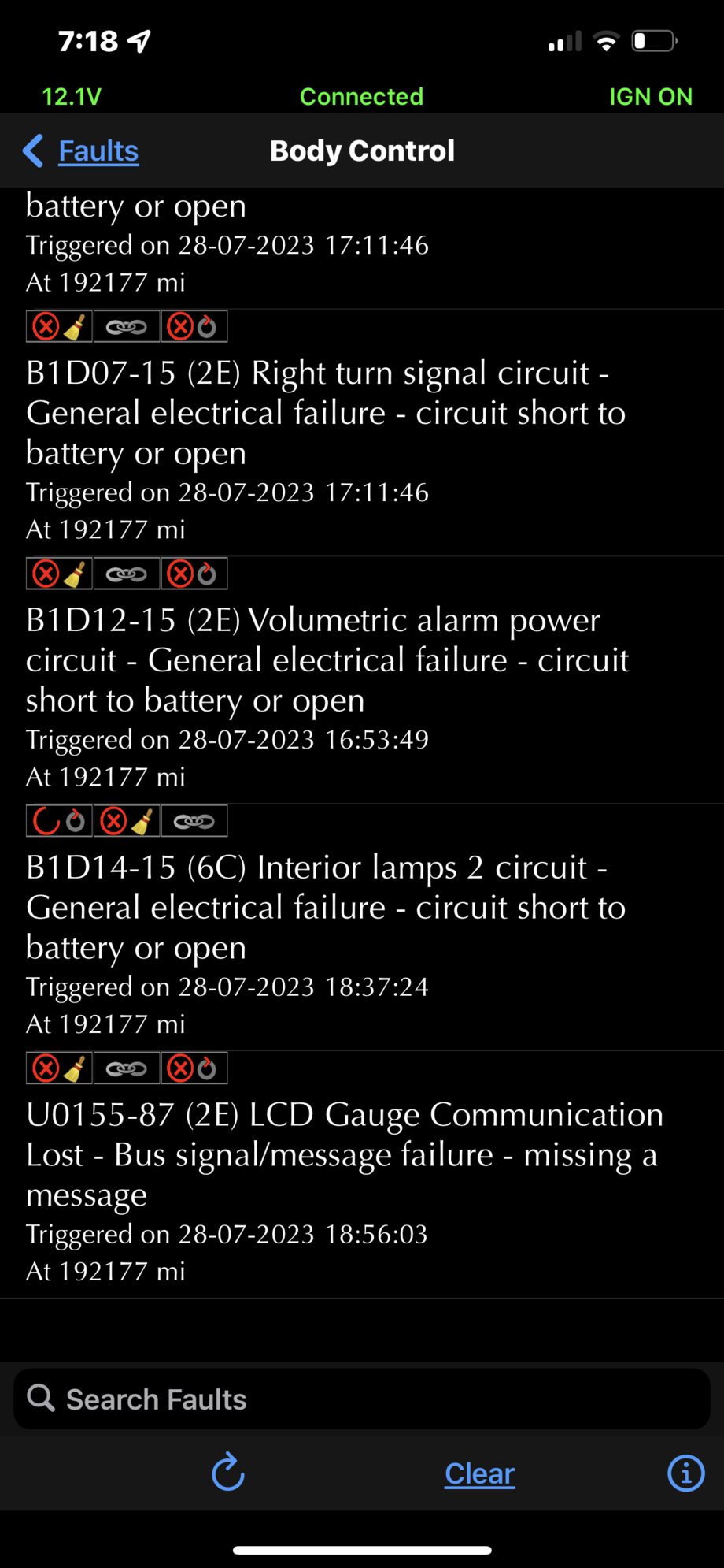

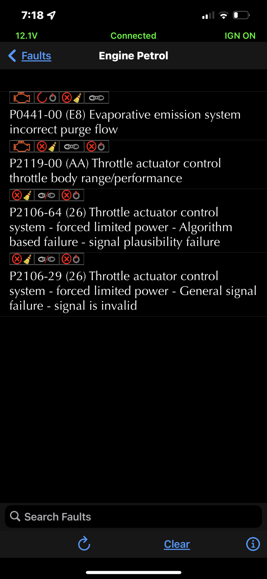

It’s not the only code,
This is what I just received..

Damn.... um, not even sure where to start. Clear ALL codes, make sure those are all fresh. Unless you did already? (I bet you did). I have seen train wrecks with less issues. You either have a system wide power/ground issue, a loose CJB connector, or some major corrosion issues in the engine bay on the ECU. So in short, I would guess you have more than a speed sensor issue.

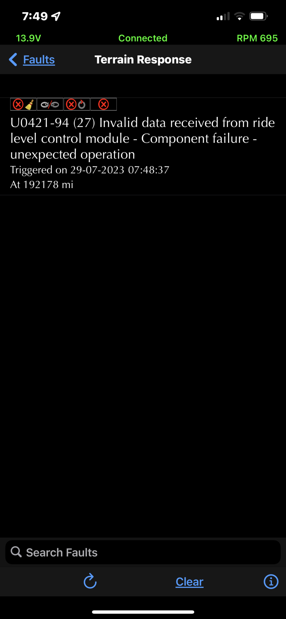

These are after clearing & before p0501 pops up again!

Nothing dramatic there. The B1C57 sounds scary, but normally it is not a huge issue. Obviously lamp issue is not big deal. A bit worried about the ride level issue, that may be a real issue but again that can come up for no real reason. Another "ghost code", codes that LR3s love to generate for not real reason.
I would drive it while reading the live valves of all four wheel sensors. At this moment, those do seem to be the issue, well one of them at least.
