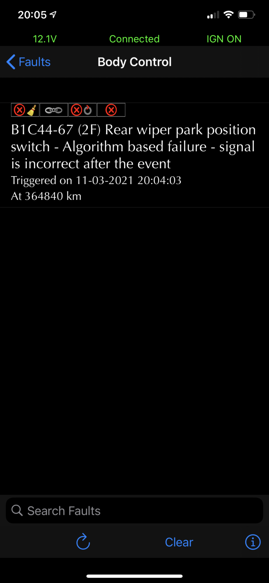

However, I am still having the issue where when I turn on the wiper it wipes for 3-4 wipes and the stops at a random position. It I turn it off and back on again it does the same thing ending up in a completely different position. The fault that the IIDtool show is in the screen shot below. I don’t know exactly what that means other than the wiper is not ‘parking’ correctly. And I already knew that. ;-)

I had the same problem and failure code. I replaced the motor assembly with a used one I was able to test in situ on the donor LR3. Cleared the code after installation and it's working fine. I read somewhere the internal plastic gears wear or break and allows the wiper to go out of time... hence the park position failure.
