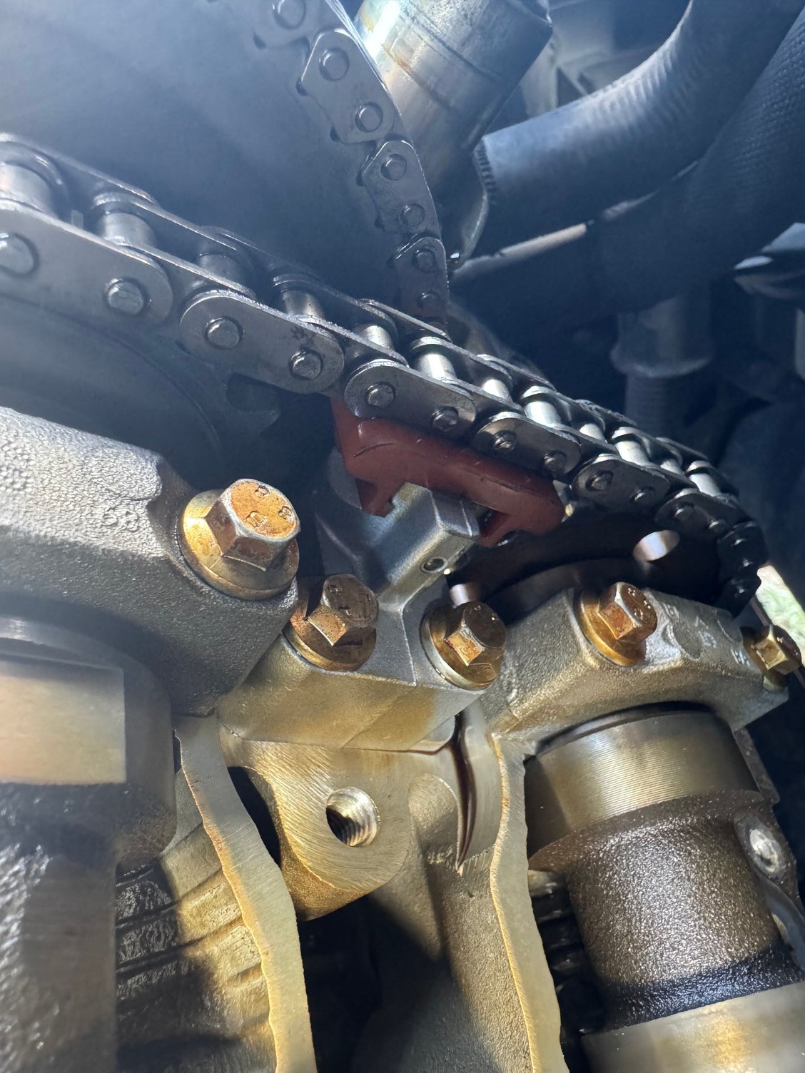

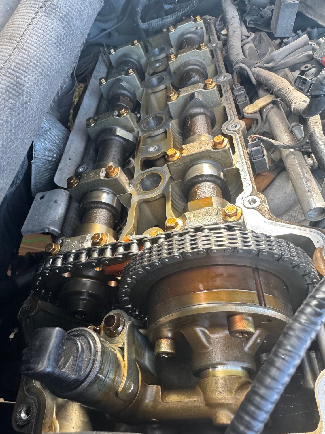

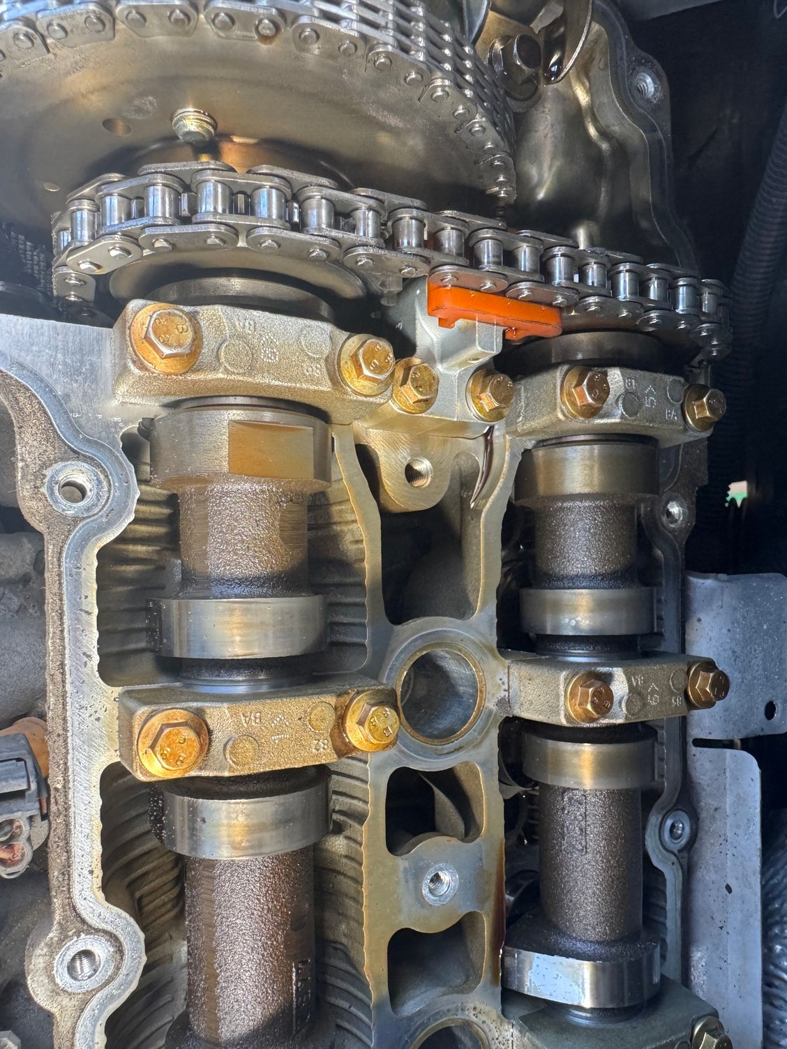

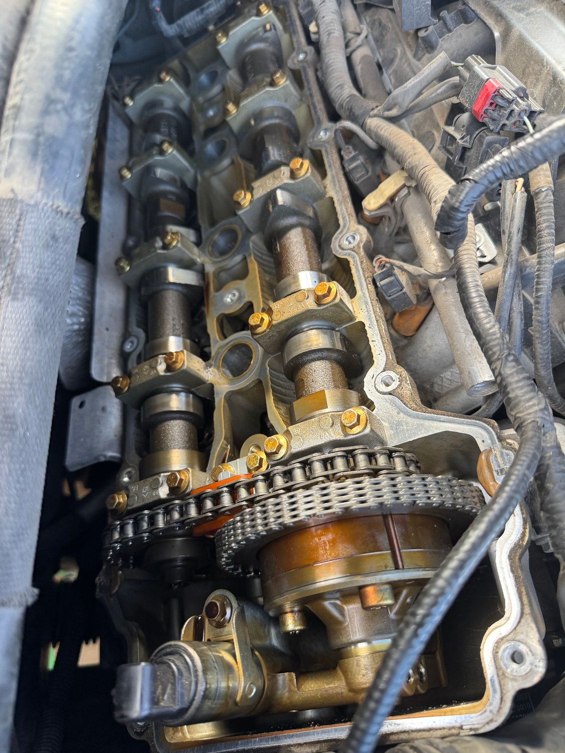

Hey thanks so much for replying! Ok so there was a rattle from what sounded like the timing chains and then 100 miles later engine turned off at stop light idle (in -1 deg f temperature) would not restart, started to sound kind of wheezy when cranking, excessive cranking killed battery. Brought it to mechanic they didn’t really look at it and said it was bricked. There was no good explanation though. Yeah so rather than waste a whole truck, which ran awesome before this issue - I really want to diagnose what the heck is going on…. Ok so anyway, I got the valve cover off - not sure what to look for -the timing chains look and feel really tight - no obvious place where rattle could be coming from - my rattle wasn’t just a cold start rattle btw - it continued while driving even when warm. No obvious damage that I can see - any tips/ next steps on diagnosing? Oh yeah, also I’m noticing that the two cams one has a flat machined in it and the other one isn’t aligned with it - is that a thing? I’ve attached photos

Can you rotate the engine by hand at the crankshaft pulley? If so, align the crankshaft sensor hole as described in post #19. If all 4 cam flats aren’t aligned, roll another full revolution. That should put the motor at top dead center and all 4 cam flats should be aligned.
If they aren’t, I’m not sure if these are interference engines when they jump time.
Did you happen to pull codes when it quit on you?

Thanks Pbod! I understand. So you’re saying if all is aligned as described then we’re good from a timing perspective. I will do this tomorrow am - should be easy if I don’t need to go find a wrench to crank the motor. - yes, AJ41 4.4V8 is an interference engine. I pulled codes when it first stalled and there were 28 different items. Camshaft pos sensor was one. mechanic cleared prior to failed restart attempt

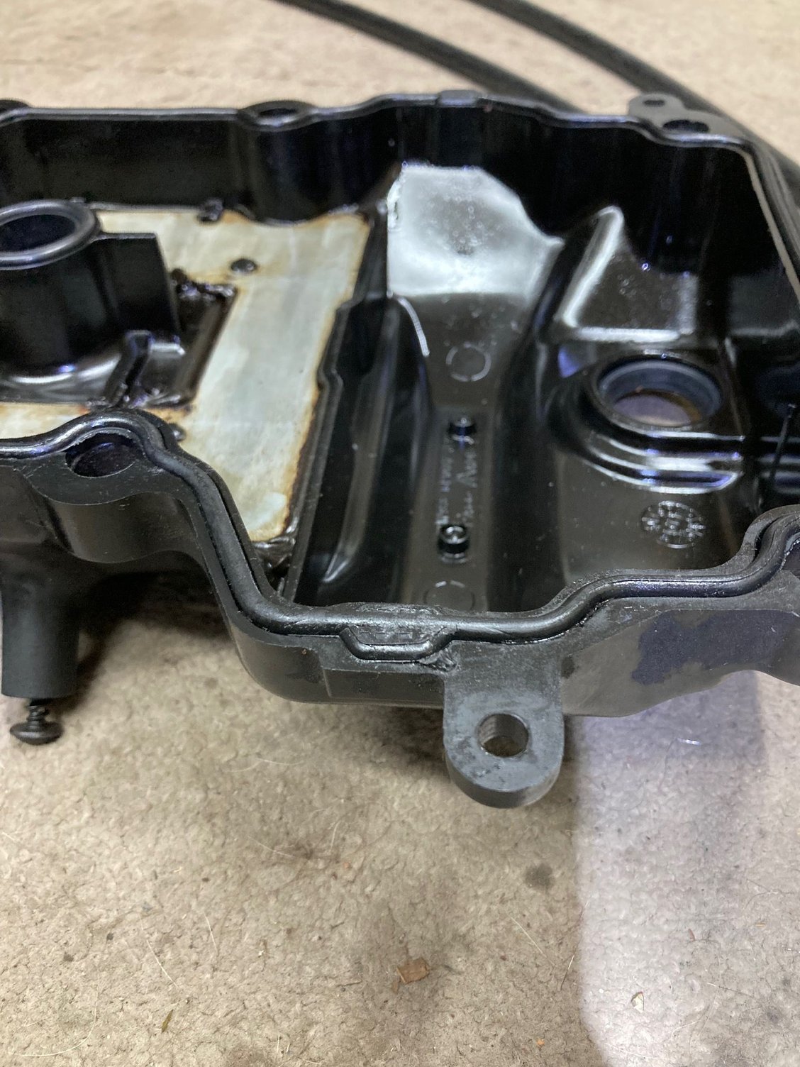

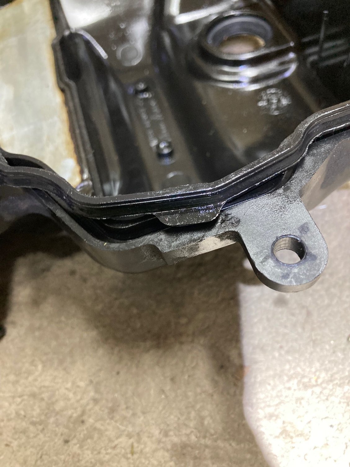

Related topic: Ive done the timing on my 4.4L and followed this thread closely (thanks for all the great information). However, I'm getting terrible leaks from my valve covers with brand new land rover gaskets. Maybe I am putting them on upside down? Which picture is the correct orientation of the gasket (picture#1 or picture #2)? Repair 101 mistake, forgot to take a picture of the original before removing.....
Picture 1, gasket fits very easily in the valve cover channel.  This is how I installed it but getting leaks
Picture 2:  Very snug fit in the channel, but doesn't seem like this one is correct.

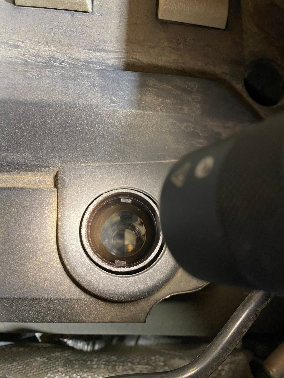

Originally Posted by P-Bod
Without removing a valve cover, the only easy thing I can think of is looking down the oil filler hole with a good flashlight while somebody cranks the engine. You can see a small part of the camshaft though the filler. If it doesn’t rotate while cranking, you definitely have a timing problem.
Here’s a picture. It’s hard to make out the cam, but you can see part of a lobe and part of the shaft.
I hope it didn’t grenade on you!

Pic 1 is correct. Did you put the drops of rtv sealant where the timing cover mates with the heads? Two spots on each valve cover. There are also some spots on the timing cover gaskets that require rtv.
