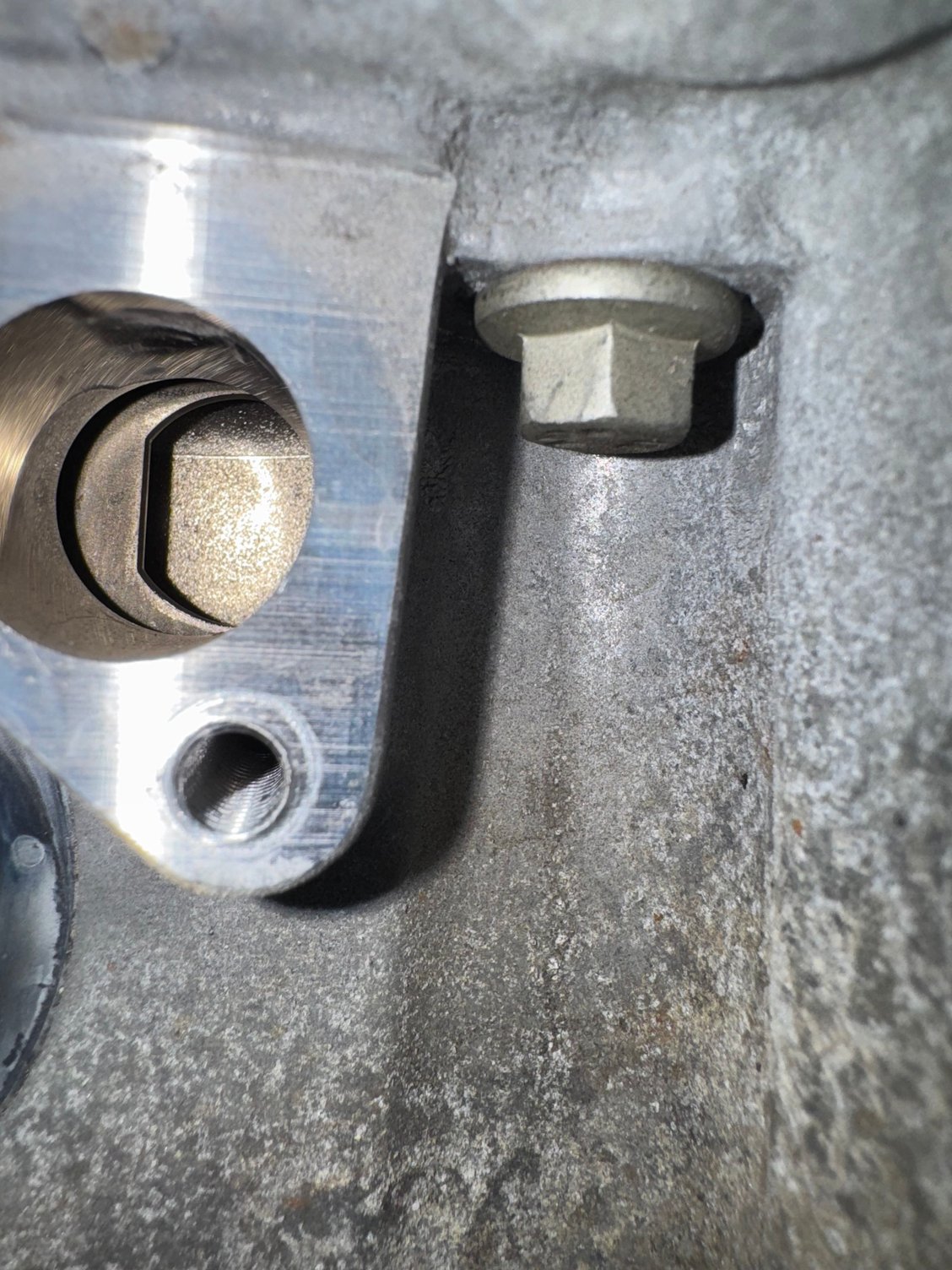

Hey everybody, I finally got a photo of the crankshaft position - attached. The lens was at an angle so keep that in mind but it looks pretty darn timed, no?
if so, now what? I guess the VVT sprocket? Please advise.
This is as close to straight on as I could get, does it look good?
Originally Posted by enovak
Facing the motor, it rotates clockwise. So you were turning it the wrong direction. I would try it again for a couple of revolutions and insure all good. My engine was in time, but I was getting the cold start rattle from my RH bank. My VVT sprocket was broken and not holding oil pressure.

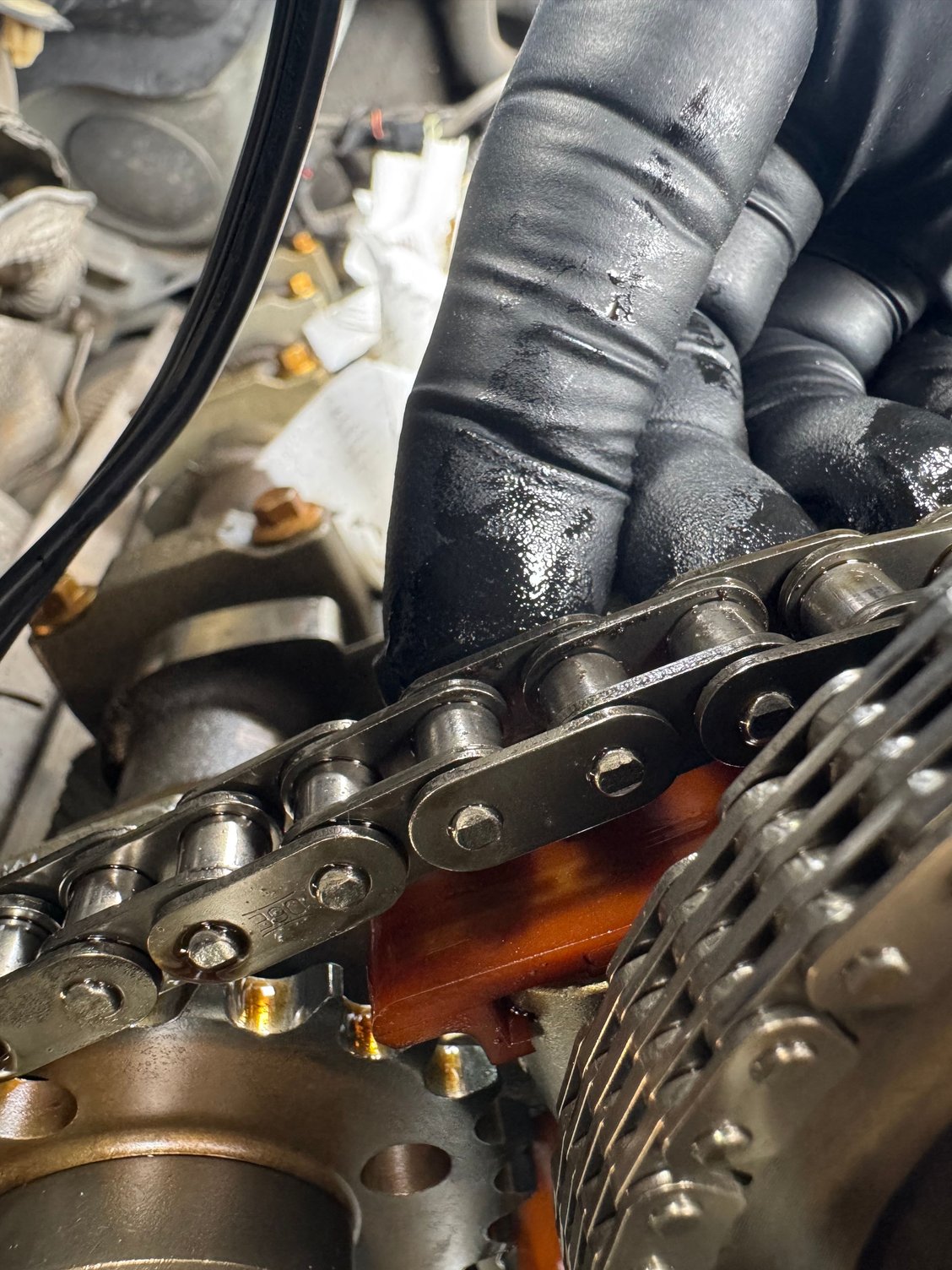

Are these chain tensioners always meant to be tensioning? Even when the vehicle has not been running for a month?
I thought that was weird at first, too, on that secondary chain. When you rotate the motor, it will tighten and loosen through the rotation, presumably due the the intake and exhaust cam lobes opposing each other. I concluded, correctly or not, that oil pressure while running maintains consistent tightness while running. Post #42..
