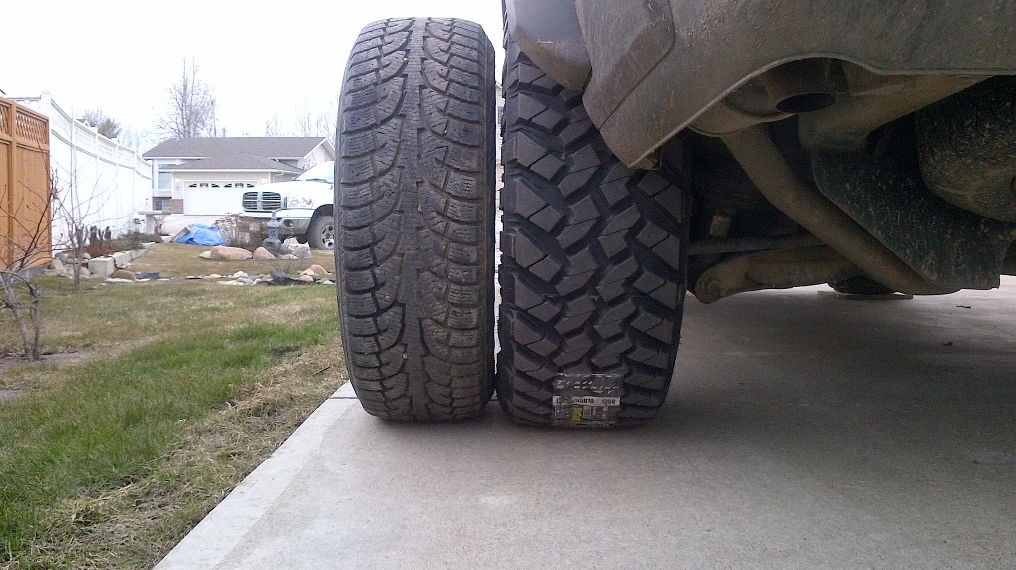

275/65R18 are 32.1" (at least for Goodyear) but that varies per manufacturer. Those are the size I run, and I have had the misfortune of losing EAS on the trail due to an air strut finally giving up (after 105k miles).
Here is what I learned: you really have little room to maneuver with that size tire, on the bump stops. It would be extremely wise to buy an IIDTool and always have it with you, if you are going to run those tires. In an extreme situation, it can get your EAS back up and give you time and opportunity to go pull fuses.
...if your problem is with the compressor itself you're gonna be calling in a tow truck...or a chopper!
For as much as we as a community fear that scenario, I think a properly built LR3 could mitigate that. My sliders protect that compressor very nicely...and the air lines. If it's going to go, I'd think it'd show signs of weakness and if I'm paying attention I can make sure and address it BEFORE I hit the trail with my over-sized tires.
Anyway; when my MT/Rs run out of time and I have to replace them, I would consider going down to a 31.5, but it'd be reluctantly. I like the extra size and I don't run them all the time (Nokians in the stock size on 19s the rest of the time). So I guess we each have to consider our own situation.
