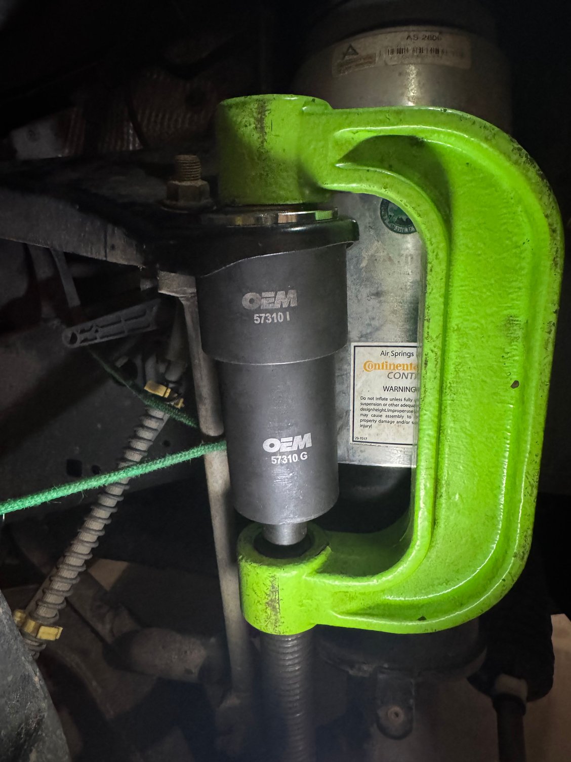

A note to mention on this job. I was not successful from not having the correct tool.
Notice the length of the cup for re-installing the ball joint. It is long. In the workshop manual it is a specific part. I don't think you necessary need that specific part put likely if you rent a ball joint pressing tool set from an auto parts store the cup is not long enough and will damage the ball joint when installing.
So, when you are getting your ball joint un-install/install kit, take notice of the size of the cup

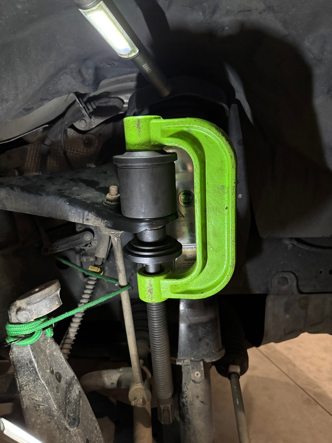

Old Nov 3, 2024 | 09:31 AM
salvo2002's Avatar
8th Gear
Joined: Aug 2009
Posts: 8
From: Omaha
Thumbs up
Just completed this job, straightforward. I rented the ball joint press set from AutoZone… make sure you get the extra ball joint set. To get it out I had to cut off about half way up the the old shaft for the adapter to fit as seen below. Installed new Lemfoerder ball joints; heard issues with other brands not fitting correctly, Lemfoerder fit perfect.
Got mine through AutohausAZ:
https://www.autohausaz.com/pn/LF-RBK500170
Press out:
Press in:
