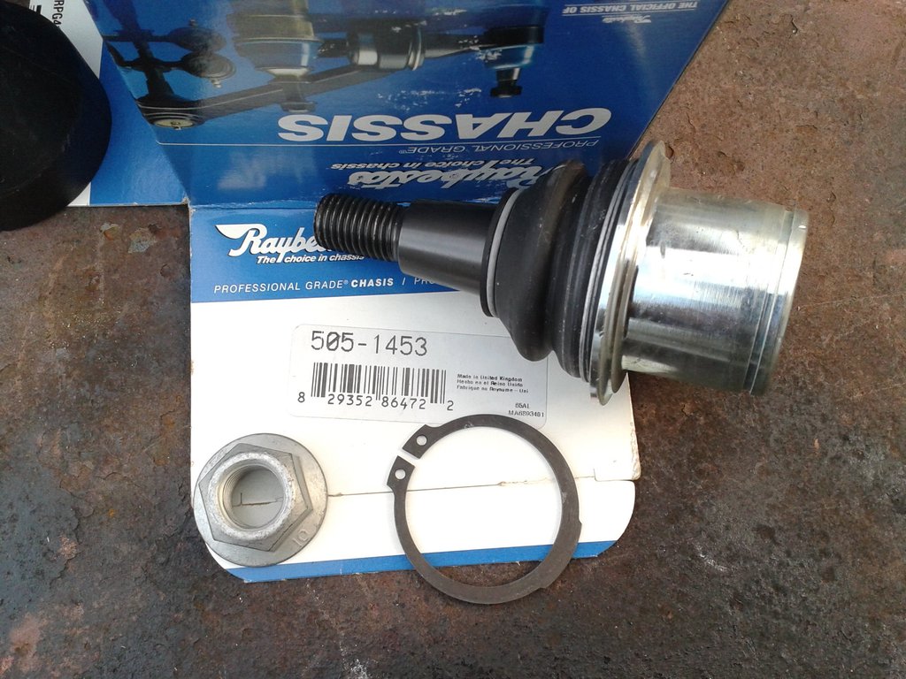

Here is the replacement joint, and pic of the tool setup, I did one on the vehicle one off the vehicle made no difference, super easy
