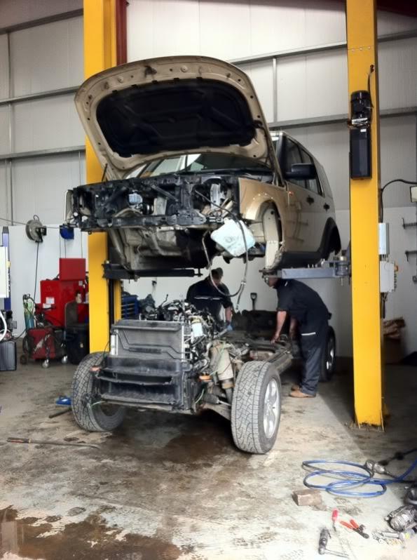

I think you need a cutting torch to remove that cross offending member.
The jpg below is how many get at the tranny; particularily in the UK.
The link below has a number of files within, some showing all the ZF parts, exploded views etc; other files discuss the pans, both metal and plastic, and how to change and fill the tranny oil in a less dramatic manner.
DISCO3.CO.UK Photo Gallery - ZF 6HP26 Automatic Transmission in LR3

Thanks Bbyer!
That link is a saver...if I ever have to work on this thing again I'll have it stored.
Found a pic with the location of the 8 mm hex plug on the side...appears to be just behind the shift cable. I'll top off the fluid and I'll be done with this beast!
