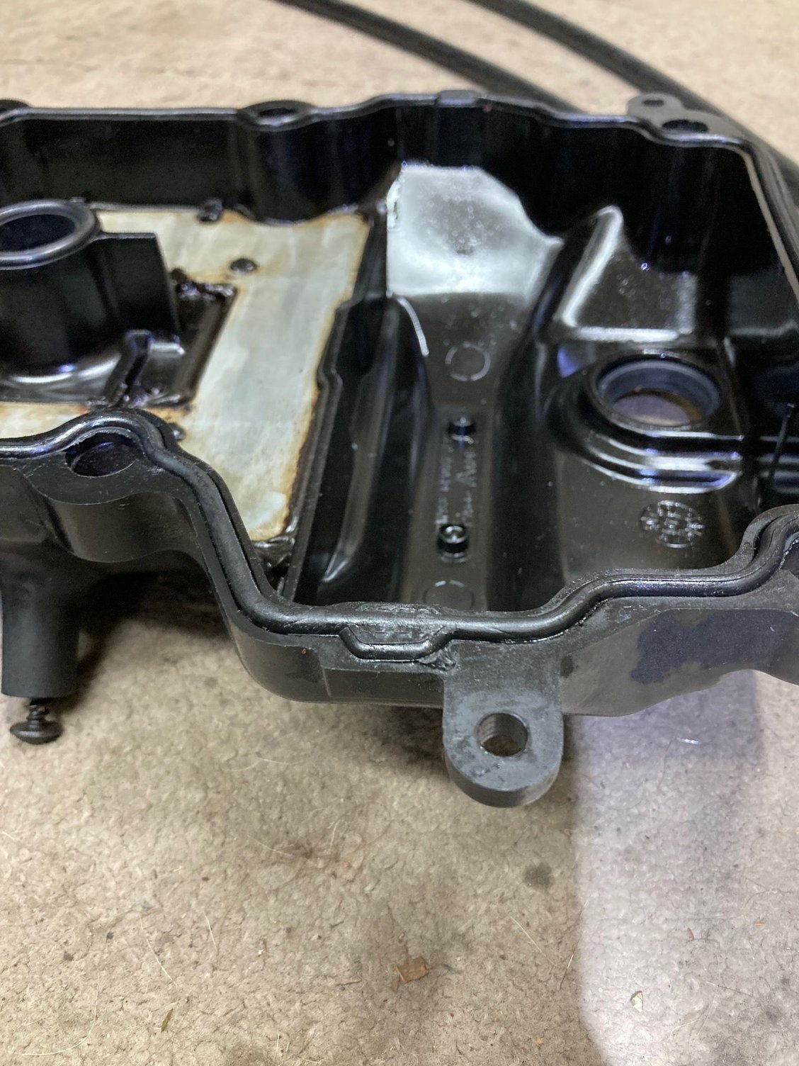

Question Gasket Orientation
Which orientation should the new gaskets go on? Picture 1 or Picture 2? I'm getting leaks using picture 1 but it seems like the logical orientation.
Picture 1, fits easily into the cover channel
Picture 2: Fits very snug into the channel

Top photo is correct, but I see score marks on the gaskets, like damage.... These are new, if so what brand? if URO, then that will be at least one issue. Also are you applying the proper sealant to the prescribed locations? I think its only two spots per cover on the head itself. Pretty much the spot you have in the photos with the wider bit. Did you replace the spark tower o-rings also?

yes, no leaks in spark tubes. Just one spot on the lower part leaks after tightening Maybe I will just use sealant in those areas where it is leaking. These were new Land Rover gaskets. But I have put them on and taken them off at least 3 times trying to fix the leak.
I'm afraid that my plastic valve covers may be warped a little and not maintaining a tight enough seal in that one spot.
