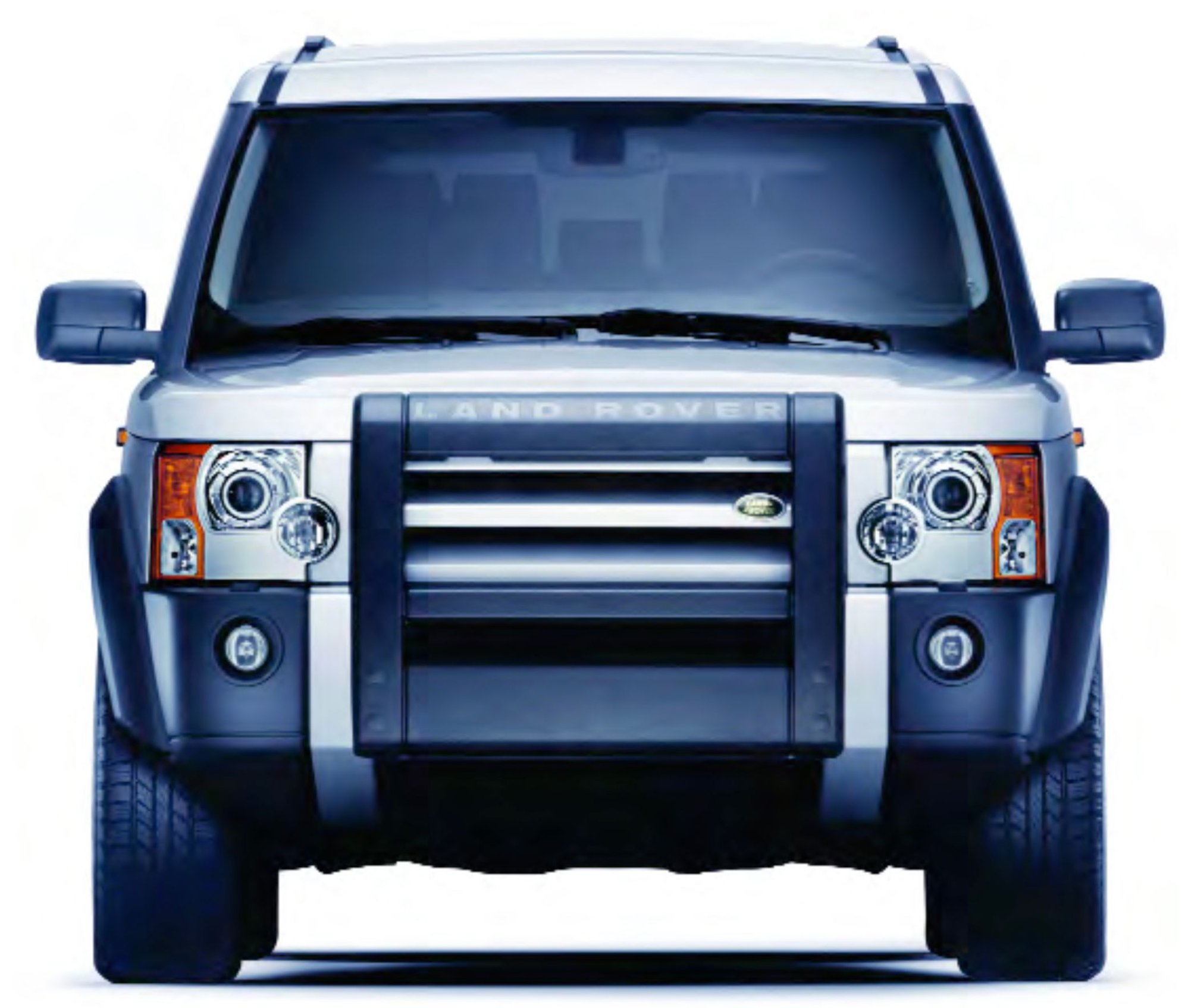

Got an A-Frame Protection Bar for my 2007 LR3 for free, but I don’t have any of the mounting hardware.
Checked the web, made some calls, still can’t find one.
Anyone have a lead on the mounting hardware kit?
I know I can fabricate a kit myself, but trying to see if I can find a ready-made kit before I go that route. Also, the folks at Lucky 8 let me know that Flatdog UK has powder-coated stainless steel brackets to replace the plastic ones, so there’s part of the kit right there.

Those mounts in the link are for the top mounts which are common to both the old and newer style A Bar. There were 4 different A-Bars for the D3/LR3. 2 for the factory winch option and 2 for the non-winch options.
Old bolt (old style)
Without winch - VUB501210
With Winch VUB501230
New Style ( single bolt)
Without winch - LR005237
With Winch - LR005743
I have attached the 4 fitting instruction that have pictures that may help you.
So before we can address the way it mounts to the metal part of the bumper, we need to know which A-Bar you have.
Hope this helps.

I have the 3rd one down on your list; VUB501210.
