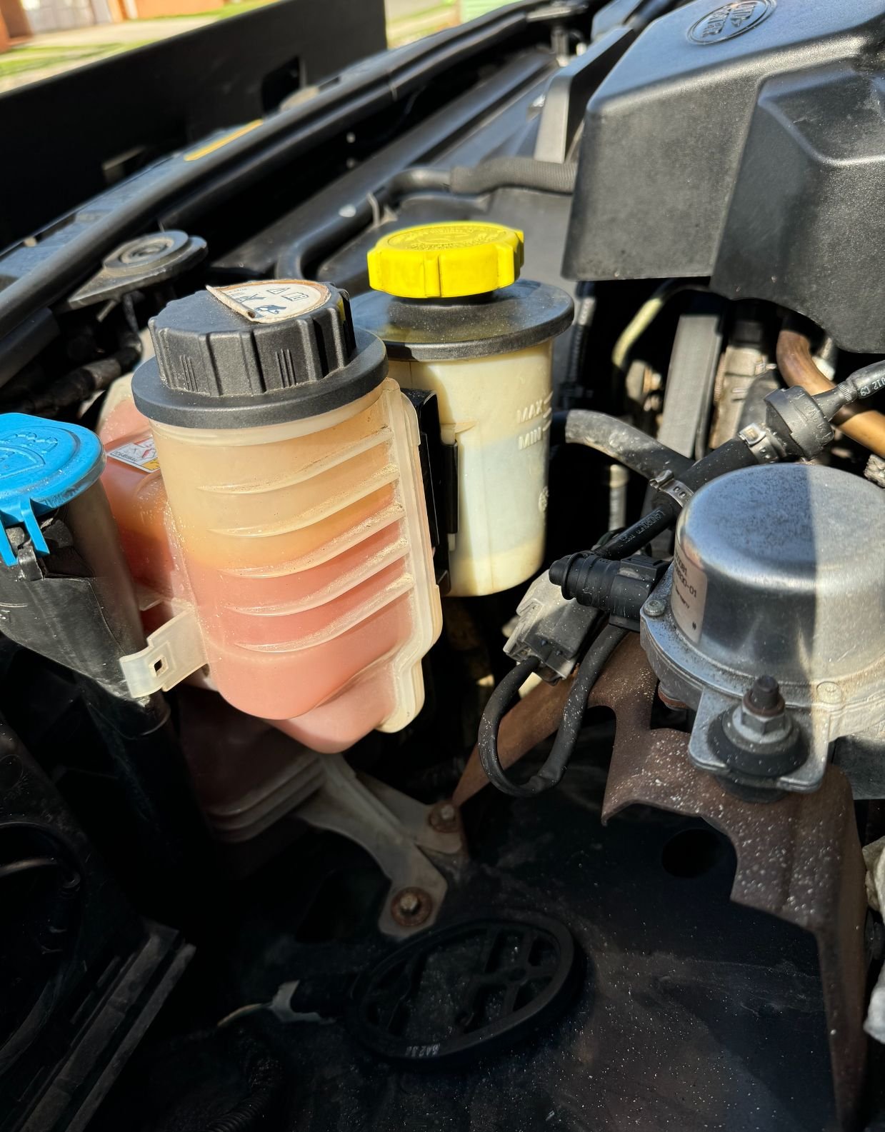

Looks good outside, feels good but some not so good items. First, has a hidden oil leak.
Well, maybe is power steering fluid. Although the truck has an engine oil drop; the PS canister loose some fluid in a weekly basis.

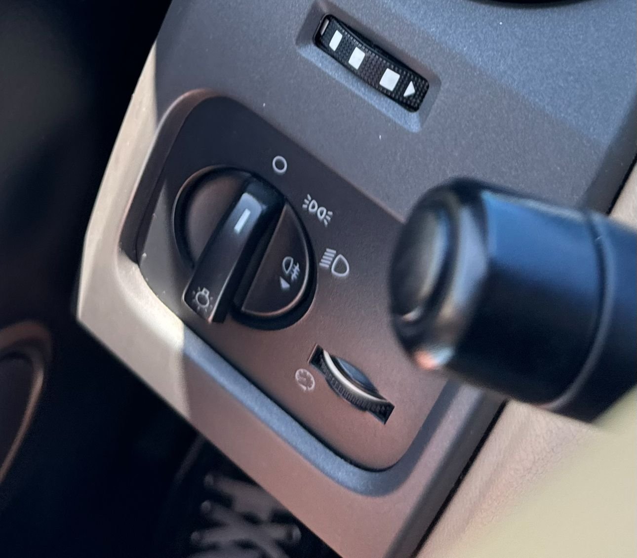

That’s fog lights?

You only need the switch pack to get wheel audio controls, don't need to swap the whole wheel - its plug and play.
That light switch isnt factory, for the factory fog lights you just pull out on the light switch dial when in the park or full beam position.

Today’s level. Engine Oil is at 100%, but PS is going down a bit. Will check for lines and bottle. Don’t think is at steering rack level.

my current switch, base one.

The #2 light switch is the factory setup for the grille mounted lights - the big round ones from Land Rover. Sometimes mounted on the bull bar if you have one. If not, they were removed and the switched stayed.

I have the A-Beam Bar installed. Also noticed OEM lighting harness available. I will measure for voltage using that button. Thanks

Yeah, have to guess they were removed. The switch is part of the aux light kit. Unless previous owner installed just the switch with plans to put the expensive lights in. Either way, it could be a handy setup if you add your own lights at least!
