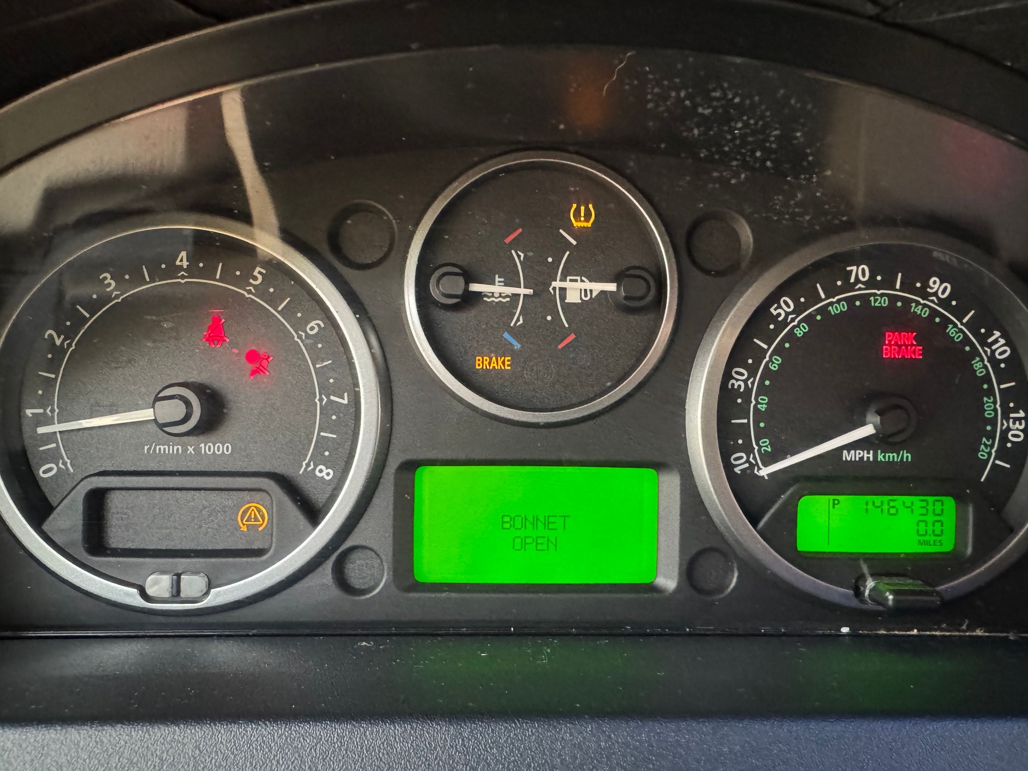

Hi I’m back.
Replaced rear air struts, sparks, front and rear disc and pads and oil leak from main seal repaired.
i let the truck unused for 1 week, all four corners were down, immediately goes up when turned on. That’s normal?
Mech noticed that the control arms are also in need of replace. Is better full replace or just the bushings? Upgraded bushings?
Power steering rack is leaking too!
Still have the airbag and tpms warning lights on!
For a bidirectional scanner, icarsoft CR Max is ok? I know Gap tool is the best, but with this experience thinking about stay with the LR3…

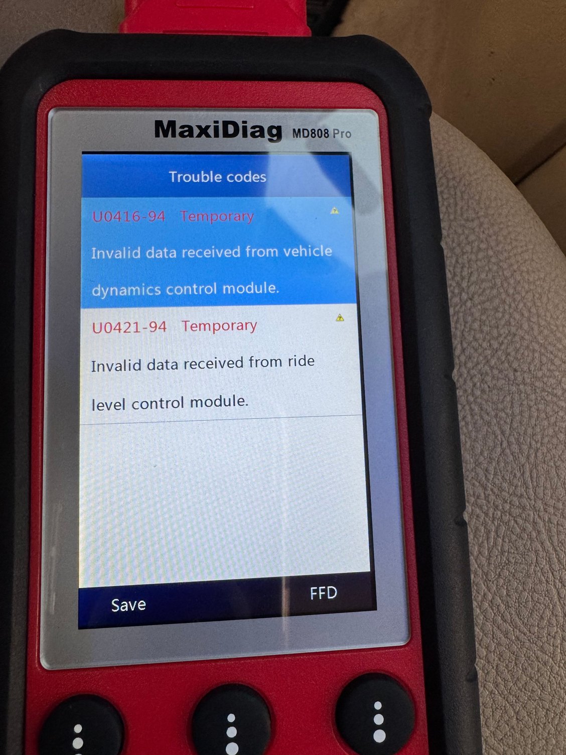

Hi!
One of the airbag code was cleared with the clock spring replacement. But now I have no communication between the ride level control and steering SAS. I installed the old clock spring and still the same. Now HDC fault is alive!
Old Aug 2, 2024 | 02:55 PM
  #30
Xattica's Avatar
Joined: Mar 2024
Posts: 128
Likes: 36
Weird thing, I installed another clockspring that trigger the SAS, etc. I installed the old one, clear the alarm and the front Air bag code go away.
New Autel Scanner (MaxiPRO MP900-BT) did the magic. SAS completed in less than 10 seconds. Now I have just the Passenger Side code b002a-1b.
I requested another clockspring.
in the meantime, how I remove the passenger seat to reach the airbag cables?
Thanks
