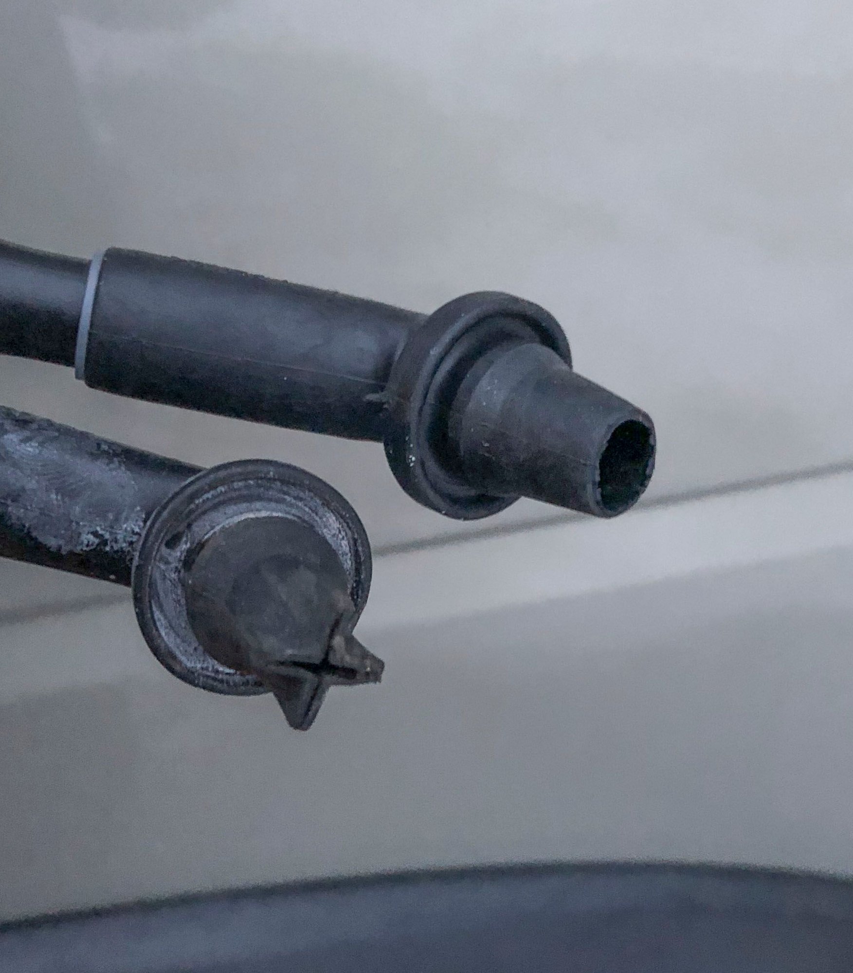

Three leak points:
Sunroof drains, there are FOUR. Driver side front, easy to get to. Passenger side, hard to view and wicked difficult to replace. If you can not view it form the inside, carefully remove the intake Gille by firmly lifting up and hinging the bottom out slowly (the plastic breaks fairly easily). Then remove the rubber inserts. You can see the drain end. The rears seem less an issue as Rover loops the drain hoses upwards a little. They seems to function as backups or only when parked back on a steep incline. Solution, replace the entire lines or cut and connect updated ends. The very ends are not available as standalone parts.
A-Pillar exterior trim. Well documented leak point. New trim comes with a much better design and retainers. A less expensive service kit can also solve the issue if done properly. A dealer did mine incorrectly.
Windshield cowl. It can warp and create a gap. No issue here unless the gap happens above the HVAC inlet. Then water can pour right in, soaking the air filter and getting into the blower.
Attached is an image of the old and new drains. The old style, the cross type, can easily clog with dirt. Over time the dirt accumulates and holds back water and moisture. If really bad the line will fill up and overflow from above. The continued moisture will also rot the rubber causing the end to break apart. When that happens the tubes will drain, but straight inside the cabin. The new ends flow better and have the additional protection of a nylon insert to protect the rubber itself.
