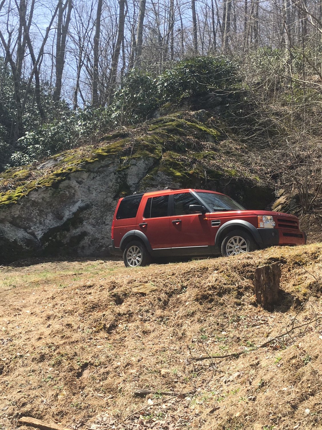

Hey guys. Long time lurker and first time poster, happy to be here. I just bought my second Land Rover after owning a 2000 Discovery II that I absolutely loved. I’ve been wanting an LR3 for a while, because even 10+ years later I still think they are the best looking SUVs on the road. Anyway, I test drove a few LR3s at a local and trusty Land Rover shop and fell in love with a beautiful Rimini Red 2007 LR3 SE V8 with tan interior and only 108k miles. It has a pretty decent service record (https://imgur.com/a/l14MX), has had the bushings and air suspension compressor replaced (among other items), and most importantly - she drives GREAT. The only issue (that I can see) is a warped front windshield cowling, so I’ll probably just make a custom aluminum guard to block water from entering the air system and ruining anything electronic, however, the warp is so minuscule that I might just test my luck. My main question is this: I know these babies need regular maintenance every 7.5k miles or so, and as a new owner who wants to do things right this time around, I want my first service to be pretty extensive and cover all of the bases. With that being said, what all should I consider getting serviced? Eventually, I want to learn how to do a little work myself, but one thing at a time, right? I'm thinking my first priority needs to be differential and transfer case fluids. Thoughts? Questions?
