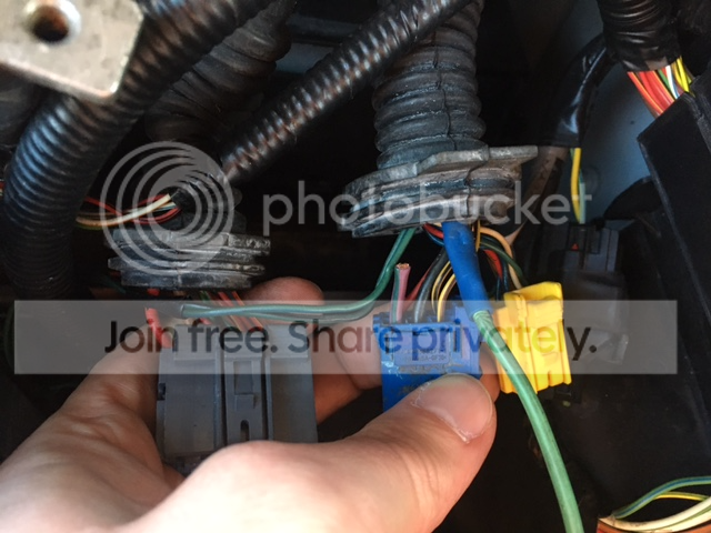

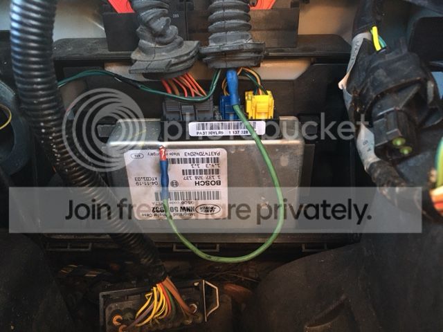

Right now I'm focusing on the Integrated Transfer Case Control Module (TCCM). This is very suspect to me. Like I said before, I can see that it was replaced in April 2019. Also, because a pin was broken, someone snipped that wire on the harness, and spliced one from it directly into the TCCM, bypassing the pin.
See purple wire with green stripe. Does anyone know what this wire is for?

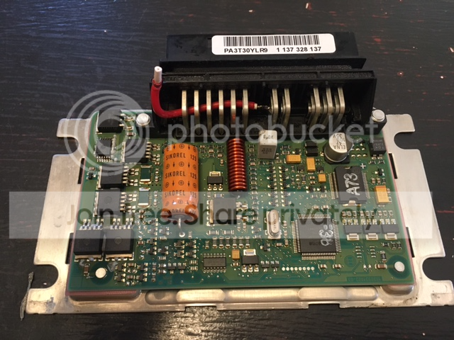

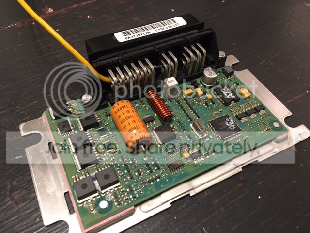

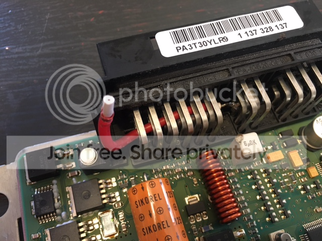

This is what it looks like inside the TCCM. Notice the red wire that has been soldered in to bypass the broken pin. I don't know much about electrical, but this wire looks significantly smaller gauge that the purple wire with green stripe from the factory wire harness. Could that be a problem? Also, the insulation on the red wire was failing where it went through the box, although not bad enough to contact the box and short out.
Old Jan 1, 2021 | 04:44 PM
That is the most screwed up repair I have seen I think.
Yeah I would start there

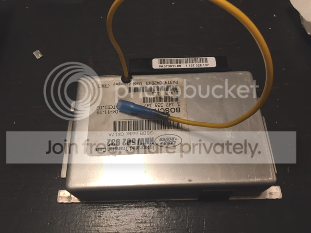

May have made progress... I basically did the same repair on the TCCM as the previous owner, but used 14 gauge wire:
Did a hard reset, installed the battery (showing 12.9 volts), and tried to start. I'm getting mostly the same fault messages on the dash as before. What's new is the hazards flashing and doors locking and unlocking when I turn the key on. Also the yellow "Lo" with mountain symbol flashing. Don't recall that before. Still won't turn over. I also tried jumping the starter relay again with the key on, turns well, but will not start.
