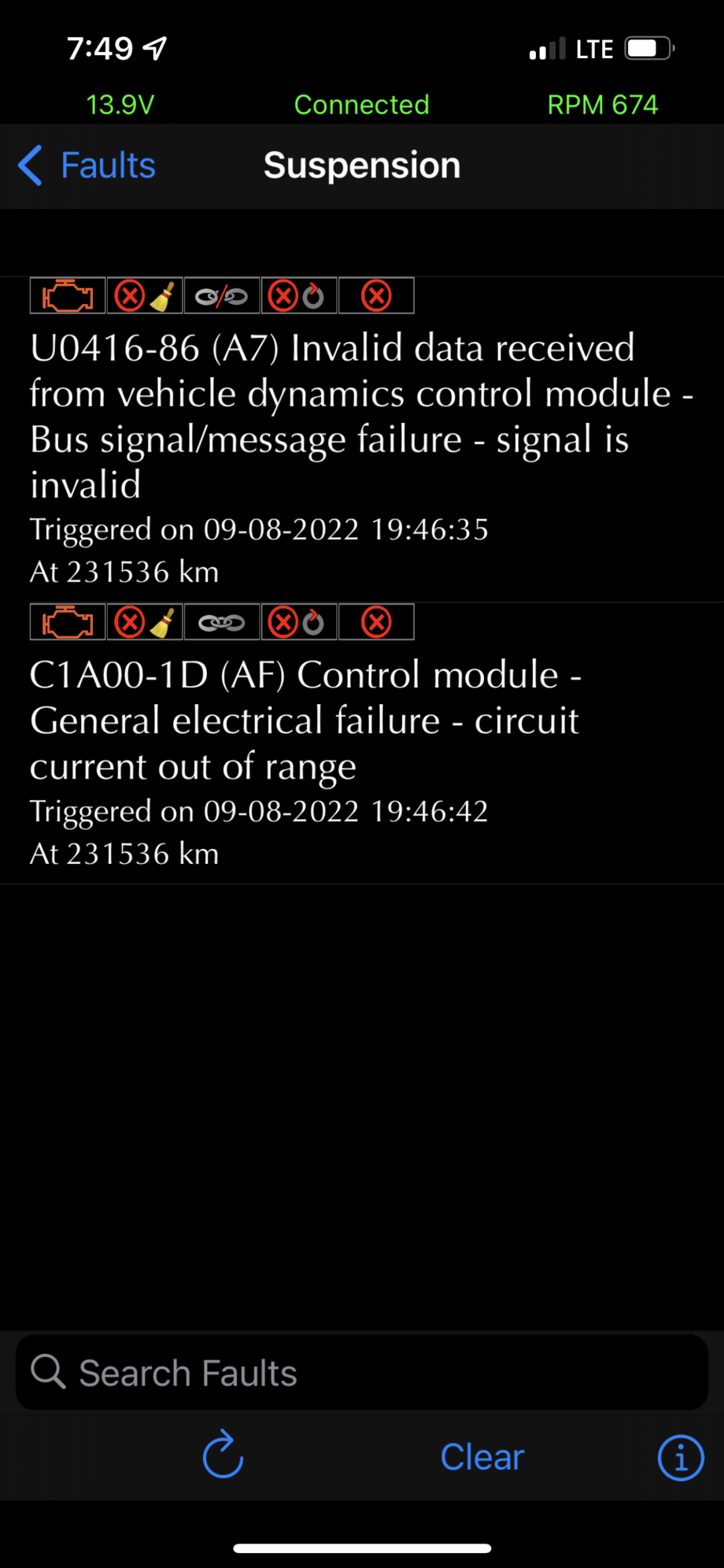

well despite the compressor pump being new it doesn’t even fire up BUT it does work ( on my gap tool I tested the valves and could hear it trying but also not raising)
the dash lights up with the red brake symbol, the yellow stability symbol and the yellow symbol with the arrow in a circle.
I replaced the brake switch thinking this would solve my woes. But alas no.

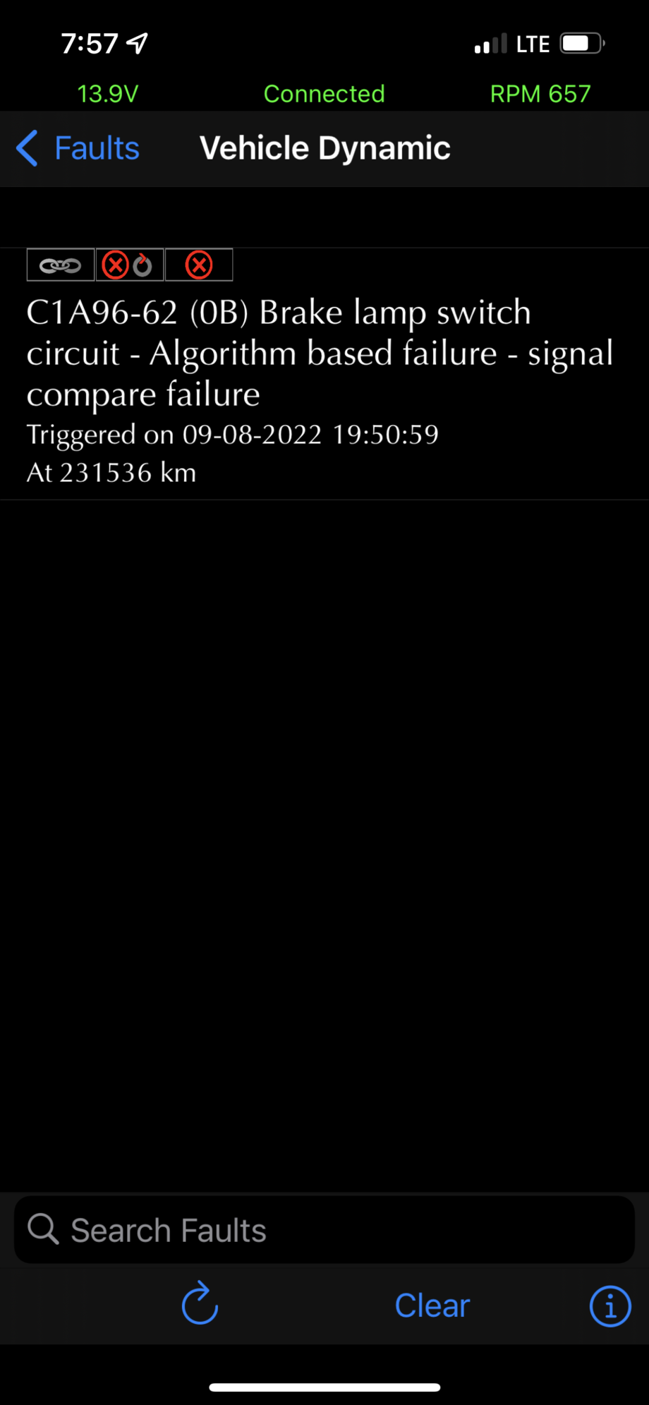

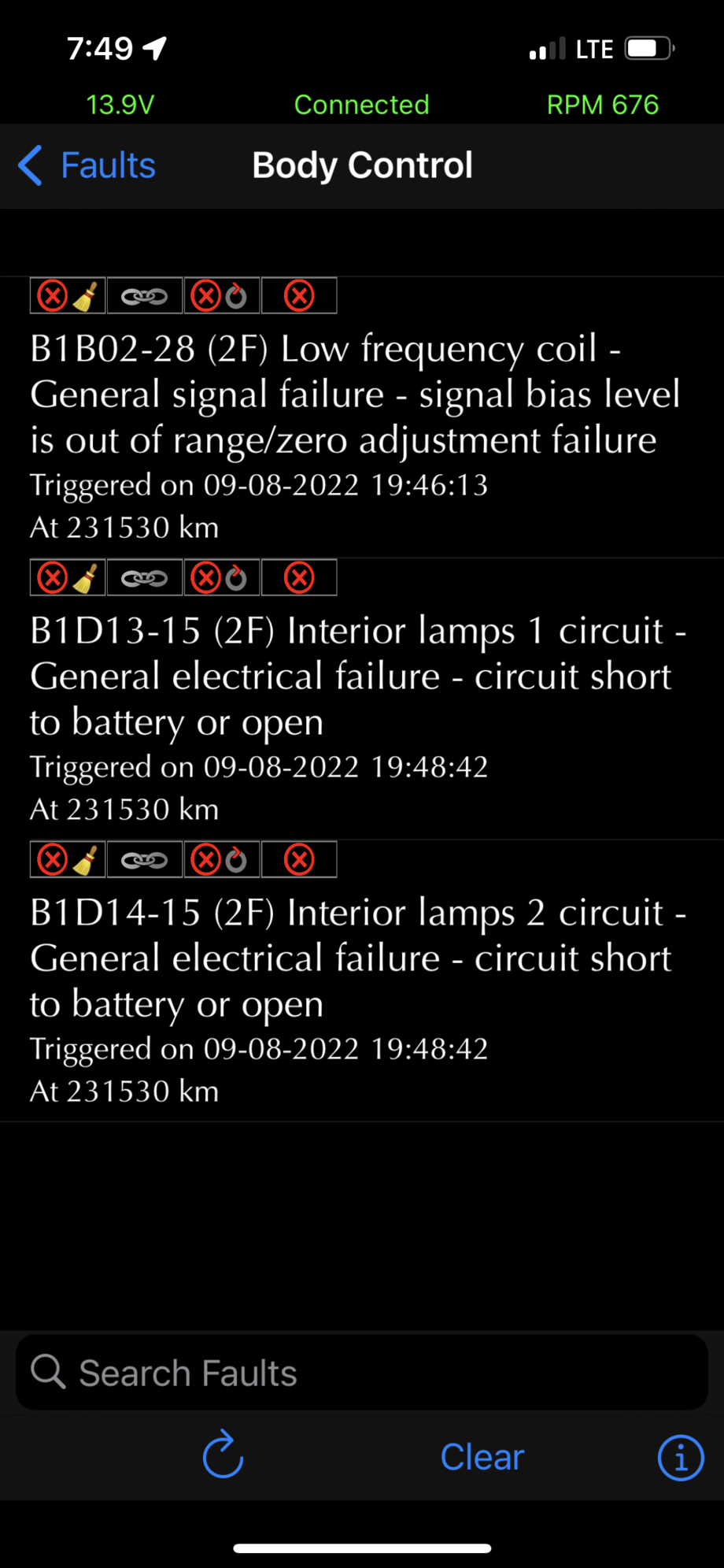

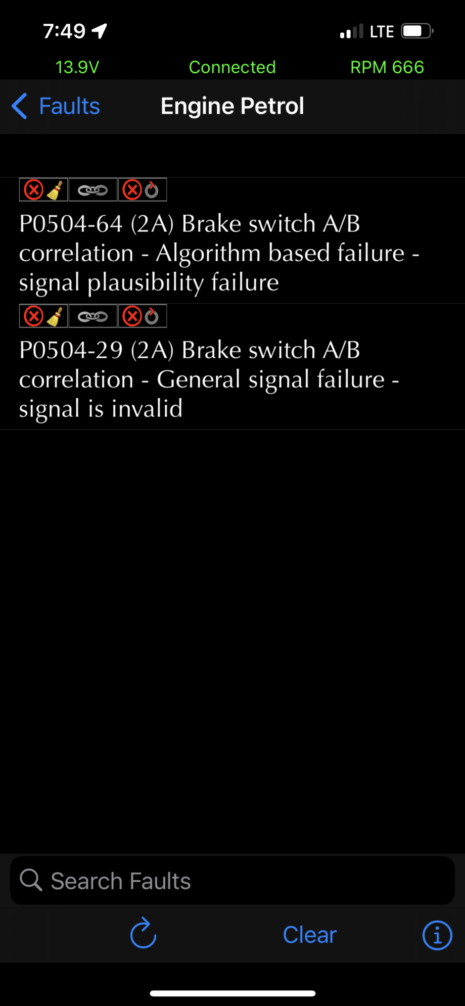

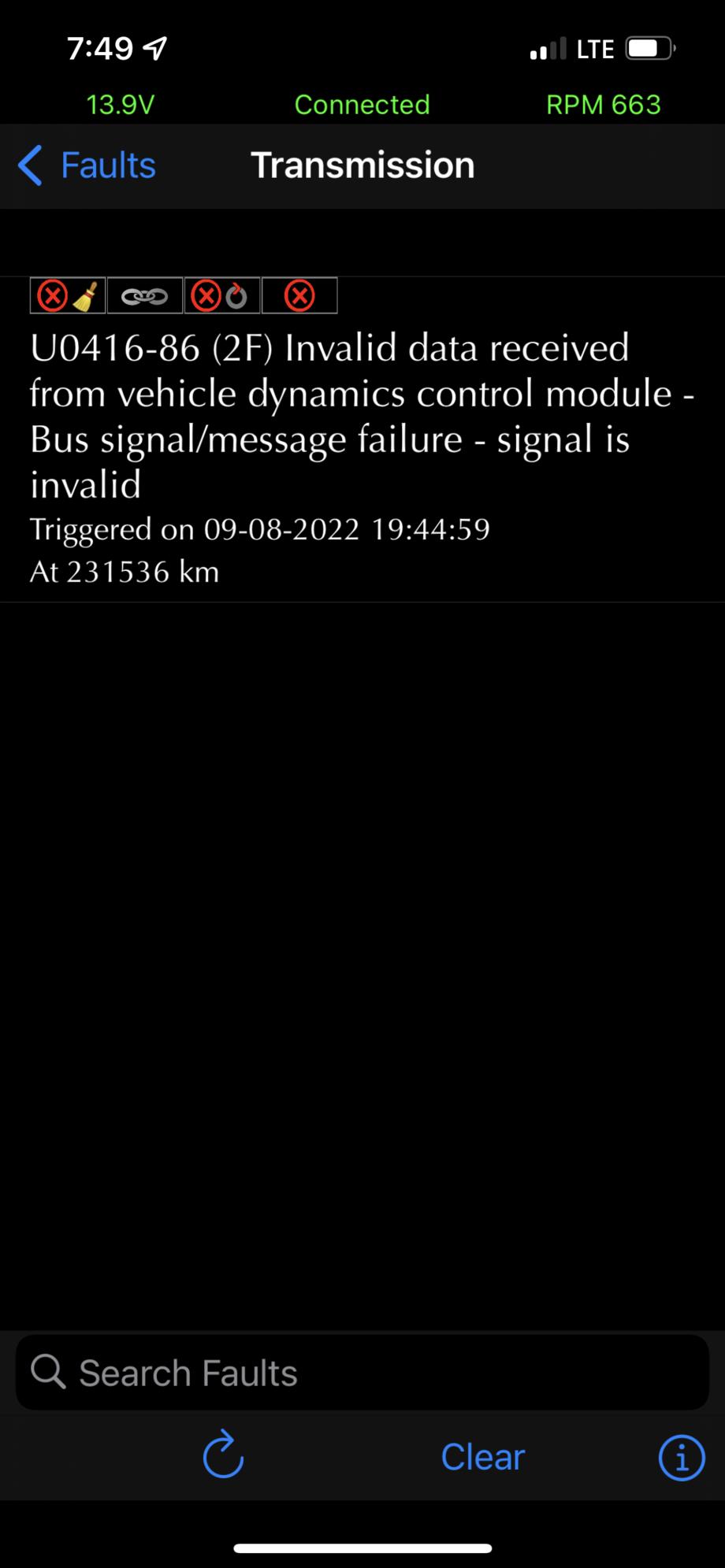

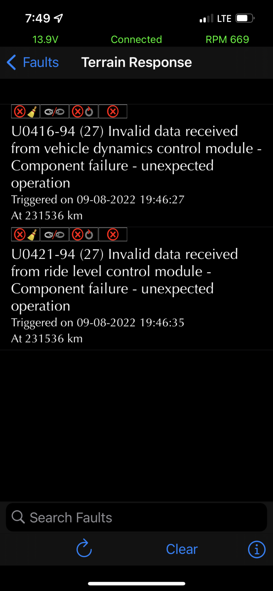

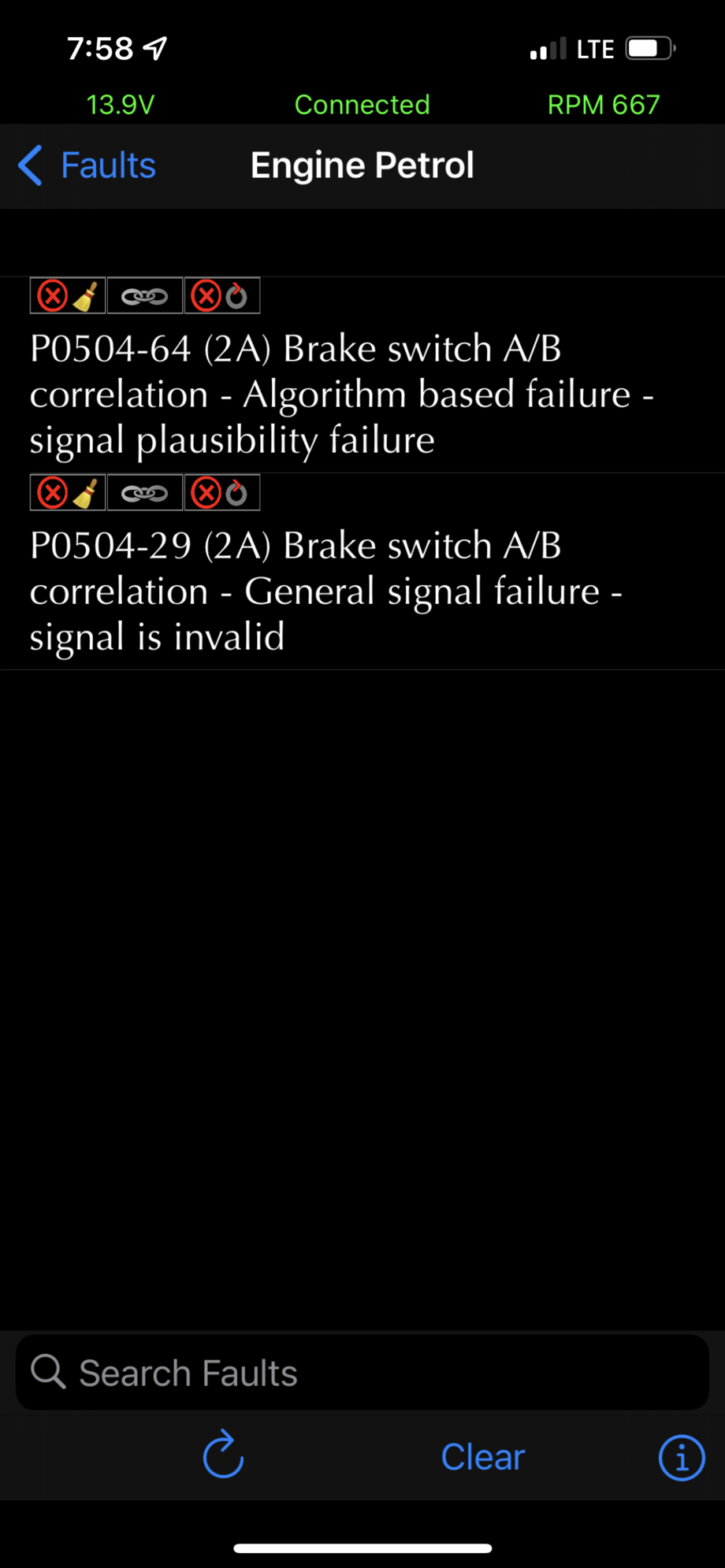

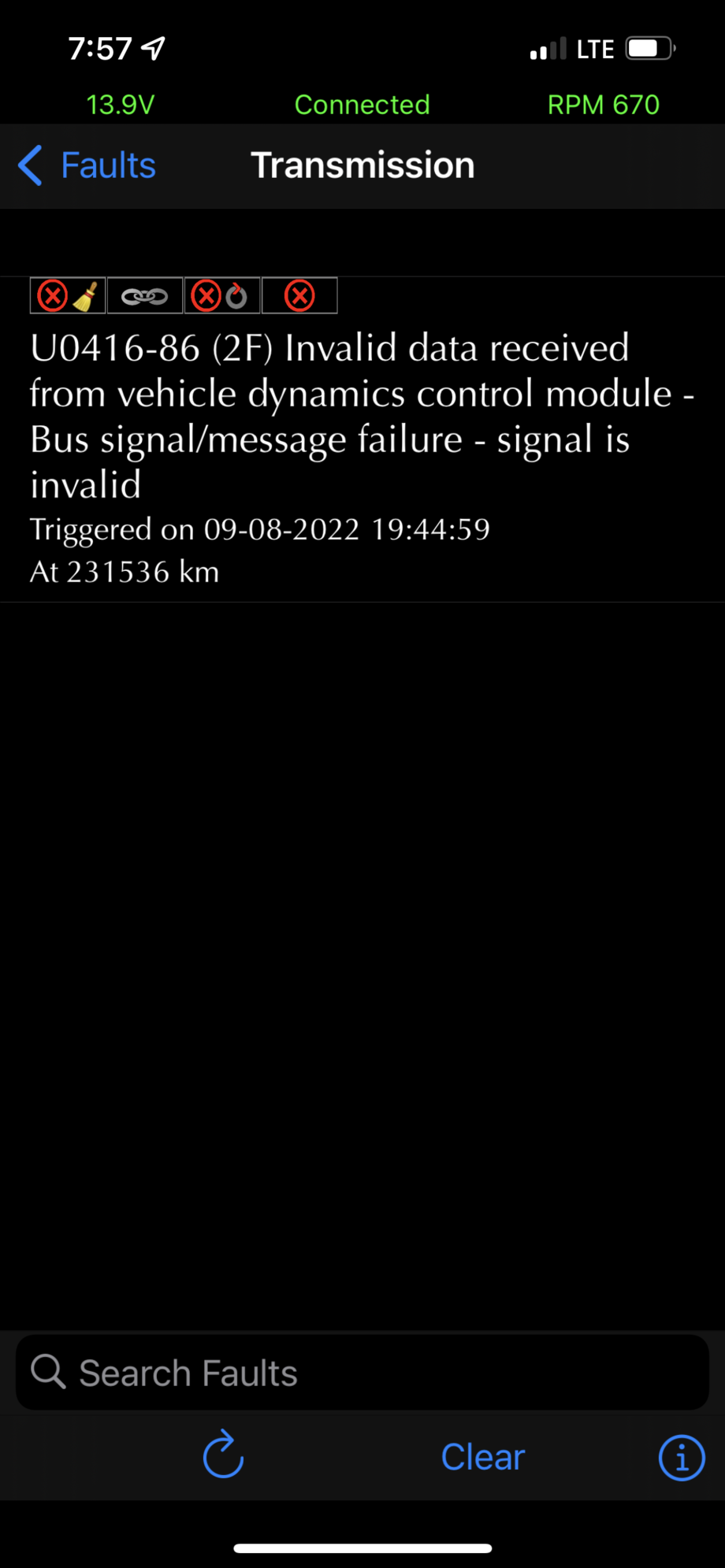

here are the codes - issues point to the vehicle dynamics control module…is that the one behind the battery?

Well the brake switch comes up a lot so what was the part you fitted, OEM, genuine or cheap copy ?

Brake switch for starters but also I'd look through all that wiring and see if the water ingress issue caused some damage.

Update here - perhaps someone could help me think this through.
I have fixed the garbage splices on the driver's side - there were two (are there more)? and the passenger side I fixed the infamous fob connector.
I wanted to try and logically think about why i'm getting a HDC fault and a suspension fault. I think they are separate issues, but possibly from the same source/issue (ie. wiring)
I have looked at the brake switch - both the new one and the old one. I'm still getting faults with either - which leads me to think it's a wiring issue somewhere. I thought, tonight just for fun, I'd remove the brake switch from the keyhole it sits in and then "reset" it by turning the black prongs, effectively engaging it. As it sat out side of the pedal, fully engaged, i turned the car on. To my amazement no HDC fault (although transmission fault and no cruise control still appeared) . When I pushed the pin back (effectively releasing the brake) it errored. So there is something not right with when the brake fully up and not engaged...I hear the "clunk" from the solenoid on the gear shift allowing me to shift. Any thoughts here?
