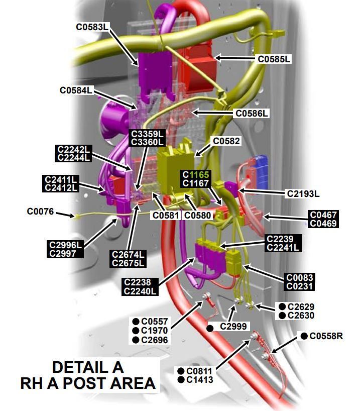

For some reason, I could not attach a picture to the private message. If you are looking for Connetor C1165, It is behind the right kick panel and just in front of the Central Junction Box
Let me know if you need the whole wiring diagram, I will try to figure out a way to send you one.
