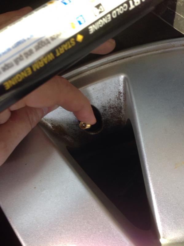

Hard valve stems are the ones with sensors, rubber valves stems do not.
Attached Thumbnails New Rims and pressure sensors-image-1686116807.jpg   New Rims and pressure sensors-image-786240206.jpg
