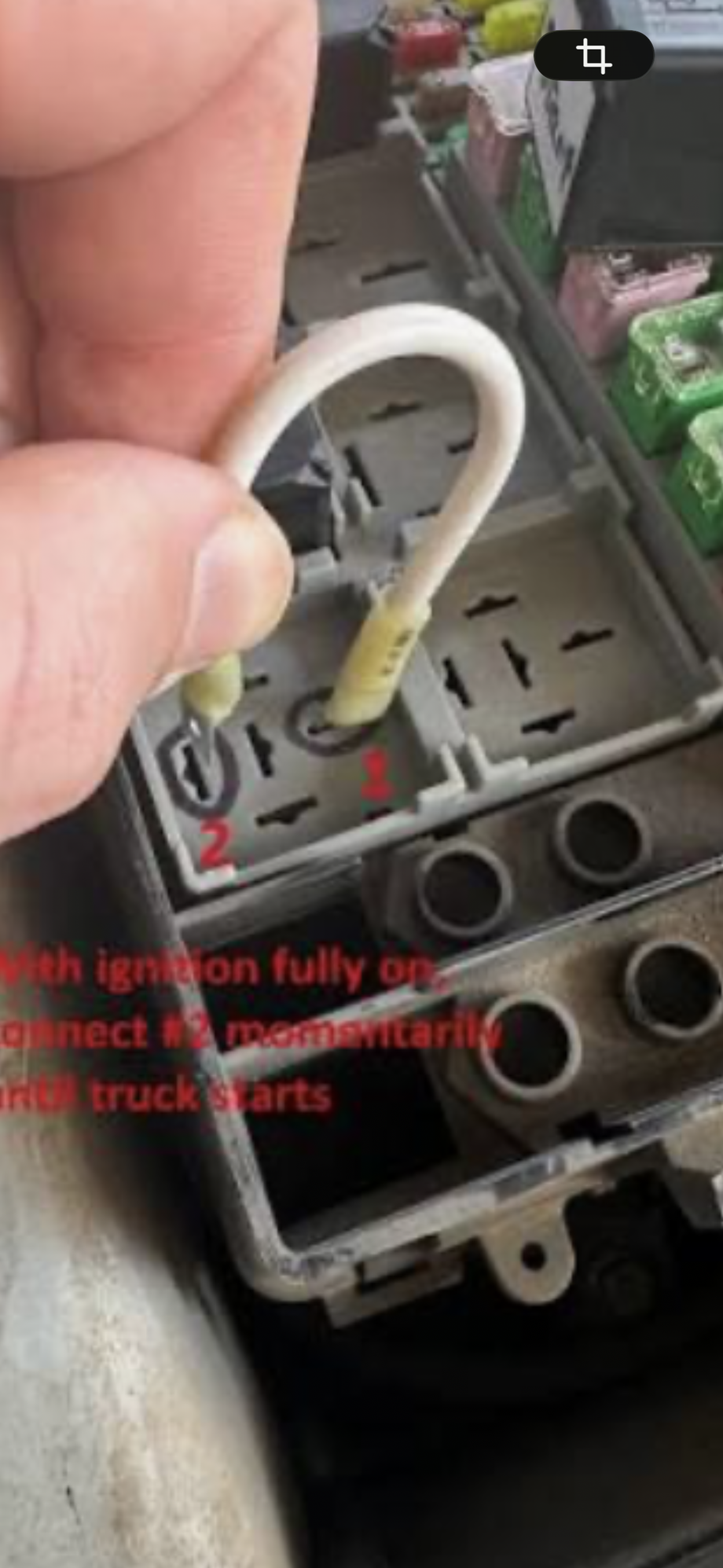

Hey. I have problem with Discovery 3. It drove allright since yesterday. Was repairing sunroof leakage and found out also that sunroof fuse was blown (i havent used it for a while), so I put new fuse in. Since that time I can't start the car. It just does nothing when I turn key to the last position. It's manual transmission model, no no "P" gear lock error possible.
- tested both keys
- No blinking immo icon on the dash
- swapped the starter (SM) relay - no effect.
- all fuses ok
- new battery
I bielieve there's no voltage on below SM terminals when key is in the start position...
Any ideas?
Aleternator and starter are good btw

I replaced the relay (should be in the place of the wire looking at pic from1st post) with another one for the headlights (it's identical). No change. I believe there;s no voltage on the (1) temrinal when key is turned to crank. All fuses okay... I\m really confused
