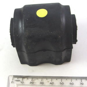

Per the jpg below, there are two oil filled rubber bushings that tie the rear stabilizer bar to the underside of the body. The "oil" leaks out or the rubber wears and noise is transmitted into the vehicle from "somewhere".
Per the unseenone post, the odds are the problem is the lower front A arms however.
Replaced Lower A Arms rather than ball joints.
The part number for the bushings is LR015336.

I actually have those bushings ready to be replaced. Just waiting for the rain to stop.

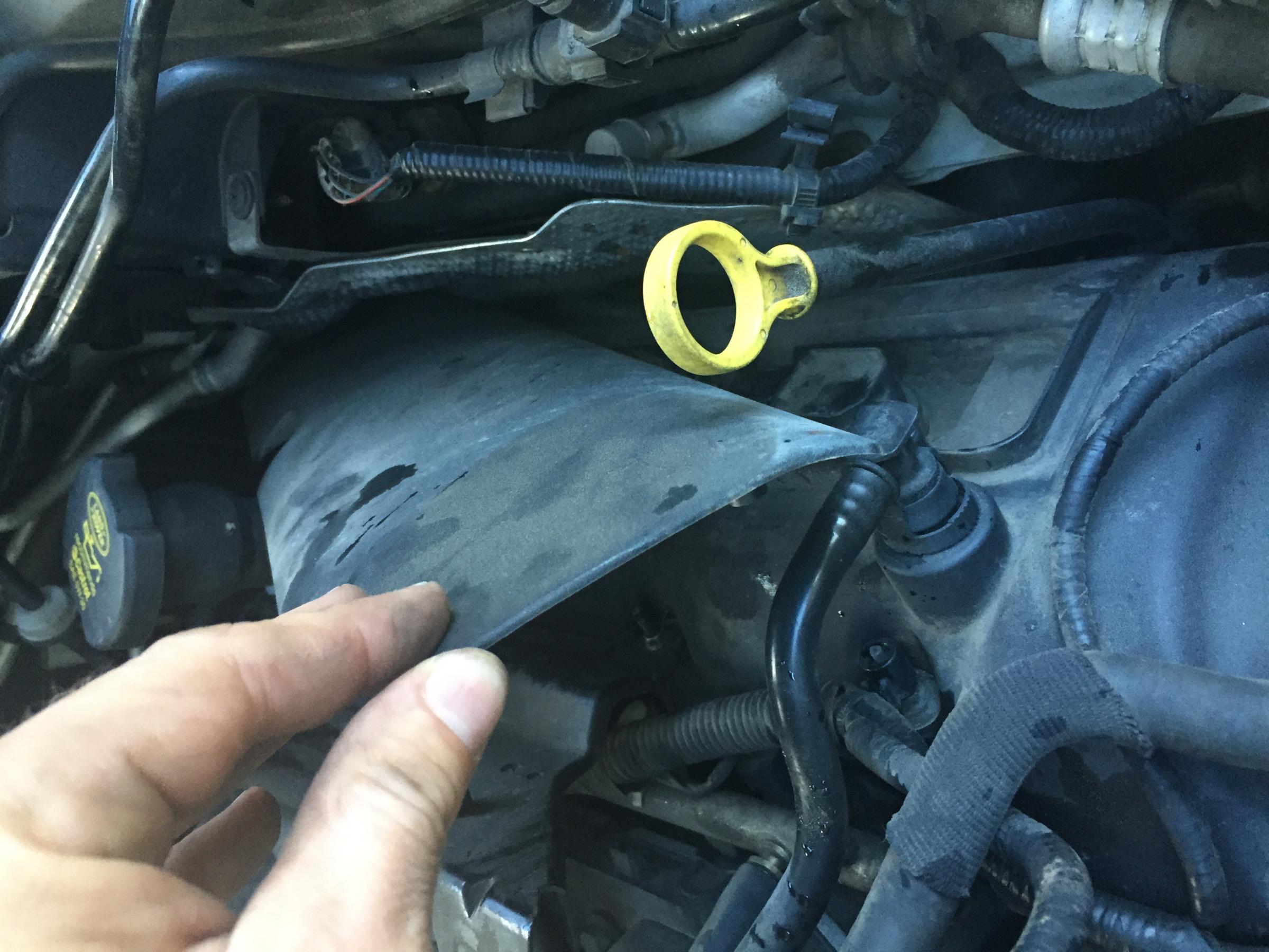

Off topic real quick. Since you have been so helpful. Changed the thermostat today. Easy. But i found what i think is the spark plug plastic cover part (both of them) loose while i was in there. Are they supposed to affix to something?

I do not know what holds them on but I assume it is some plastic tabs that have broken off. I was not certain I did not see one of them under that oily hose at the oil fill end in your jpg.
Sometimes this stuff matters - to some degree the covers are for cosmetics but some relate to sound or temperature control; hence I am loath just to ignore the concern when it arises.
We will see what others say.

The hanging weights are harmonic sound dampers, and I suspect angle sensors. In the UK I've read they disintegrate eventually, something to look for in wintery places. I have actually convinced some friends that they put the weights on it so you can drive underwater..
The plastic covers over the valve cover are not held on by much, they are some sort of heat shield. They looked pretty flimsy when we put mine back on. Only fix would be to replace them if they won't stay on and cannot be attached. They sit over some bolts on the valve cover. You'll note some valve cover are bolts, and some are have a threaded bit, with a nut on them. If I recall, it sits on some of those.. I need to look again.
