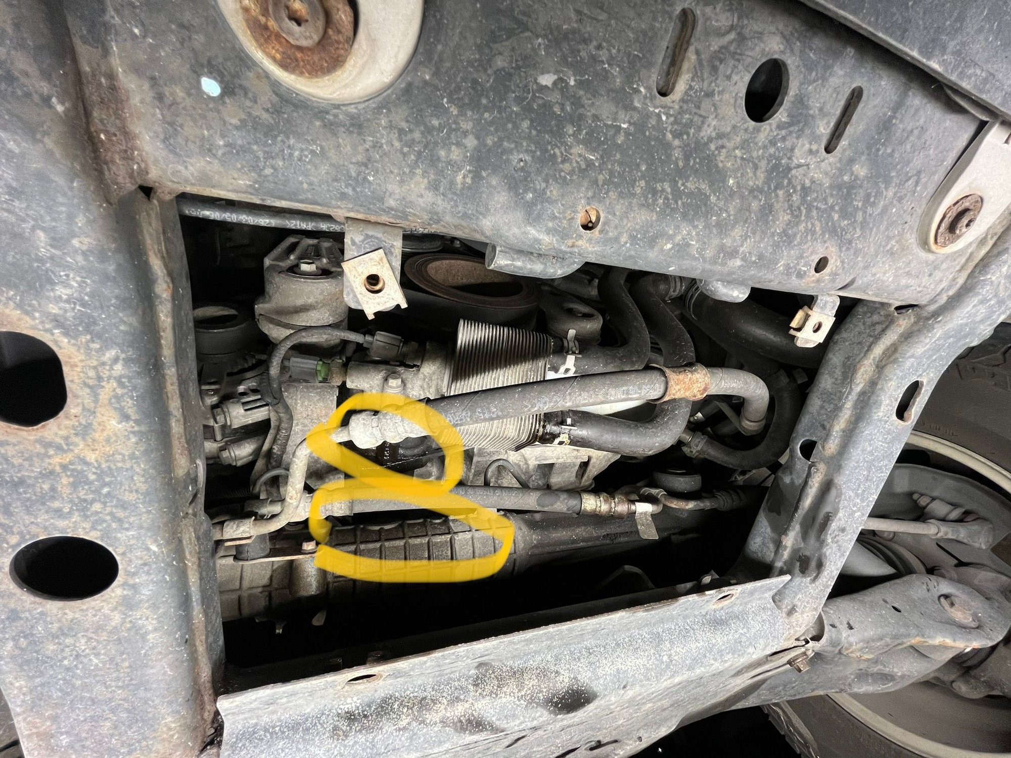

I think so? It would go over the gap that has the oil cooler and filter; between the front of the bumper assembly and the skid plate that is below the front axel..? I typed those exact things into eBay and could not locate that listing… though truthfully if thats all it is… I am going to likely just cut some scrap steel out that will be 10 times as durable.. I have the larger one for sure.

Yes, that is the one. And yes, you could make something. They also sell after market skid plates which are even more annoying heavy and make oil changes a living hell. lol

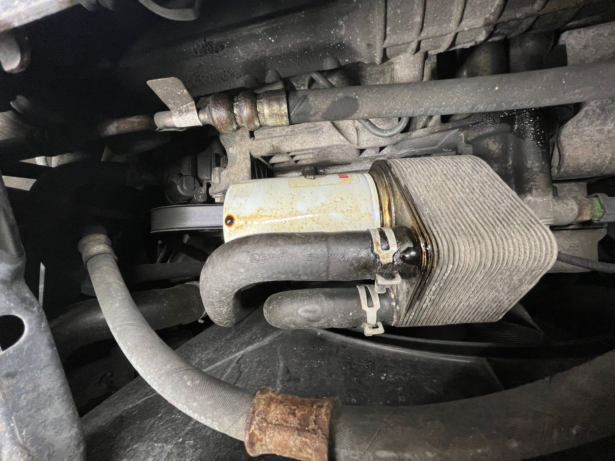

Speaking of the oil changes and I know it’s a little too late right now since I just had it changed but would you change the gaskets on the oil cooler at the same time or is that something you’ve had to do? I’ve got it wiped up because it was either left a dang mess under there or I’ve got oil coming from elsewhere… maybe where the oil cooler bolts onto the front of the short block?
I forgot I had pictures… hang on.
Gap where I was wondering about the skid plate…
leaky gaskets?

I have not changed mine yet, but there is a $10 oil cooler gasket that does leak. Look like the number 8. Pretty each to change, I just keep forgetting to do mine when I do an oil change. Two bolts and unplug a couple sensors I think.

I was debating on whether or not I could clamp the hoses and just top up with some oil after pulling it off..
