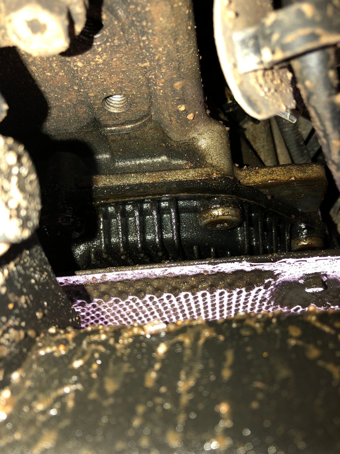

Took a few pics on trying to figure out where this oil leak is coming from. I’ve never had an oil leak. I did park on a hill the past few days and noticed I had oil underneath the vehicle. Thanks guys for any help or insight. 2006 LR3 HSE

Hard to tell but I'm going with T-Case.

Your transmission valve body sleeve thing is leaking. Very common issue. Sadly the pan has to be taken down to replace. Basically there is a sleeve that houses the electrical connector for the trans. The seals fail and it leaks. You can even get transmission errors as a symptom as the contacts get contaminated. I think if you buy a new one its been updated with double o-rings. Part number: TZV500010
You appear to have the original plastic pan/filter combo. I suggest you look into getting the metal pan upgrade, that way you don't have to drop the cross member to get a new pan on. With the old pan you cut off the pick-up tube to get it out. Search the forums, TONS of info. Also you can get Motorcraft SP XT-6-QSP transmission fluid which is far, far cheaper than anything else and 100% meets the required trans fluid specs. DO NOT ATTEMPT TO USE A TRANSMISSION LEAK ADDITIVE.

Default Mechatronics sleeve...
..same item, Dakota?

Ah.. that probably is the correct name! But when I bought mine it was in fact called a valve body sleeve - guessing the seller was guessing the name.

Ordered the kit conversion thru Atlantic British. Did the install 2 days ago. Very straightforward just time consuming. It took the majority of the day to do it. Was able to address a small exhaust leak as well with the addition of adding a new exhaust gasket. I’ve been in the mountains today and I’m amazed at the difference just changing the tranny fluid has done so much smoother shifting and I’ve seen a difference in better fuel economy by 40 extra mpg a tank. Well
worth the $300 spent.
