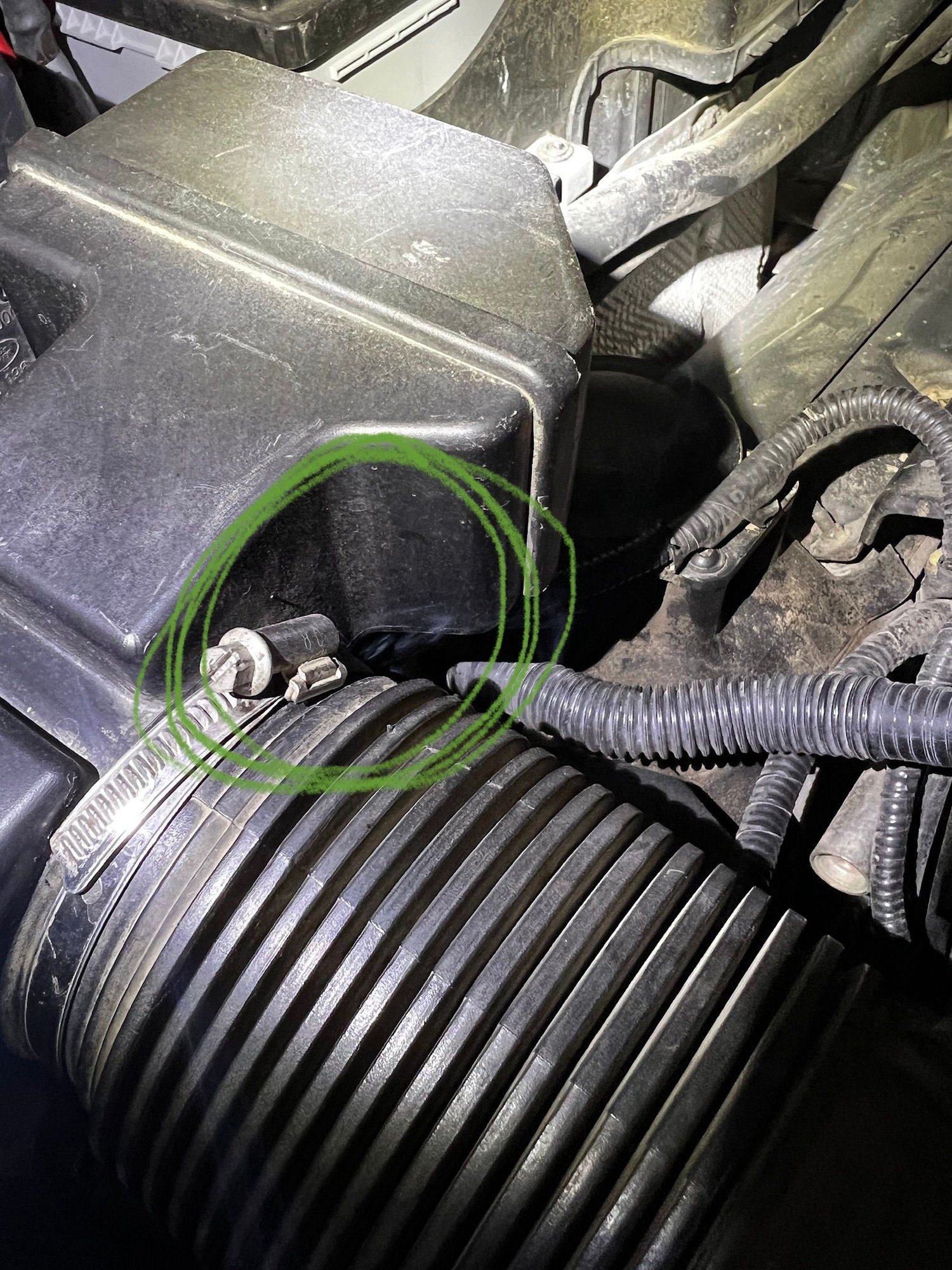

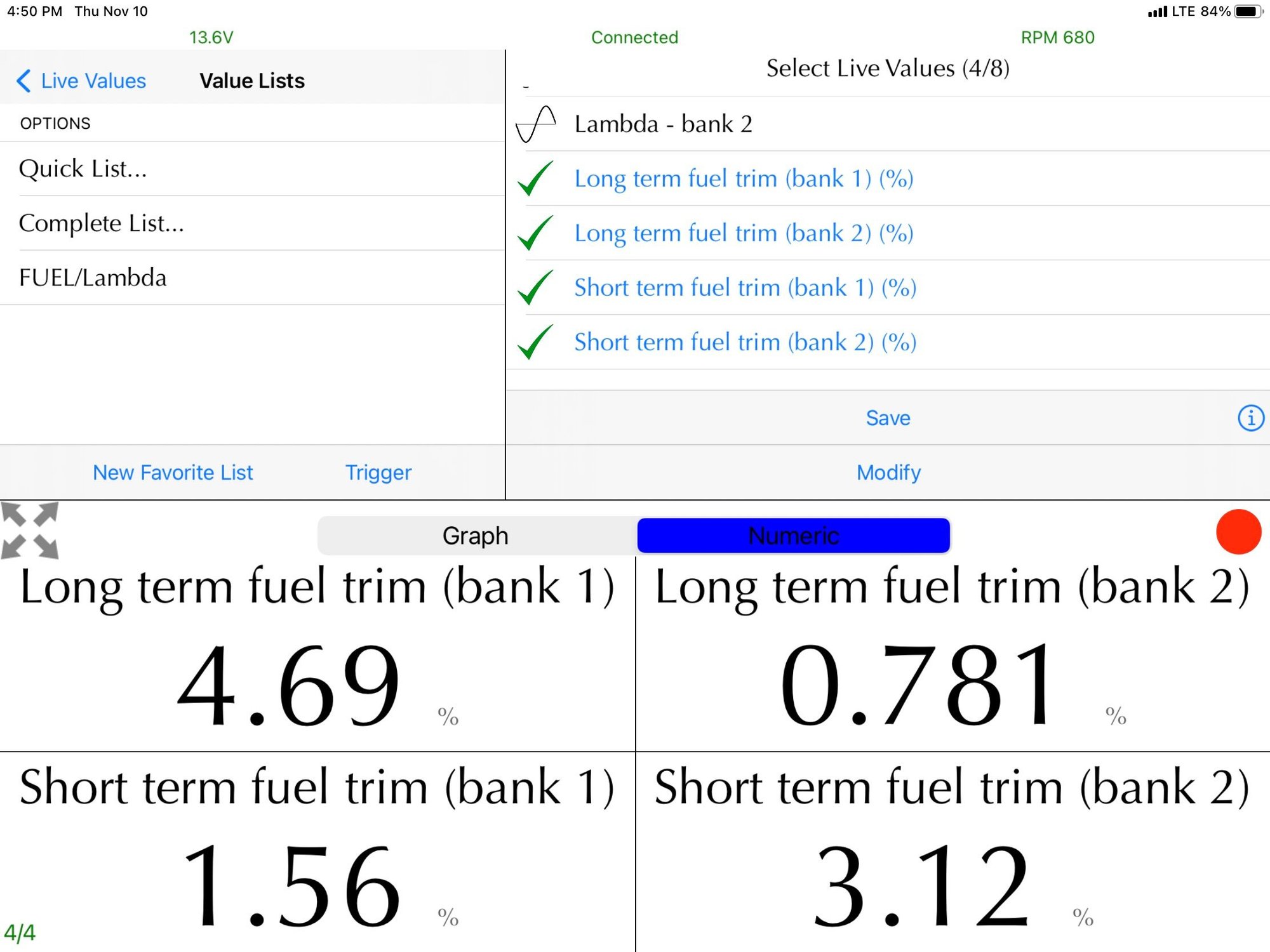

I’m still struggling to find the issue with my LR3. I’ve started calling mechanics to make an appointment. Most are out by the or five weeks. I fully cleaned and put together the intake manifold and replaced a couple vacuum hoses. The CEL light was only off for 1 day. She’s back! I figure now I need to use the propane method and look for the vacuum leak. My two long term trims are about constantly 4-6 points different.
Anyone a semi expert on the fuel trims?

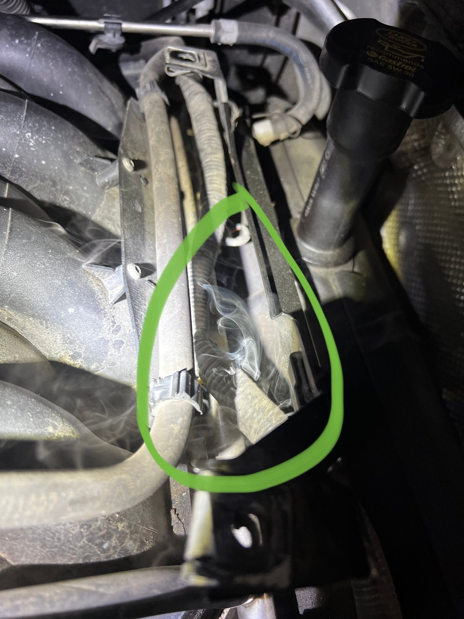

'aight - I finally got a good smoke test and noticed the following:
  • immediately, the top of the EGR, where the silver meets the metal leaked smoke. The oil filler cap was off cap was off.
  • eventually, a short time later I noticed smoke from both the left and right lower portions of the intake manifold (? I think ?) - photos below. The oil filler cap was off cap was off.
  • when I left the oil filler cap on and let it build a bit of pressure I got a lot heavier leakage from both of the above.
  • when the pressure build a bit more I got some leakage from the air intake resonator. I then released the oil filler cap, dropped the pressure and stopped.
So I guess (with your help) I can confirm that the entire thing is leaking all over the place and needs an entire intake manifold reseal using the British Atlantic kit here: https://www.roverparts.com/engine/kits/9218D/.
Should I try doing the EGR first before ripping the top of the intake off? Or, should I go ahead and reseal it all with the kit and then find a new resonator or just go the RRS route with the straight pipe? Finally, do I need to do a final smoke test after a full reseal?

Driver's side smoke leak.
Passenger side smoke leak (rear'ish).
EGR: more specifically where the leak is on all sides of the two parts.
Passenger side smoke leak (forward'ish)
Smoke leak from resonator.
