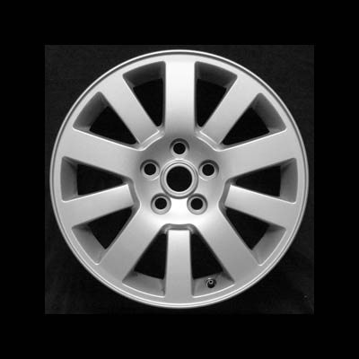

Default 940 kg marking on inside of one of the spokes
Your factory 6 spoke will have markings similar to the attached. The jpg's are from the back side of both my factory 19" six spoke and factory 10 spoke 18" rims.

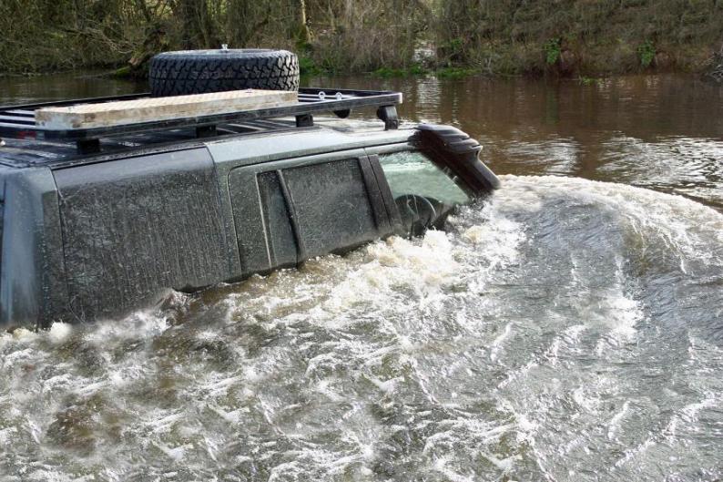

Default real feature is that it freezes the height
How high you can go depends upon how you set it up.
The instructions give the official line; how you calibrate is up to you.
The higher you go, the less stable any vehicle is including the 3.
The main feature of the LLAMS is that once a height is set, the 3 remains at that height regardless of speed. For rock climbing, that does not matter as speed is not a concern; for fording creeks, keeping speed up does at times matter.
Doodling thru the water when the roof rack is getting wet is not the best technique. In the jpg below, in addition to speed, a little more height might also be desirable.
