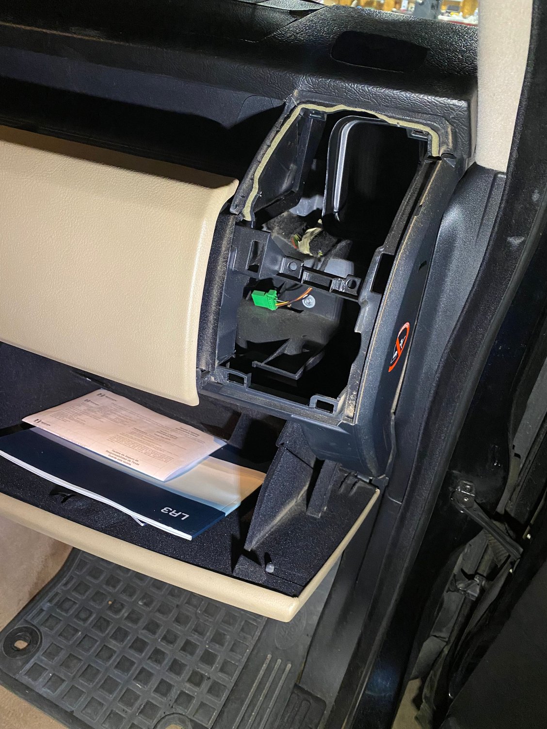

2006 LR3
SE
Does anyone know what this electrical connector goes to. It is behind the vent on the right side. Mine is an SE so I don't have all the speakers that the HSE has.
Just curious.
Thanks,

Could be for a nav screen unit.

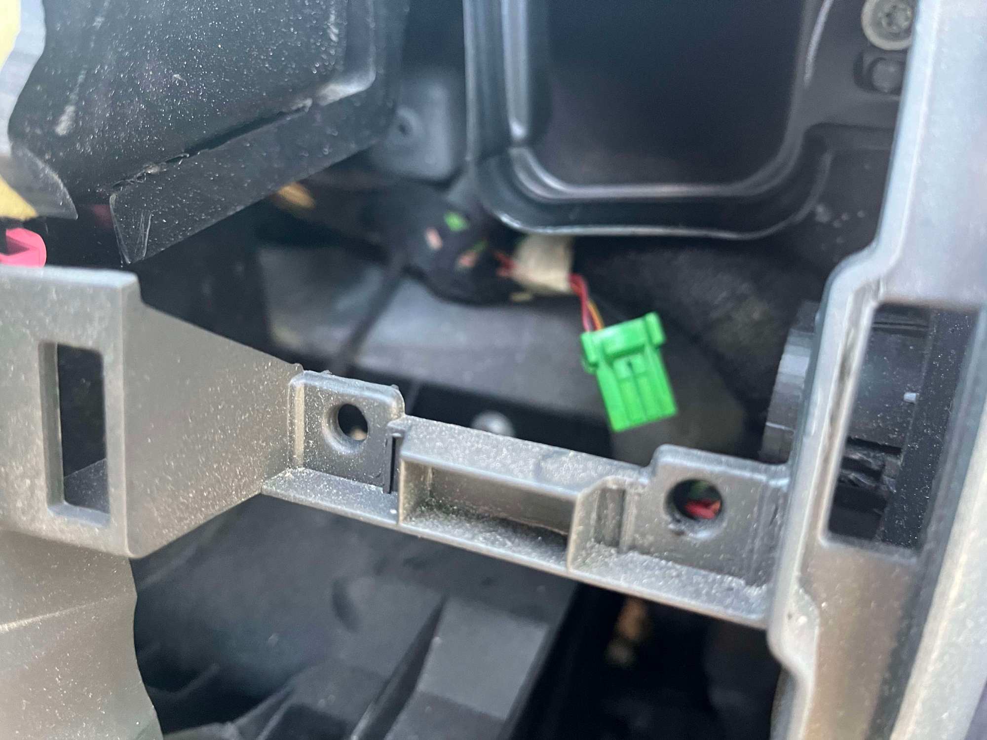

Looks like it goes nowhere on a 2006 HSE as well. Here’s mine, just sitting there.

Do you guys have the Cold Climate Package? Maybe it goes out to the mirror...?

My 06 does not have the Cold Climate Package. My 07 does, but it's 1,200 miles away so I can't check it.

Ah, I was thinking the right vent at the center not the far far right. No clue then.

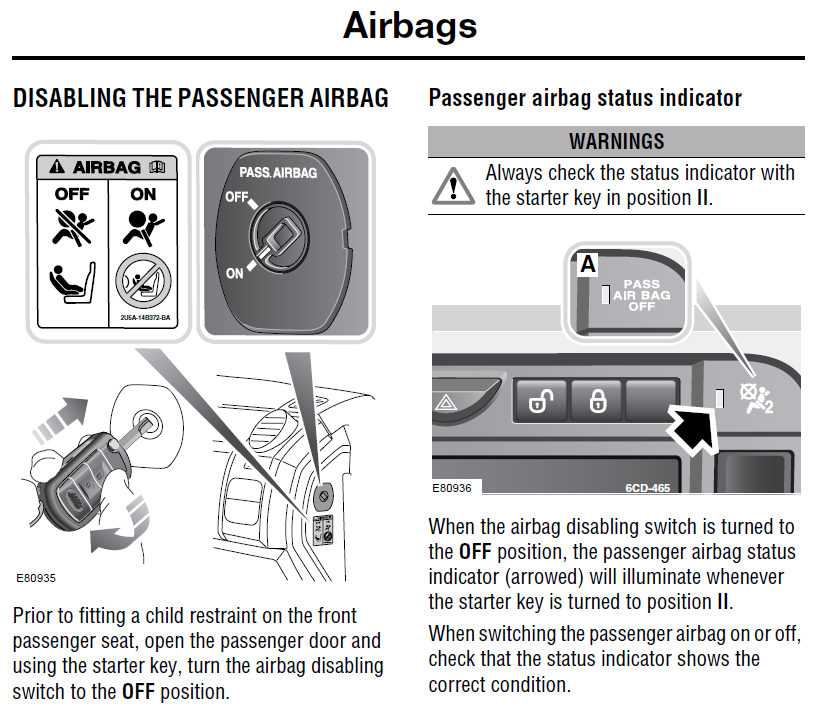

It may be for the airbag switch which the NAS cars don't have because we have seat sensors. some ROW (rest of the world) cars have the ability to turn off the passenger seat airbag.
Just guessing.
Jeff

Stumbled across this. Looks like Rufflyer nailed it!
