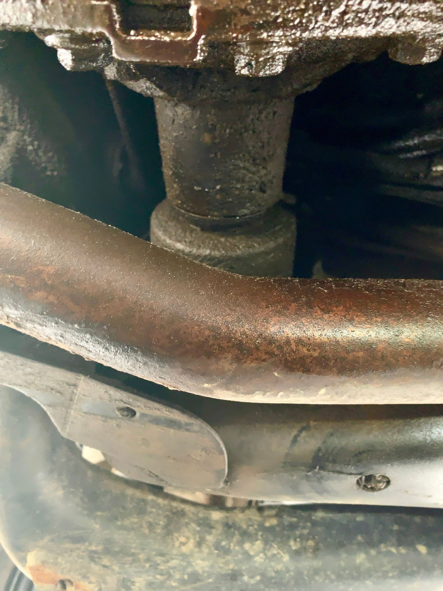

Default update with pics
All-
Per the suggestion-
here are the pics from the rear differential. The shots are taken from the passenger side.
left side diff w half shaft
close up Left side diff and half shaft
Rear Diff from Passenger side

I would, myself, not consider that a small leak. If I were you, I would clean that up really well. Simple green is good stuff. Then try to pin-point the leak in that mess. I cant tell if it was just the drain plug, your half-shaft seal or the diff body. A shot of the where the half-shaft enters may help though, near the boot sorta.

Gotcha-
I will give it a go this weekend. For what its worth, There is no detectible sound of grinding or anything.
But I will clean up and see if I can figure out where it is coming from.

I would, myself, not consider that a small leak..
Agreed, nothing small about that.
