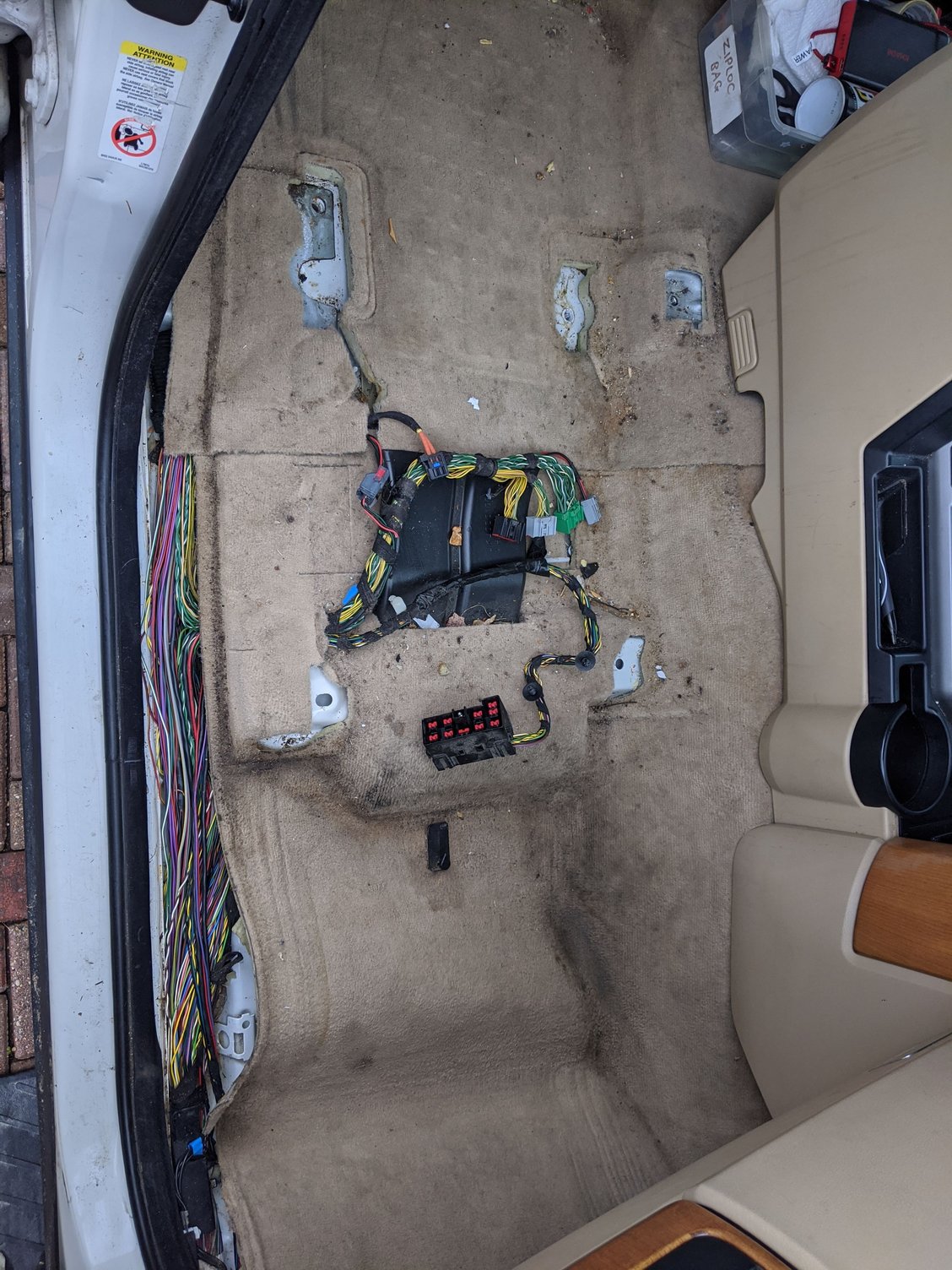

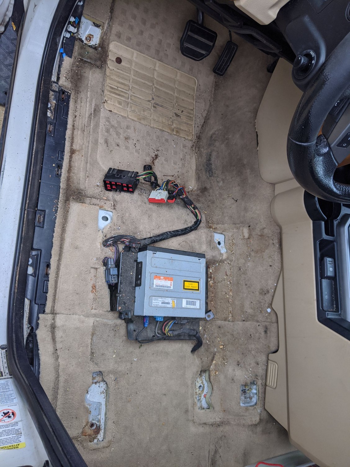

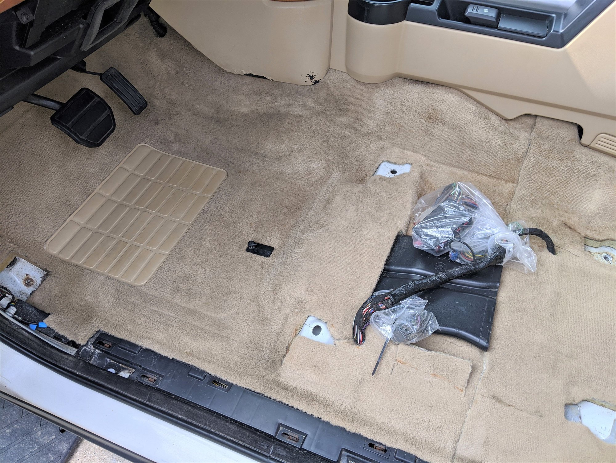

Reporting back. The cleaning went very well. Did not need to replace any of the Driver Side foam padding (beneath the carpet). Removed some of the Passenger side foam padding, for further inspection, and I do need to replace a small amount. Less than a square foot. You can tell quite easily - Any padding which is a bright, light, almost white, color is good. The 'browner' (darker) it is, the more moisture it has captured. I did not do a thorough deep clean on some of the carpet that is beneath the Seats. Although, it actually looks better than the photo below suggests, due to lighting differences. Very pleased with it. There wasn't a single stain that I could not remove, using a combination of steam cleaner, lots of micro-fiber cloths, a little carpet cleaning solution, a little warm water, and the wet-vac. As you can see, I made sure that I protected all electrical connections with ziploc bags and zip-ties, prior to starting the cleaning.
