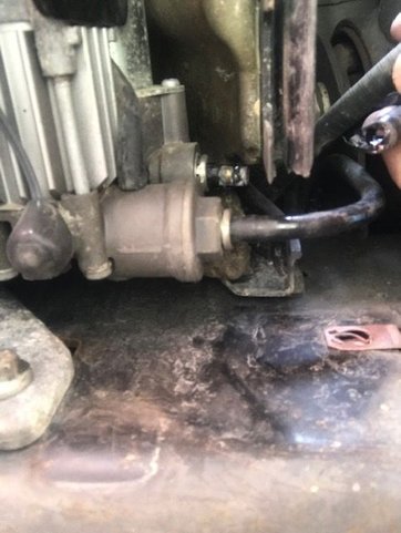

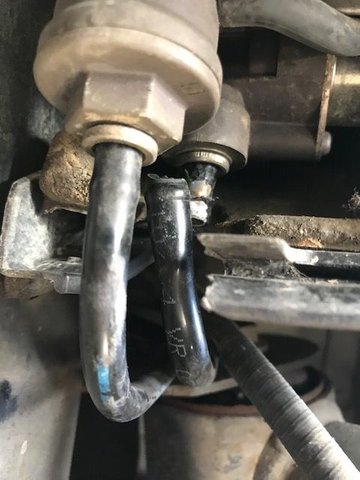

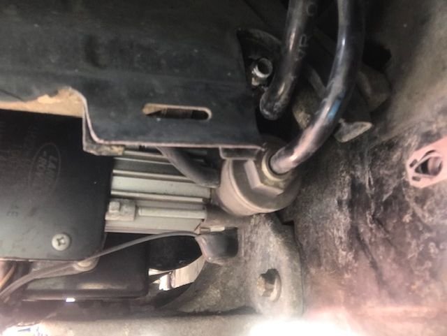

it just gets better, the compressor must have heater up and melted the air hose out the back and the smaller hose with the orange fittings that goes from the pump to the desecant canister. It was melted into the pump fitting. i need to continue picking out the melted plastic out of the inlets. Probably time for a new/used pump. Removal of the pump was a challenge, the top bolt on the pump was really tough to access. I ended up using a spanner and turned the bolt about an 1/8 turn at a time. on the bright side, I probably won't need two new rear shocks.

question, should I get the AMK style compressor or keep the hitachi and swap the desecant canister from the burnt one and put it on my old one. A used AMK or Hitachi run from $150 to $300 on car-part.com, used parts from wrecks. The Arnott AMK style compressor is around $600. I will have to trim the larger hose out of the back and refit the push-in fitting. Not looking forward to reinstalling the Hitachi compressor, it seems lke the AMK installs easier. Thoughts? Thanks Phil

Your compressor temperature sensor may have failed. The compressors do get hot enough to fuse in the exhaust line but typically not to melt it. A software update lowered the max operating temperature. I have need seem the smaller line get fused.
I see no reason to go AMK, there is zero advantage. Im not sure the dryers are swappable anyway. And you would need a new housing shell since they are not compatible. Also dont forget you need a software update to run the AMK. So I just dont see the need or reason to swap. I would be wary of a used compressor, while the cheap eBay ones may only last a year I would rather go that route for $150. My neighbor installed one and he did have some odd issues, turns out the new cheap eBay compressor has a bad temperature sensor so it would always want to cool down. We put one in from a factory parts compressor (always nice to hand onto old things). But it works fine, its quiet and it was cheap.
For the top bolt, honestly you could probably not even install it. But I use a small 1/4" drive and socket with a swivel and a nice long extension. From below you sorta work it in and up and over the compressor. Once you figure it out its pretty easy but always annoying.

Oh, you may need the compressor conversion kit thing. Its not cheap for what it is, but its a set of tubes and fittings for swapping compressor brands. But it also works as a repair kit to take care of that melted hose you have.
