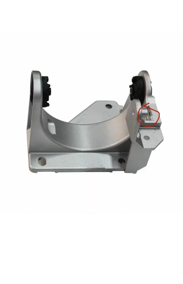

I decided to replace the entire EAS compressor with a Dunlop unit. There was already a Dunlop compressor fitted, but I do not know its age. Cost and suspension issues considered, I opted for the entire unit. The new compressor is only slightly quieter. I suspect the clam shell cover not being fully closed is partially to blame. The tabs do not meet and there is no bottom bolt fitted to the lower portion of the cover. I now have a vibration through the floor when the compressor runs. Notably, there are two issues with the mounting bracket. First, the upper bolt is not fitted. It was missing when I removed the bracket and I was unable to attach a new bolt in that spot, so the bracket is held on by only the two bottom bolts. Secondly, the bolt that passes through a rubber damper at the end of the compressor motor had to be cut out and the captive end (the circled part on the picture,
) was cut off, so there is now a nut, bolt and a series of washers in its place. Could this be affecting the vibration dampening? Also, with the two side bolts securing the compressor to the bracket, the compressor swings freely inside the bracket. I assume this is correct operation.

1 - I am missing upper bolt on the bracket too, just a paint to get to without some magical assortment of swivels. If the lower two are snug, I don't think there will be an issue. The covers though need to be snug, so if loose that will cause some noise. I don't have the lower bolt either, but unless the cover is in direct contact with the bracket there it is probably not a noise issue. I will say that new covers that have nice new foam are quieter than old beat up ones where the fog is saturated with grime and lost its acoustic properties.The actual compressor mounts would probably affect noise too, three of them. Not sure if the compressor came with new ones. Some do, some don't.
If you have a leak that big, you likely can hear it. And it wold have to be after the valve block since, in theory, the valve block is sealed when not in use. So it could be a line attachment point to eh block, a damaged line or the strut. Pump it up, turn off the truck and try bouncing the front end. Listen for leaks. The struts typically leak at the very top.
