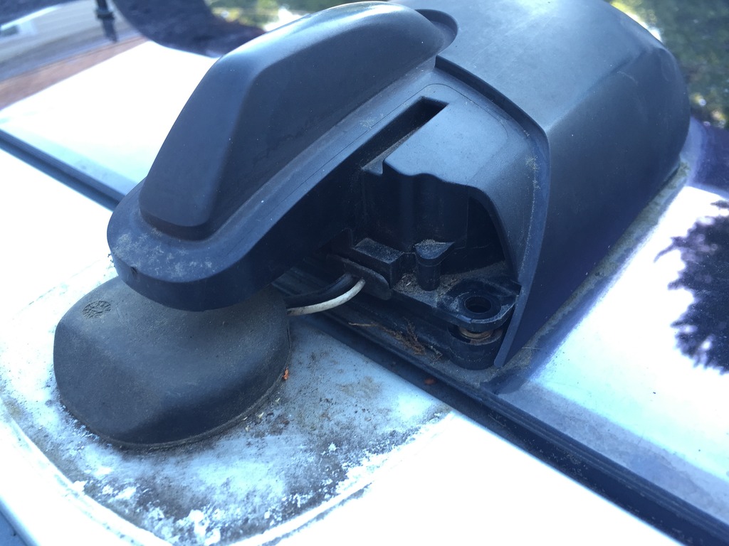

Last night I pulled the fin off the roof and cracked open the trim in the rear to expose the wiring from the antenna and I found the possible issue, and thus my question.
My antenna does in fact have 2 wires running from it, but only 1 wire terminates inside the vehicle and is connected to the Sirius tuner.
Roof fin - 2 wires
And only the white wire coming from above in to the vehicle - this plugs in to the tuner module.
Any of you go this deep before? Am I missing a connection or did the later models do away with the 2 antenna input design? The tuner module only has one antenna input, but I’m not sure about earlier models. I know some parts on the later 08’s and 09’s were in fact the same as from LR4 - my Bluetooth module for example.
Thanks for any input.

Even the factory wiring diagram shows 2 inputs to the satellite module.
Ugh - my module only has one antenna inout.

FWIW, I drove my 2006 LR3 with Sirius for 5 years and the connection was always ****. I thought it may just have been my truck, but I get the same dropouts in my 2007 Full Size Range Rover as well. I think they just use a weak antenna. I get dropouts when going under a bridge for less than a second and I get dropouts on real foggy and cloudy days.

Yeah, I'm afraid of that... Sucks. I'm still wondering about the dual antennas - it that was the original design but they cheaped out in the end. If you ever pull one or the interior panel again, I'd be curious to know if you see 2 wires leading in...
