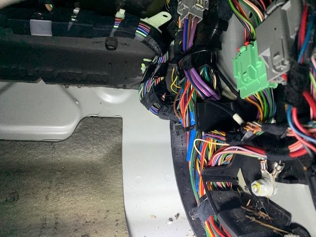

Earlier this year, I had the windshield replaced I got them to close up and seal the A pillar issues. I've just discovered another leak in the passenger footwell. WTF... I thought I had this problem solved...
I have not replaced the sunroof drain boots - I cut them open as recommended - they didn't seem blocked or perished. I really hope I don't have to replace this as that fuse box is a PIA.
I am wondering if it's the cowl. However, my cabin filter is still dry.
Here's a pic. You can see the drips and the areas of wetness. The tape on the first bundle centre right is wet.
I decided to run a hose from above so it drained down the sunroof and over the windshield/cowl.
I was thinking of taping the cowl shut then taping the sunroof closed pro temp. Doing one then the other and see which still leaks.
Any thoughts?

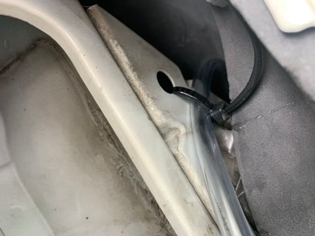

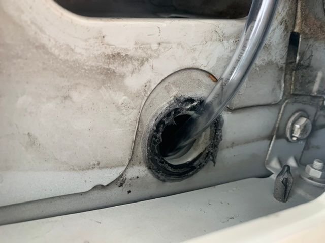

Took the offensive with this. Initially I taped the sunroof up so it would buy me some time so could get the drain ordered and replaced. The thought of dealing with this and then the junction box filled me with dread. So I was determined to find another way.
I had some poly tubing lying around and thought I may be able to do something with this. What about running it somewhere else and having it drain another place other than behind the box.
so I looked for an exit.
I found one in a blank cover next to the original location. It’s a plastic plug that is siliconed there. I drilled a hole in it to run my tube.
from the inside I removed the a pillar cover and was going to run a completely new line to the sunroof drain. Instead I pushed the drain elbow ( the one that rots) back through and then pulled the existing tube from above. The end must have come off at source as I was left with just the rubber tube.
I pulled the tube out slightly and redirected it to just behind the glove box. I then attached the poly tube ( it fit in) and secured with a zip tie. Then I fed the new tube out thought the blank and zip tied into the fender.
I then used JB weld to seal the plug and around The new pipe.
lets hope it works- the last thing I wanted to do is mess with the junction box....
sorry. Pics are sideways. Not sure how to fix that yet.
