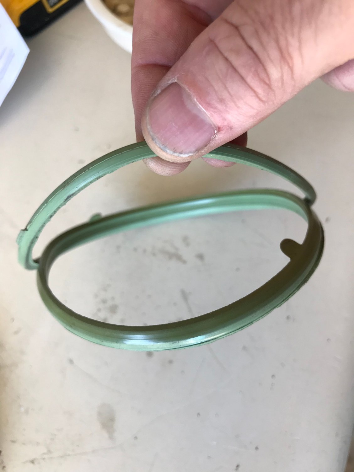

So book says 2.3 hours. A friend and I did it in just under 2 without hurrying, including vacuuming and cleaning the top of the tank really well. I drove the car until the computer said 5 miles remaining to make the tank as light as possible. The truck had sat overnight and this morning, I started the truck to move it about five feet. I ran a total of 15 seconds. Maybe some was from the day before. Either way I was surprised by the amount of fuel on top of the tank. When we dropped the tank, there was about 1/4 cup of fresh gas on the cover and in the low spot of the tank. Losing a lot of fuel in a short time. Amazing it didn’t burn to the ground yesterday to be honest.
Easy to do, especially with 4 hands. A couple of the quick disconnects took some effort. Especially one inside the tank. It seems to be the gas pickup. TomRs pictures in the sticky helped a lot. Thanks Tom!
I had the older tank and was fortunate the dealer had it in stock. I was able to remove it (slid it out the right side) while in off road height plus 25mm from GAP tool. No jack needed for the vehicle. Did use the jack to support the tank during install.
Seal seems to be poorly designed and split nearly half way around along a crease. Seems to be sheared as opposed to deteriorated. Maybe the tank expands with heat at a different rate as the plastic cover
Old seal was $78, new design was $19 and a simple o ring. Not interchangeable. New cover is very different. Includes a filter
Note, I broke the quick disconnect on the cover, it was being a pain and was getting replaced anyway.
Otherwise, I couldn’t see any cracks in the plastic. If you were to do this, I would just buy the seal. Dealer wanted to sell it only as a kit.
