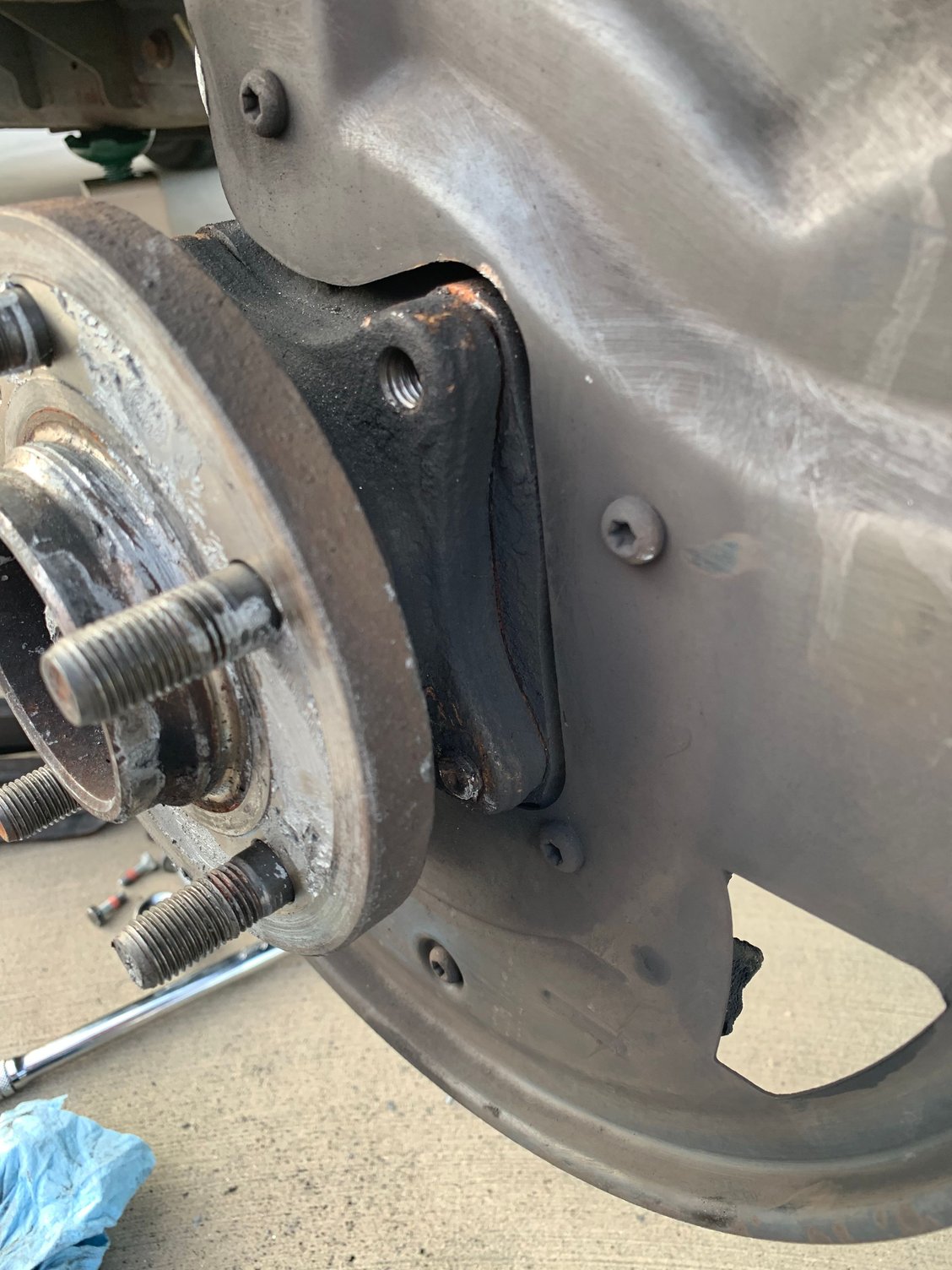

Changing the wheel hub and sheared a bolt during removal of the old hub. Curious if the steering knuckle is threaded at this point (where it bolts to the hub) or not. (Web search was inconclusive). If not threaded, the old hub should wiggle off with the remaining bolts out. Pic attached to show what I’m talking about.
Bottom bolt sheared during removal

I don’t believe that the mount has threads in it just the hub. I am not 100% positive as it’s been awhile.

I am on the other side, I seem to recall it is threaded, but again, I can't be 100% sure.
I would suggest you take out the other bolts and see if they are - Im pretty sure they are all the same.

I removed the other three for the hub, and the bolts are threaded there, but they are on the caliper bracket mounting base, too. Yet the knuckle is not threaded there for the caliper bracket.
I can’t tell at the site of the other three for the hub.

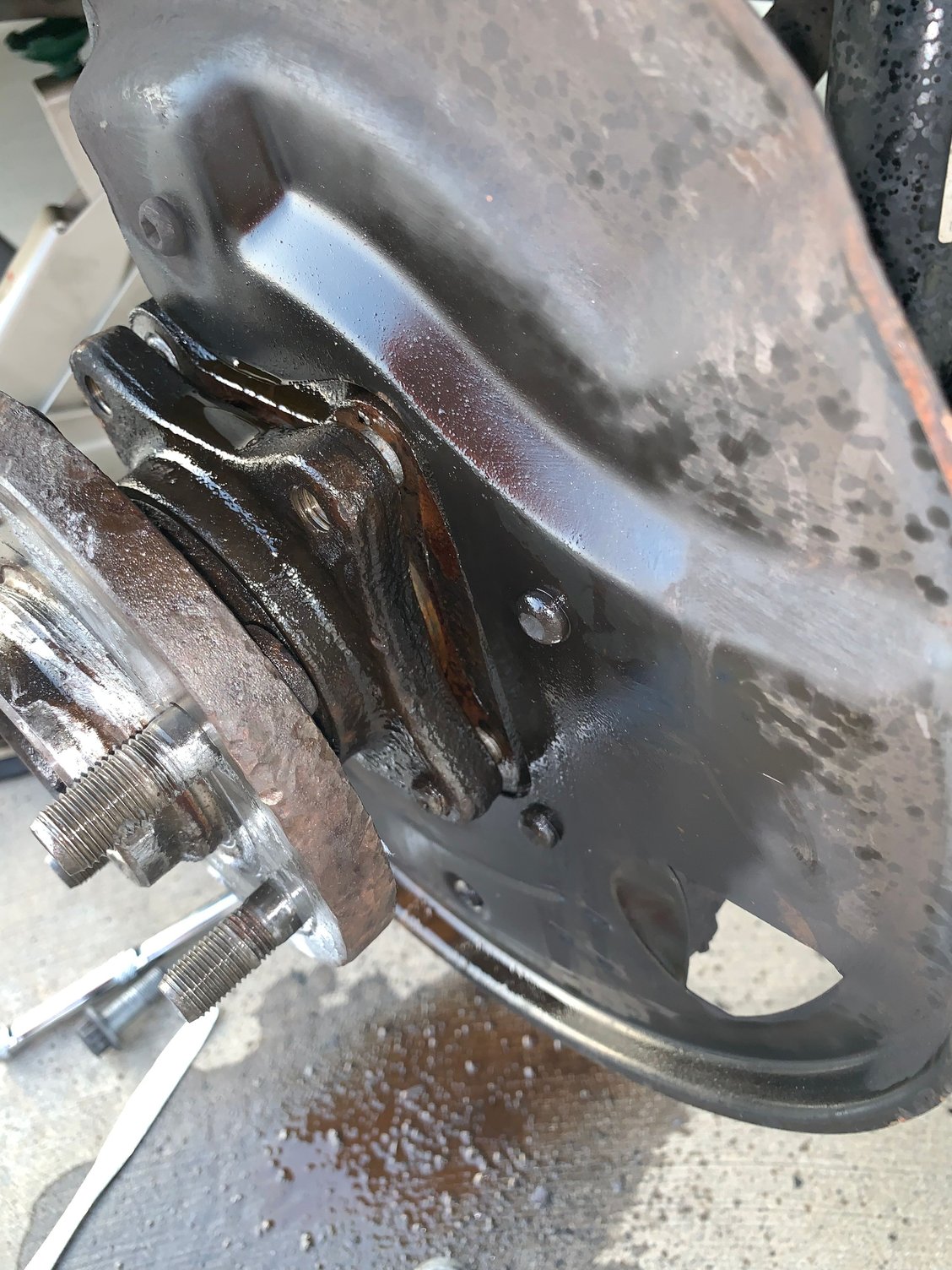

Update guys. It appears to be not threaded. Whew!
Top looks like no threading. Bottom has a gap now, meaning the sheared bolt is moving freely in the knuckle.
