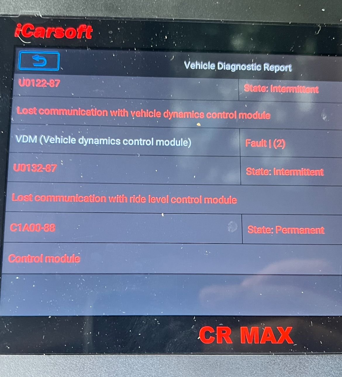

I dug out my iCarSoft CR Max reader and pulled a bunch of faults.
There was one area that caught my eye…
RLM (Ride Level Control Module) and it had two faults. Please see attached picture.
Lost connection with module errors U0132-87 and CA100-88
Now, a while back I had replaced the drain tube in the drivers side footwell area and was mucking around in that area. I know that the module is under that area as well, albeit, raised and oddly positioned.
I may have accidentally loosened a connector / wire in the vicinity when working in there.
There was no hissing or leaks in the wheel wells with soapy water on the lines. I have yet to check the blocks and lines at the compressor.
I will investigate and report back.

The compressor has a 30 amp fuse I think. No way it's just 5 amp. You may have pulled the fuse for the air ride computer but in my truck that is 10amp.
Lost communication faults are nothing to worry about and mean little usually.
So its interesting it shut off with that small fuse though. That tend to imply the main wiring for the compressor is not shorting out and that the relay, as you tested, is fine too. Meaning that for some reason the air ride ECU is in fact commanding it to run. Or its shorting the relay causing it to run. Check those connectors as you plan.
