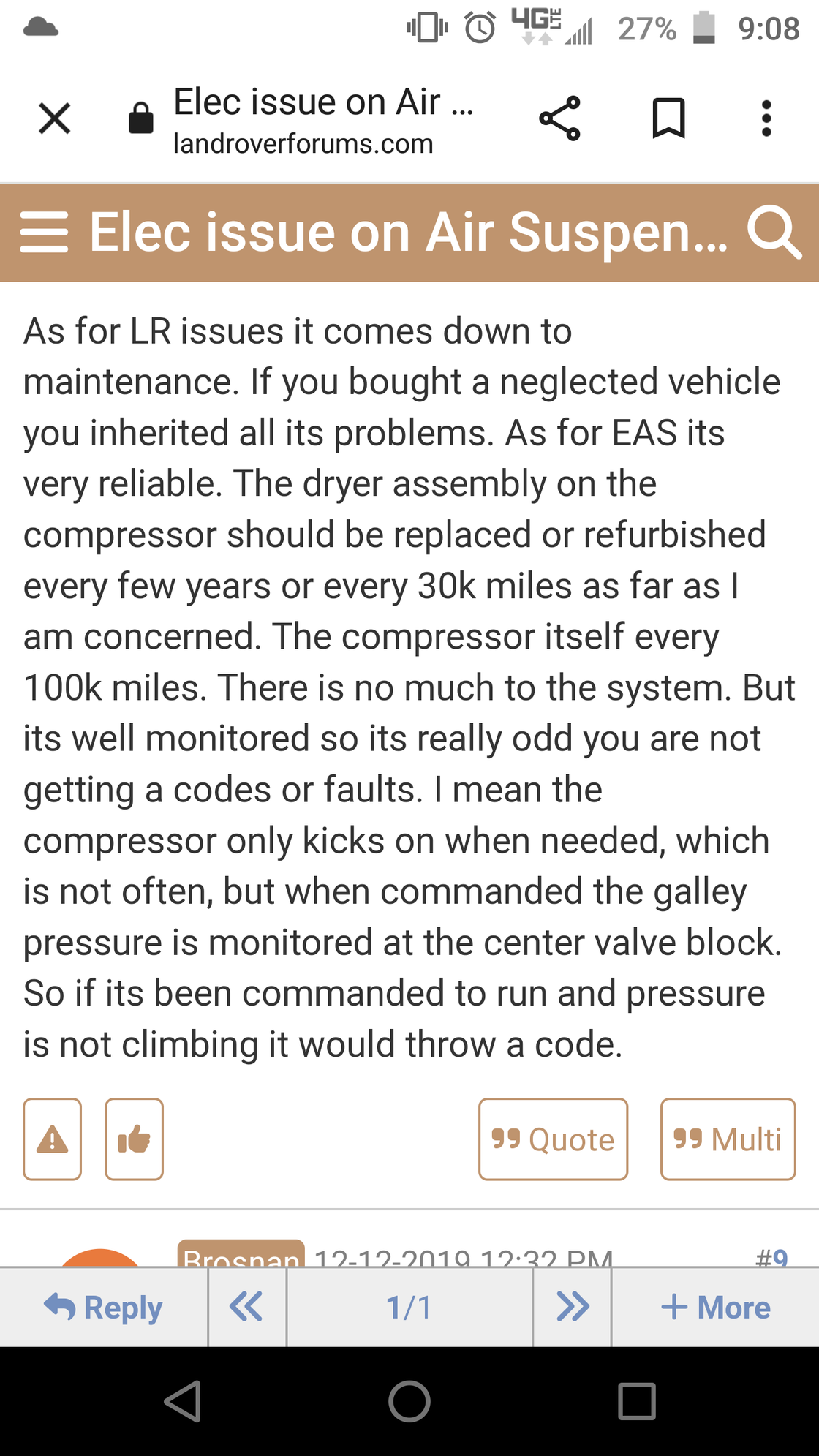

On another forum post a guy describes the Drier of Compressor failing causing the problem.
There is a kit sold by Lucky8 to repair Drier..there is a new Drier at Atlantic British but I bought a new compressor Hitachi OEM instead.We depend on this car and can't afford to compromise on it.
An OEM Compressor and Relay was at reasonable price at British Parts of Utah and at Autohaus.
This is the post.
