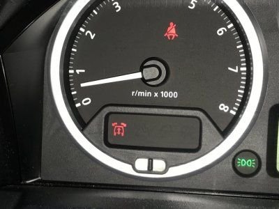

Th
is is the only thing that is illuminated “solid red”

okay yeah that's RED. You likely have a calibration issue. Even when my compressors have gone **** in the past, I don't recall a red icon.

So what is your suggestion? I figured it was something that can be fixed through a diagnostic tool. Take it to a dealership for the calibration, or buy a diagnostic tool to calibrate it myself? At the moment it does nothing. Doesn’t kick on, doesn’t inflate, just the suspension fault and vehicle sits really low.

This seems like a vehicle on its bump stops with suspension height rods installed on the sensors. Have you modified the vehicle height in any way?
If you are getting a full hard fault as mentioned, you have sensors that are way off/disconnected or you are simply missing a fuse/relay for the compressor or the suspension computer. Those are generally the only two states that will trigger an immediate hard fault.

Did not pull any fuses. I just disconnected the battery when I replaced the starter and left it disconnected over night after it was replaced successfully. I do have the rhino rods that extend the height of the vehicle.
Would I need to reinstall the stock rods to have it read the correct height on the sensors?

There ya go. Install the stock rods OR jack the vehicle up on all corners. You dont have to jack it up too high, just enough to get the sensors back online and back into range. Give it a try and report back here please.
