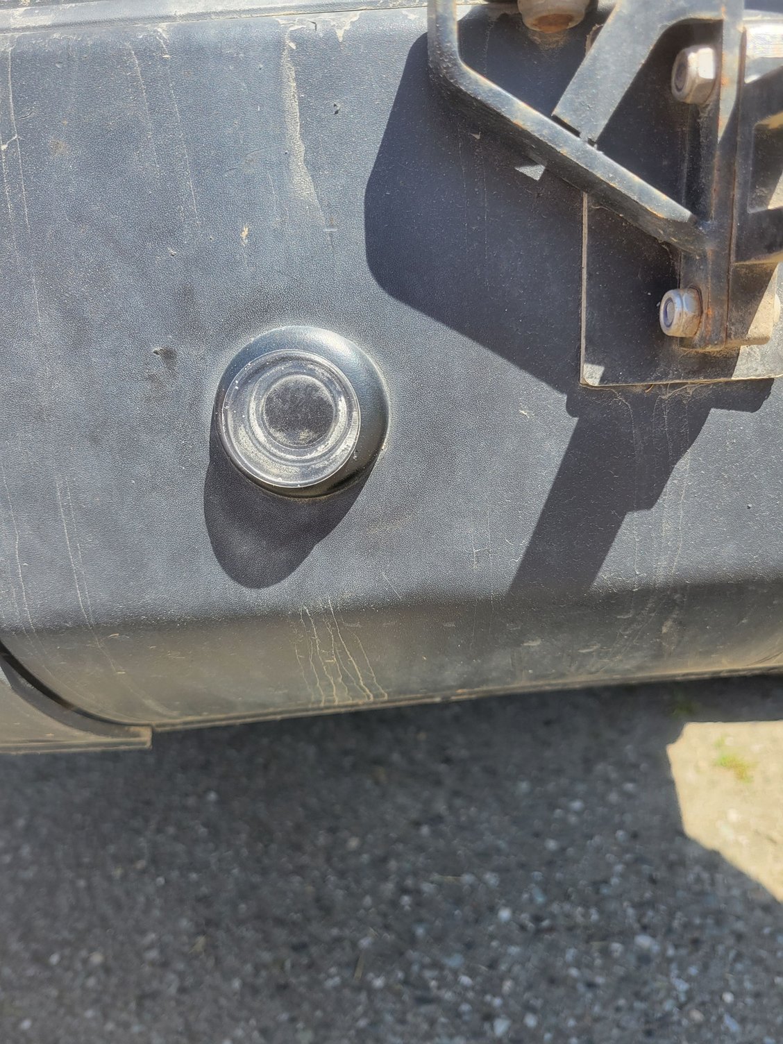

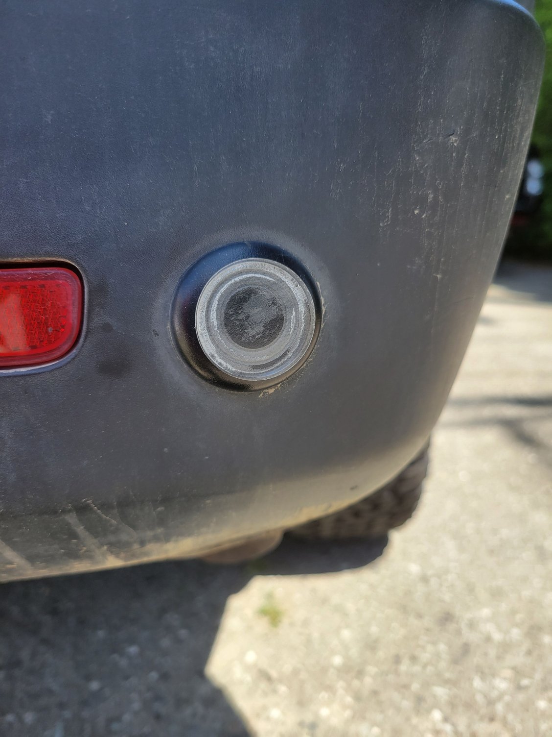

I added these clear plastic covers and I still get an alarm as soon as I go into reverse. Also alarms if the tire is swung to the side. Make take tire off to confirm that is the issue.

I found that electrical tape or a small round piece of rubber from a tire tube worked best. I tried a small plastic disk and it seemed to be "too reflective" for the sensor. Again, I found it best to deactivate the sensors and live with that fact that I cannot use them when the spare tire carrier is on.
That is why I added a rear camera.
