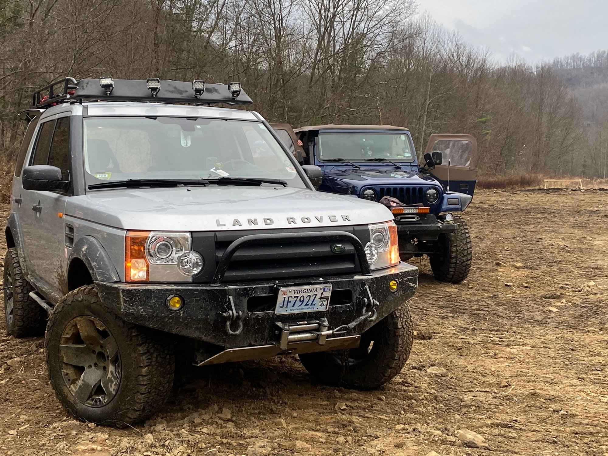

Just posted picture to give an example of the height I drive on.
Driving is usually highway driving with a some offroading nothing terribly challenging
Alignment was done in August.

I agree that your LR3 looks nice.
A few things I observe from the picture though, that may be relevant:
You have a steel bumper and winch. That is going to add some weight and maybe necessitate the higher suspension setting. That could play into the stress, again, on the tie-rods...not so much the weight since it's sprung, but the need for the taller suspension setting as a result. More importantly though, what is the offset on those rims? It looks to me, and I'm not sure, that your wheels are poking out of the wheel wells more than mine do when I run 275/65R18s. Do you have spacers installed or is that just due to the non-factory wheel offset? That could be your issue.

Thank you re Lookin gooood- :-)
Yea it is a lot heavier- I am going to swap out the metal wire for synthetic eventually. But it is quite heavy. Regarding the wheel offset, no, no spacers. they just fit right on the hub. I think it being up higher, added weight (just installed in sept winch/bumper), and off-roading it. Though i replaced them at least 2x before I installed the bumper/winch. I think i need to figure out how to do on my own- clearly this is a thing with this vehicle.

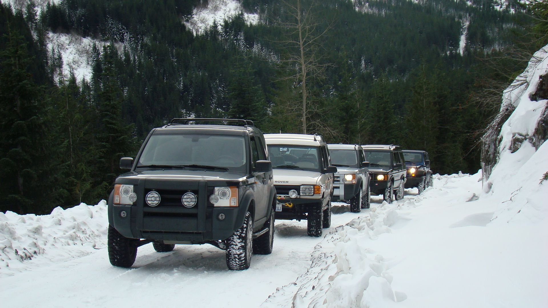

I tried to find a photo of mine at a similar (quartering forward) angle with the 275s mounted. This is the best I could do. While you are not running spacers as you said, your offset is for sure not factory, and maybe that is stressing your tie-rods. Those rims are pretty cool, but have you considered switching to LR 18s?
Looks like I managed to find a pic with TWO LR3s in fact. Mine is the black one. I think that the silver one is on 31.5" tires, but you can see that the wheels on both rigs are not poking out of the wheel wells.
