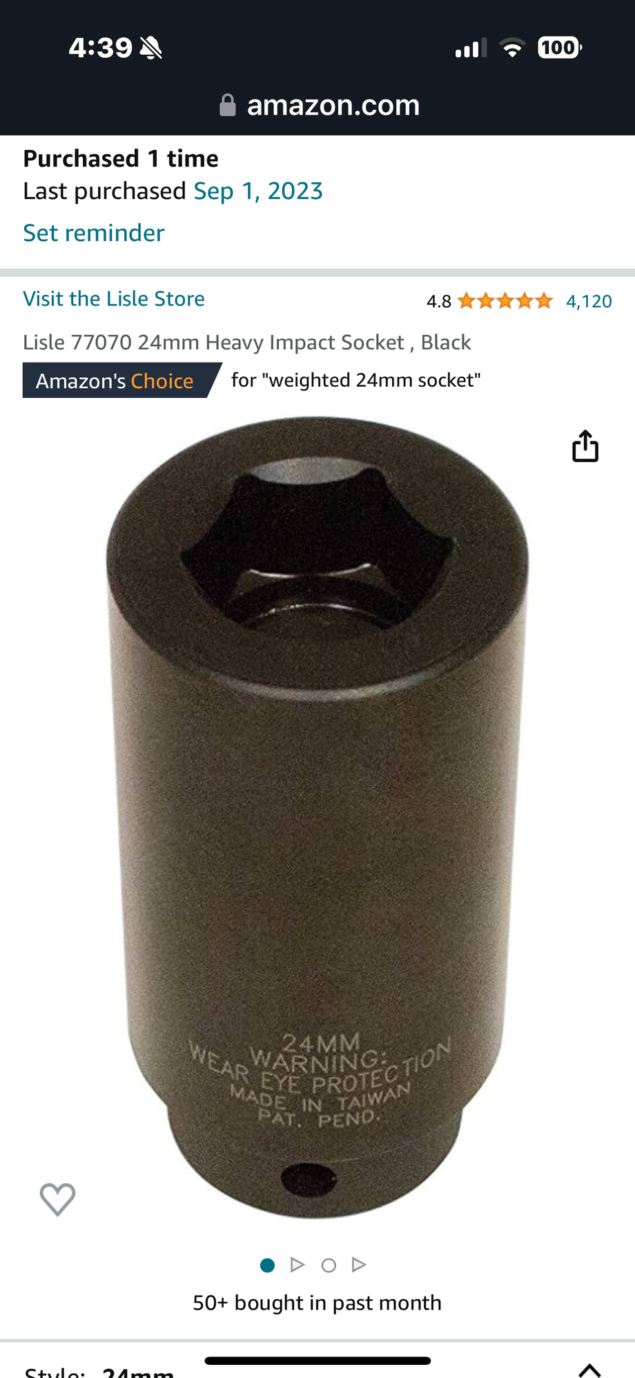

I'll also ask (while I'm here), suggestions on removing the crank pulley bolt. I hit it with the big air ratchet in reverse mode, but it just laughed at me. I don't really want to pay ridiculous prices for the crankshaft holding tool since I have not been able to find a reasonably priced one (they are all $100-$300. I have not yet tried the ratchet strap to the frame trick or the rope in cylinder 1tricks, but any advice on that would be appreciated.

These harmonic balancer sockets work great. They are extra thick so they transfer more power to the bolt.
Amazon Amazon

Originally Posted by bhardyva
Harbor Freight Earthquake XT 1200 ft-lb pneumatic 1/2 inch impact gun is what I used with a 24mm 1/2 impact socket. Bolt didn't even try to come loose.
trust me, the thick harmonic balancer socket transfers the force to the bolt. It’s amazing. Buy it, I guarantee it will free the bolt. I’m serious.

its been on order for a couple days, lol.
there is the issue of space however. I didn't take out the radiator - at least not yet

Matco makes a stubby 1/2 impact that fits in between the radiator.
