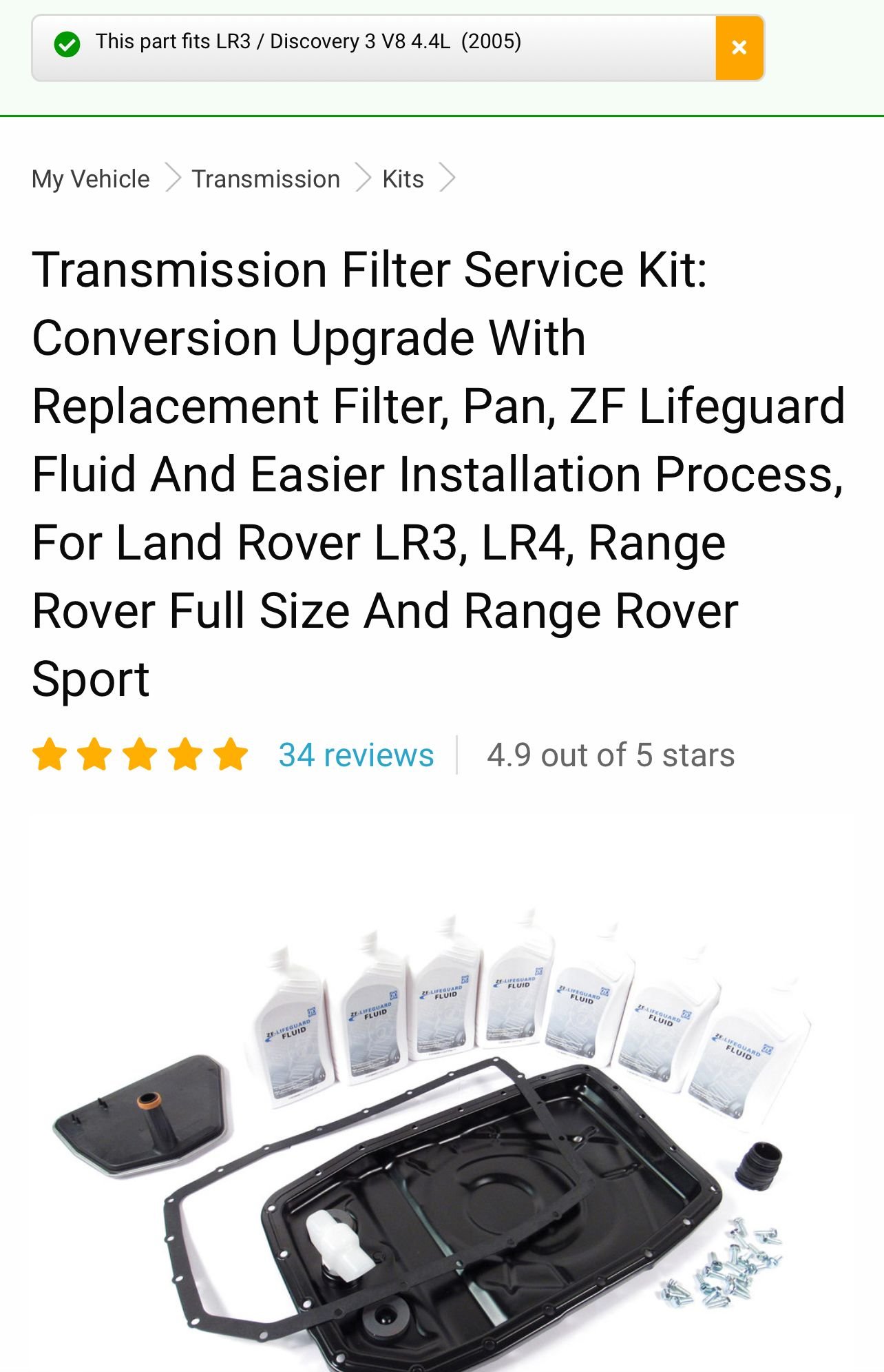

Hey Guys
so I recently had my local mechanic do the transmission filter conversion upgrade kit from Atlantic British. Installation was a bit of a pain but went ok. But now I’m getting transmission oil drip. Mechanic is saying that it’s from the sump pan gasket. He says that the bolts are tight but that the gasket is silicon and way too thin.
did anyone else have this problem and is there another thicker gasket I buy that works with the kit? Any advice on this?

Ok I’ll take pics and get back to you. Yes doesn’t make sense to me either. The gasket looks pretty sturdy. Not sure what his issue is.

I think cleaning the threads is just a precaution, but not a necessity. I have never done it and those I know personally and done conversions have not.

I did not clean out the bolt holes on either ZF6HP26 I did a filter change on. I did make sure to change to the shorter bolts, however.
Some of the kits come with a paper gasket, most of us upgraded to a metal gasket with silicone lip. It sounds like you have an upgraded gasket.
Definitely get more details on the leak location.
Did the mechatronix sleeve get replaced? Common leak point.

The mechanic said the kit came with a paper gasket, that it was really hard to place and that’s what the leak is from. From the kit photo, the gasket doesn’t look like paper. I ordered another gasket hoping it’s silicone.
what’s the meta gasket? I’ll do some searching on that.

Sorry, metal gasket, not meta.
I used Fel-Pro, PN: FEL TOS18753

I use the aluminum gaskets with the rubber edge also. Cheap and better than the paper. Call AB, but the product page does not mention the gasket type. All the kits I have seen come with paper type, which is why I bought a bunch of metal ones to keep in stock for conversions.
